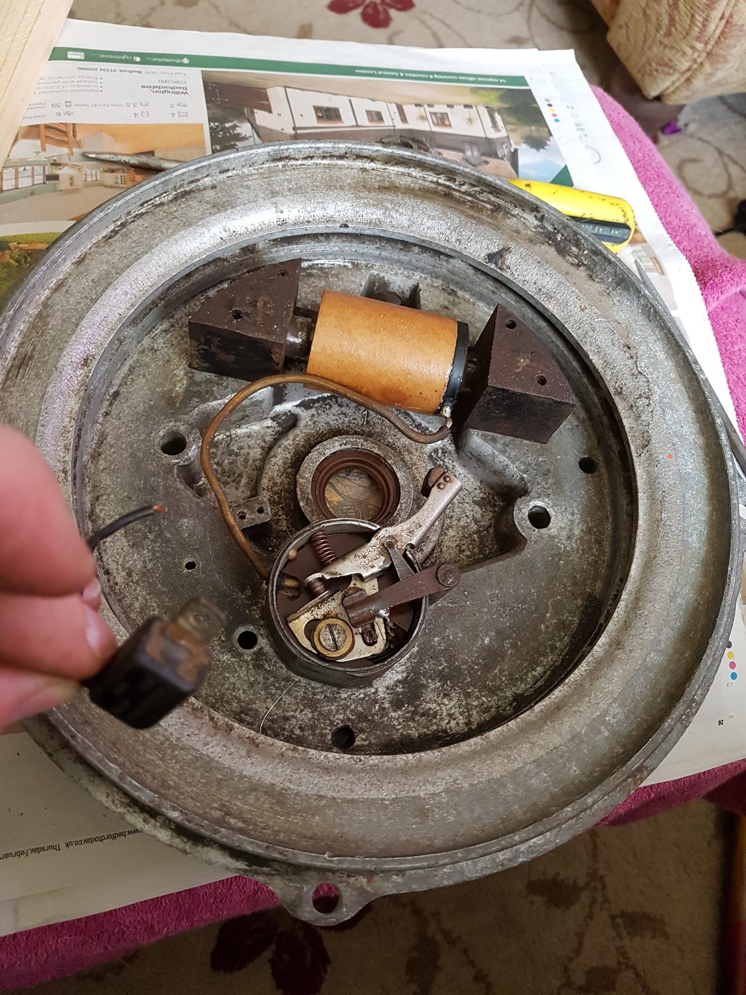

March 8, 2017 at 4:06 pm #24668
vhgmcbuddyMemberMarch 8, 2017 at 4:10 pm #24670
vhgmcbuddyMemberMarch 8, 2017 at 4:42 pm #24672andyfrost
ParticipantThat looks like an electronic module , ….throw it away. If John has overhauled your ignition , you should be away in no time , I take it that he has fitted new coil and condenser.
March 9, 2017 at 12:11 am #24673
vhgmcbuddyMemberThe coil tested OK, the condenser had failed. John fitted a new one with a new L/T lead and cleaned the points. The coil is one of those cheap chinese jobs which i will be replacing for the correct one i think. I also got a new ht lead which was an absolute git to screw onto the Armature Plate , but i managed to get it screwed in with a little help. I believe the threads on the plate are not in ideal condition,but its in now and i hope it doesnt need to come off anytime soon.

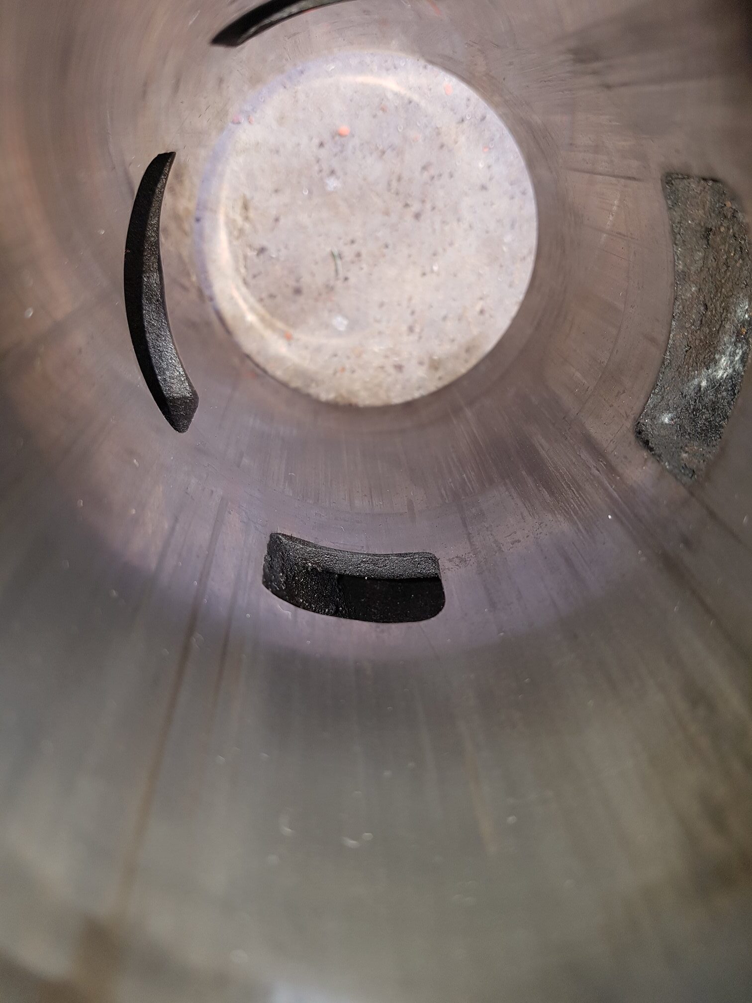

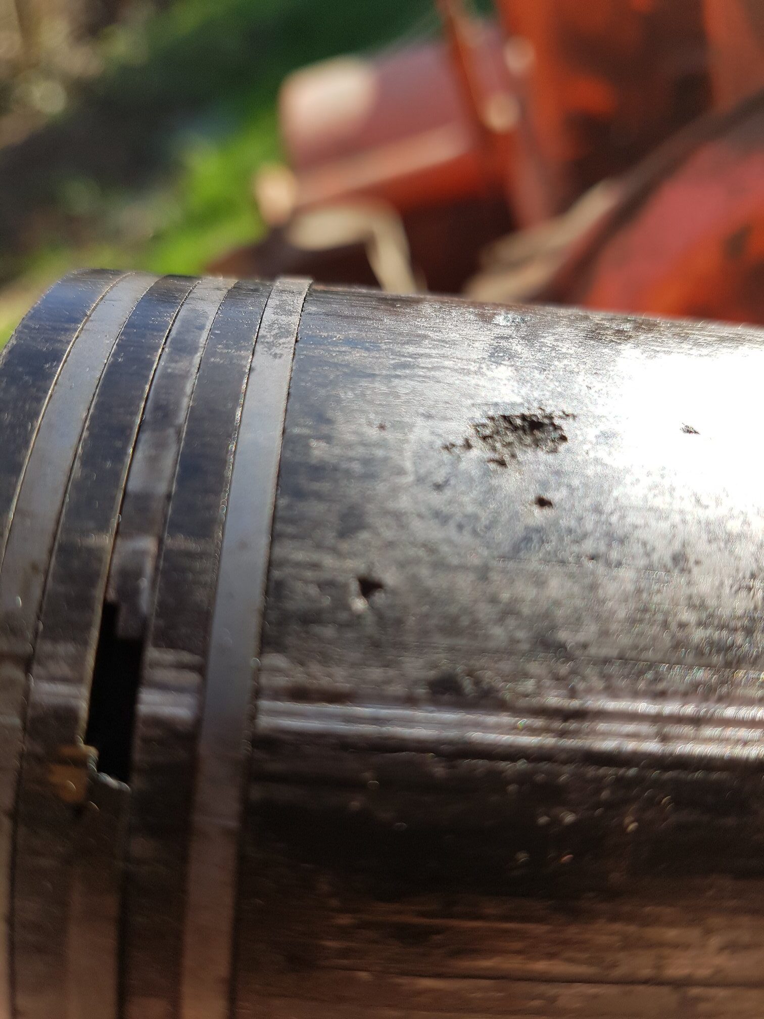

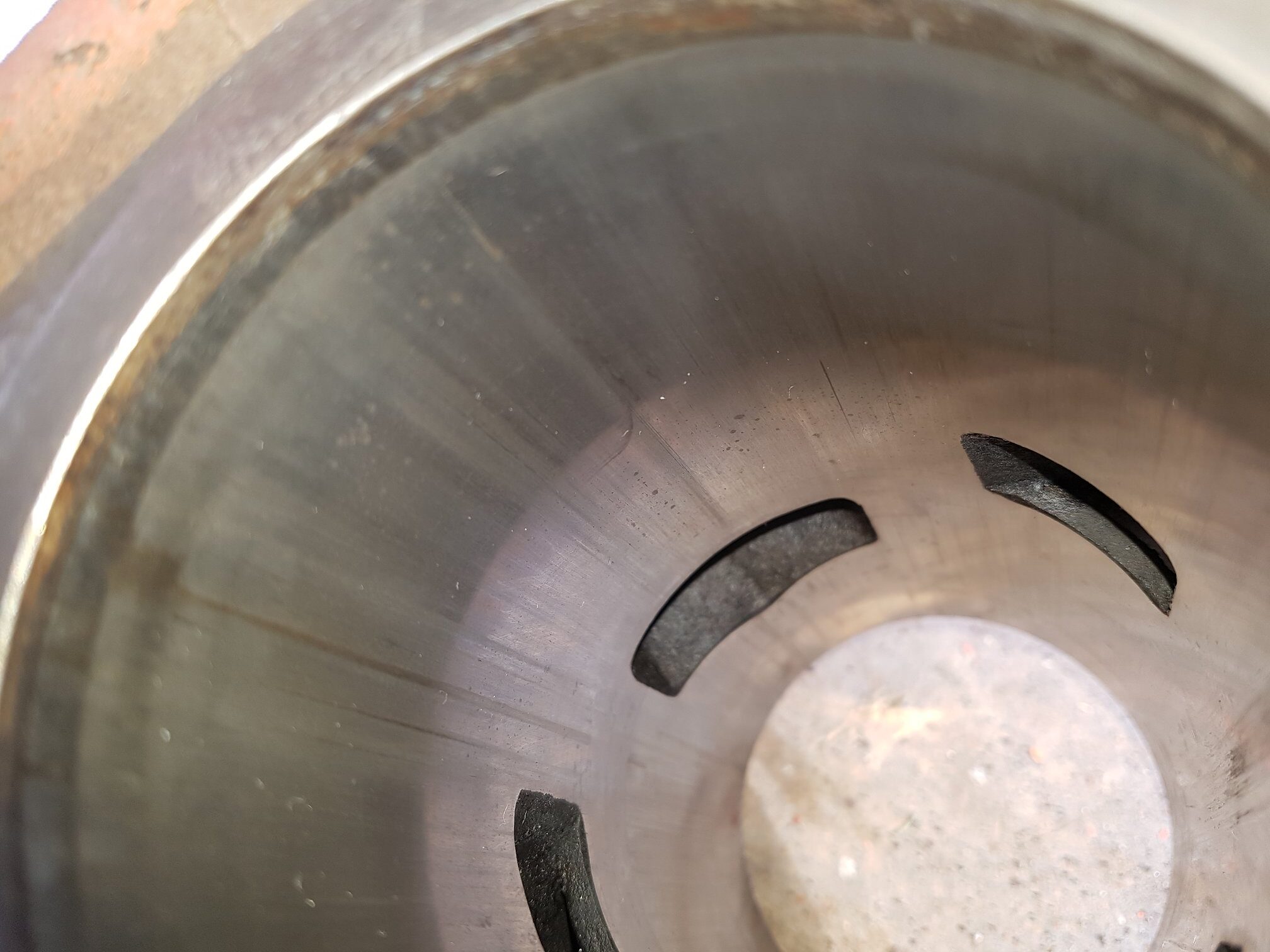

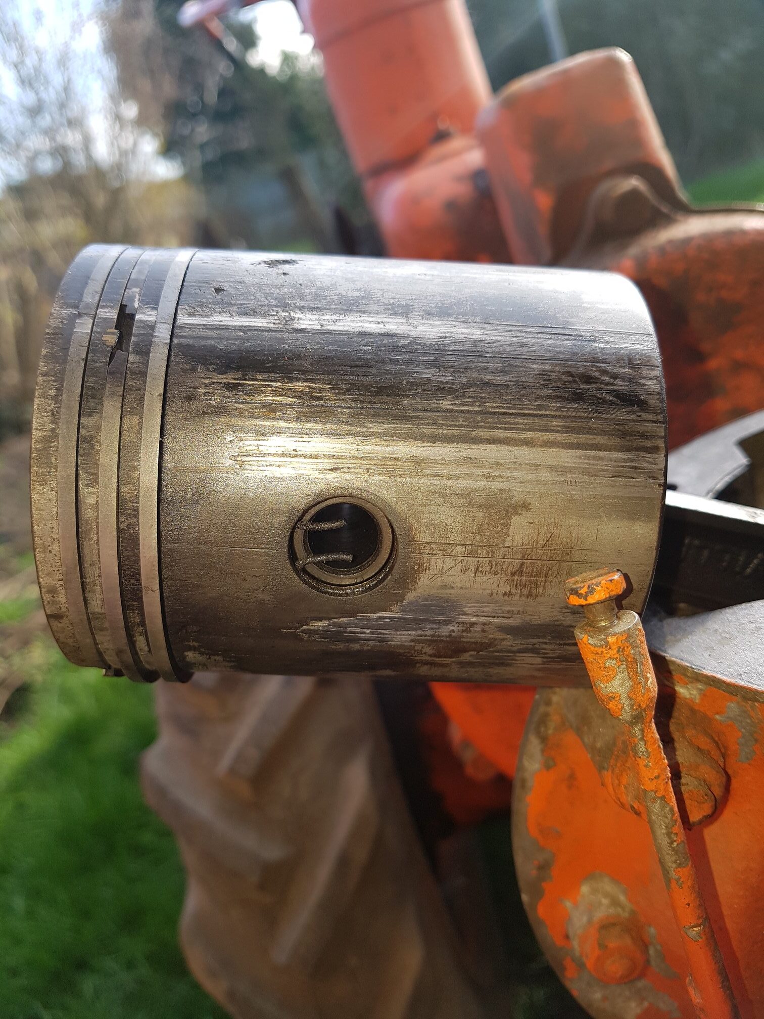

vhgmcbuddyMemberCheers m8 , im picking up some imperial feeler gauges later so im going to take the cylinder barrel off ready to measure the gap on the rings.
March 9, 2017 at 5:28 pm #24677
vhgmcbuddyMemberMarch 9, 2017 at 5:57 pm #24684andyfrost
ParticipantBarry , to be quite honest , judging from those pics , it’s hardly worth measuring , it looks to be in a rather sorry state.
March 9, 2017 at 7:20 pm #24686
vhgmcbuddyMemberWhat would you suggest my next move is m8 ?
March 9, 2017 at 7:39 pm #24687andyfrost
ParticipantAnother trip down here to get yourself another cylinder and piston. I did strip the engine down that we had on the bench , the piston had VERY minor scoring , but would easily clean up , I haven’t measured the ring gap , but will do when I get a few minutes to spare.
