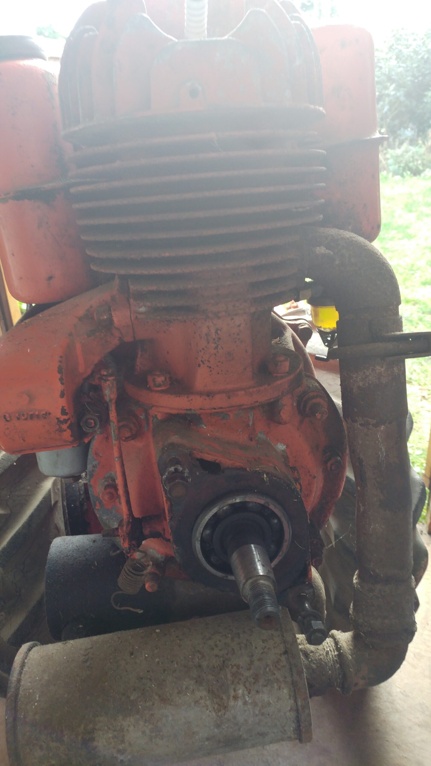

vhgmcbuddyMemberIve just purchassed a howard 700 and ive wanted one of these machines for quite a while. The problem is it needs some tlc and i have no clue where to buy spare parts etc.
Also i have no clue on the engine details , i cant find anything anywhere on the machine with any info either. So any help would be appreciated and i forgot to mention it is a petrol opperated machine.December 9, 2016 at 2:54 pm #23506

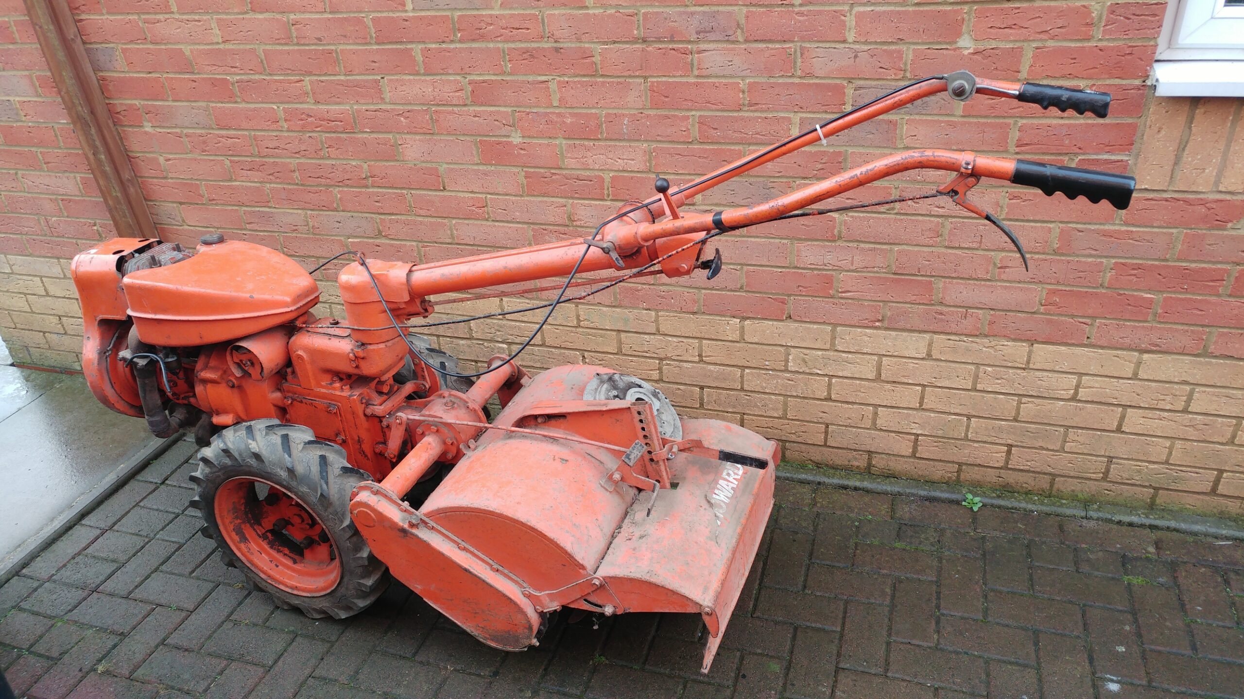

ParticipantCongratulations , the 700 is a superb piece of kit, and yours appears to be a fairly straight example. The Engine is a Villiers Mk28b , 353cc twostroke. Unfortunately engine “internals” are EXTREMELY hard to source ,I’ve managed to accumulate a few over the years should I need any for my machine, most of the carb bits are just as rare , ignition wise , no problems.
Looking at yours it appears to have been tampered with to some degree , the cylinder head has been put on the wrong way round.
Let us know of your progress and what parts you think you may need.Andy

charlieKeymasterThat looks like the Villiers engine, a 28B 7hp two stroke according to 70 Years of Garden Machinery by Brian Bell. Meetens, amongst others, should be able to supply parts for the engine. I have always thought the 700 was the best machine made by Howard, very versatile. Good luck.

ParticipantRegarding the head being on wrong , I wouldn’t have thought it would have done any significant damage , just that it may have run a little hotter. Parts and instruction manuals are always available on that well known auction site , BUT, none that I have seen cover the butterfly carb that is fitted to the 700.

hortimanParticipantApart from the mentioned engine problems, the rest of the machine appears to be in excellent original condition, and fitted with the wider rotavator unit, which is not so common. Good luck with it. The 28B engine can be a bit ‘fussy’ if not tuned and timed correctly, the carb is prone air leaks which cause backfiring and spitting back through the carb. An excellent engine when running correctly with bags of power, but a bit thirsty when working hard. I have spent many hours behind one in work, but prefer the Diesel version, which is not a common machine now.

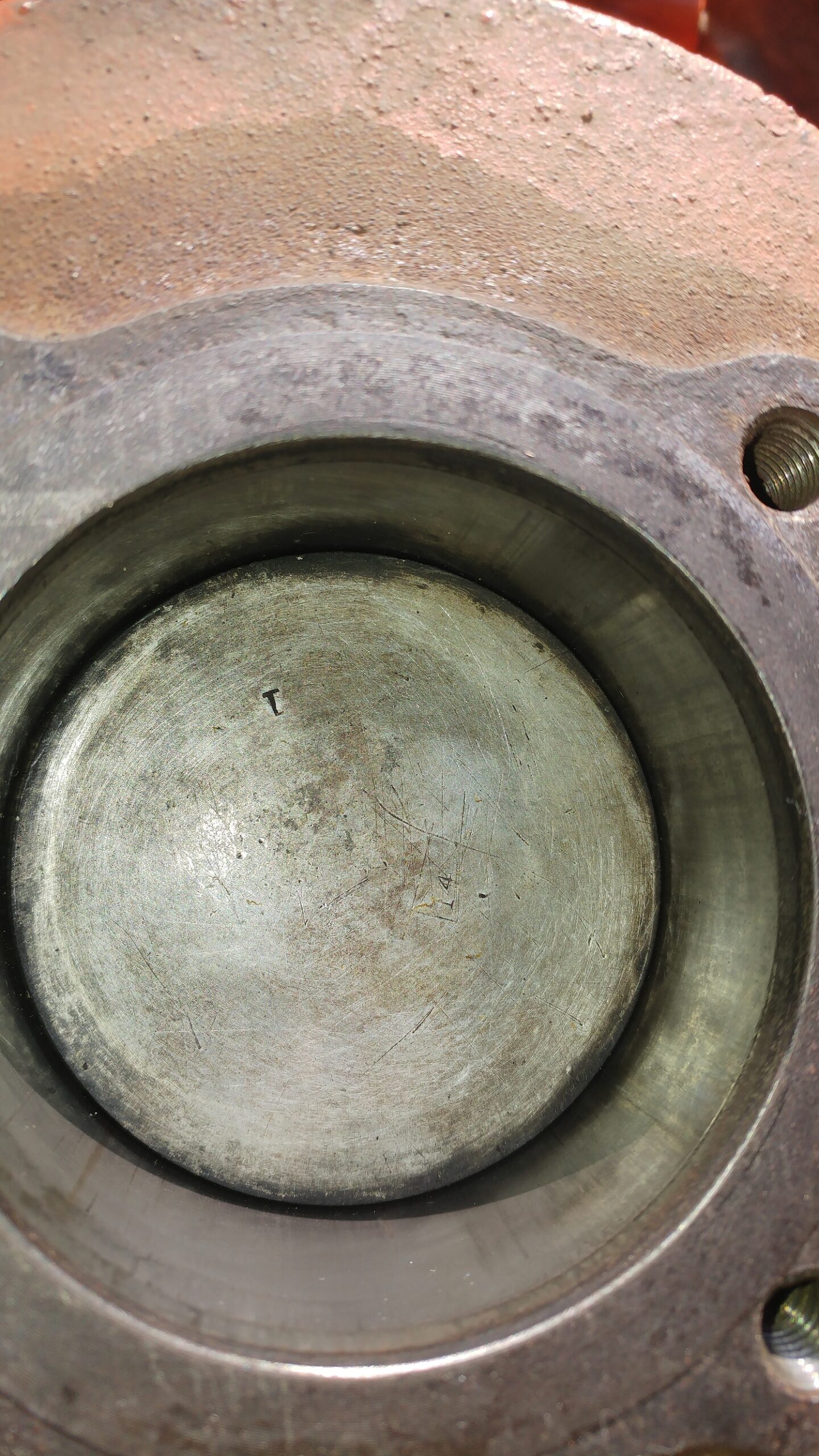

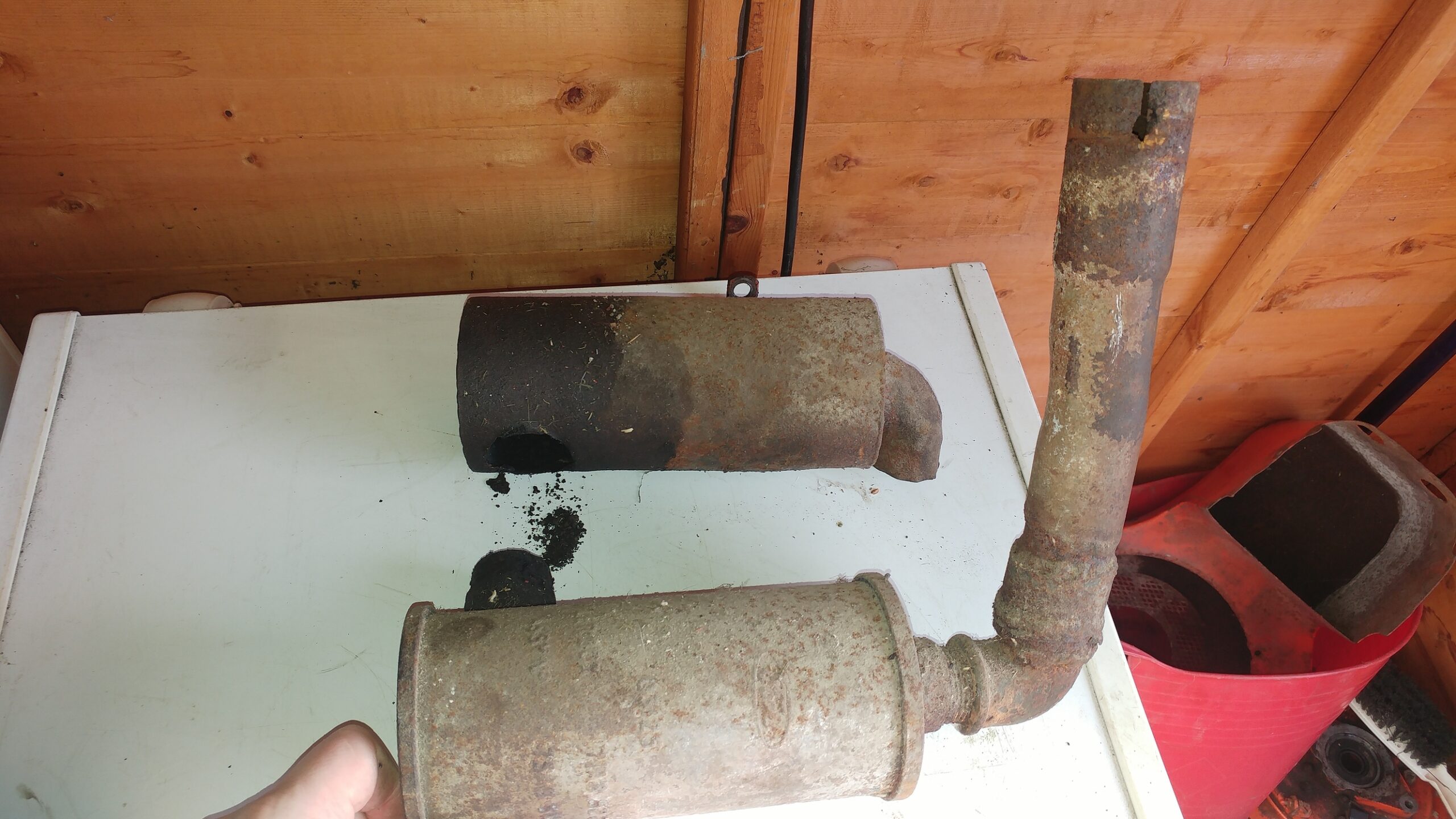

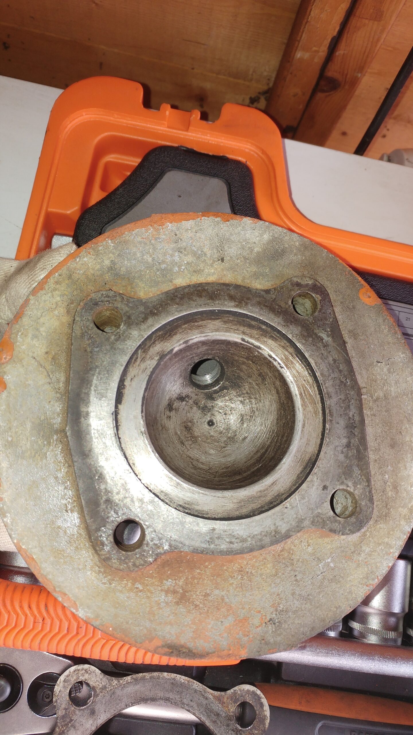

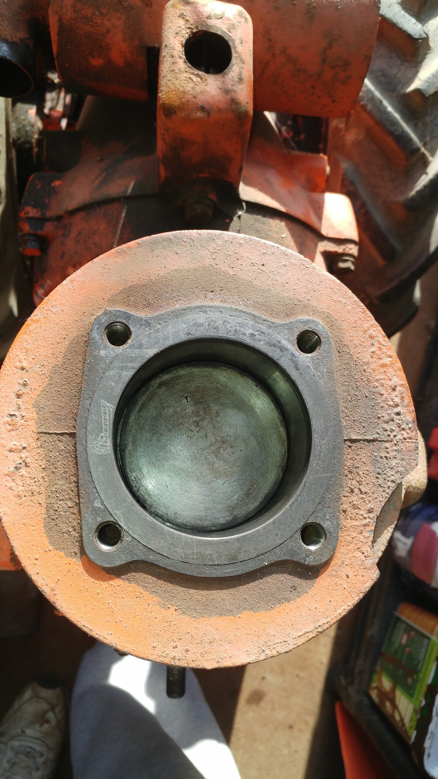

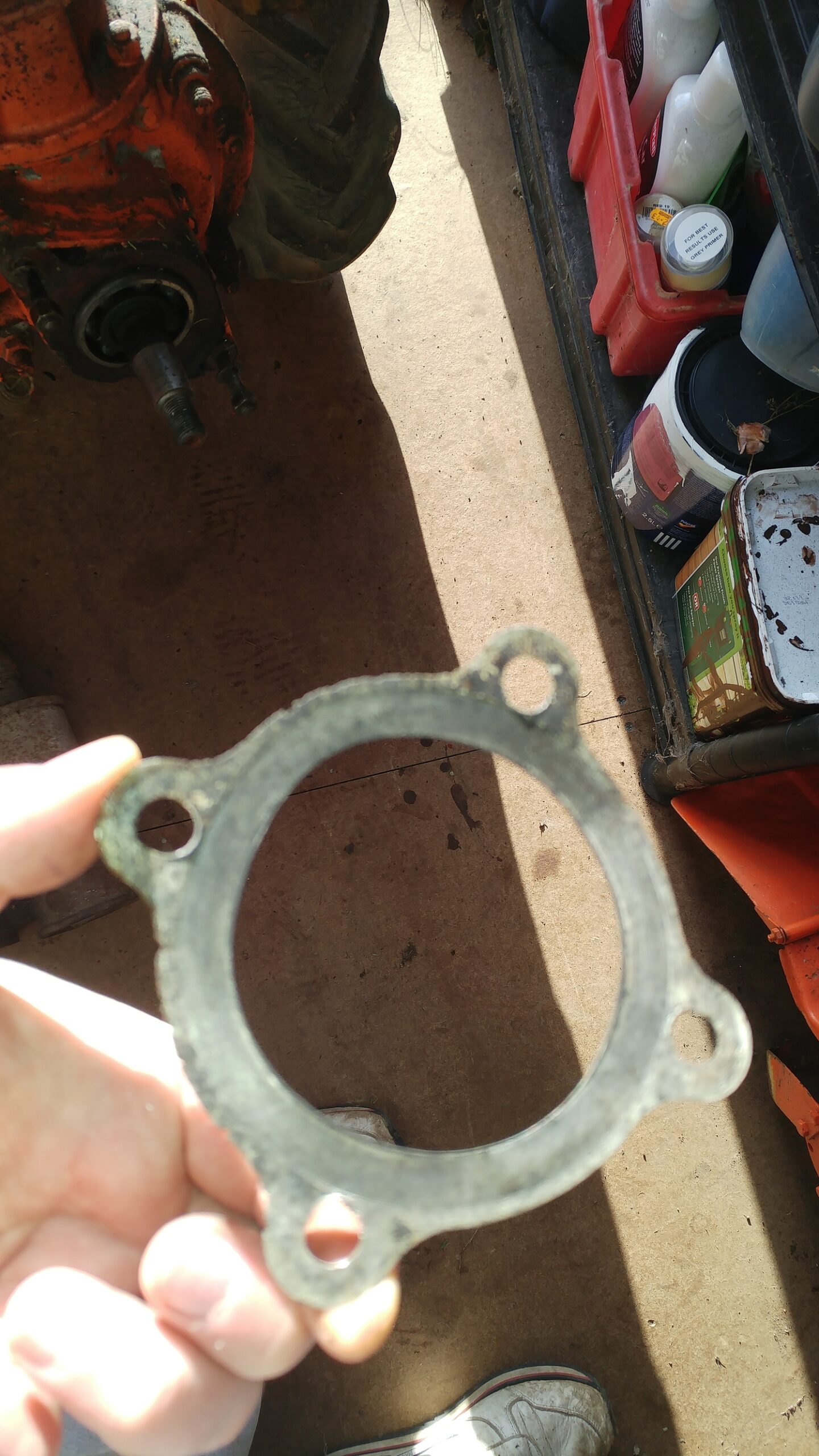

vhgmcbuddyMemberRemoved the cylinder head thismorning and put it back on the right way round . It all looked very clean which i trust is a good thing , i also removed the exhast which i hope can be re welded to join it back together as one air tight unit. That ill have to look into though as i know nothing about welding. I WILL NOW POST SOME PICTURES FOR YOU ALL TO GAZE YOURE EXPERT EYES OVER IF THATS OK.
