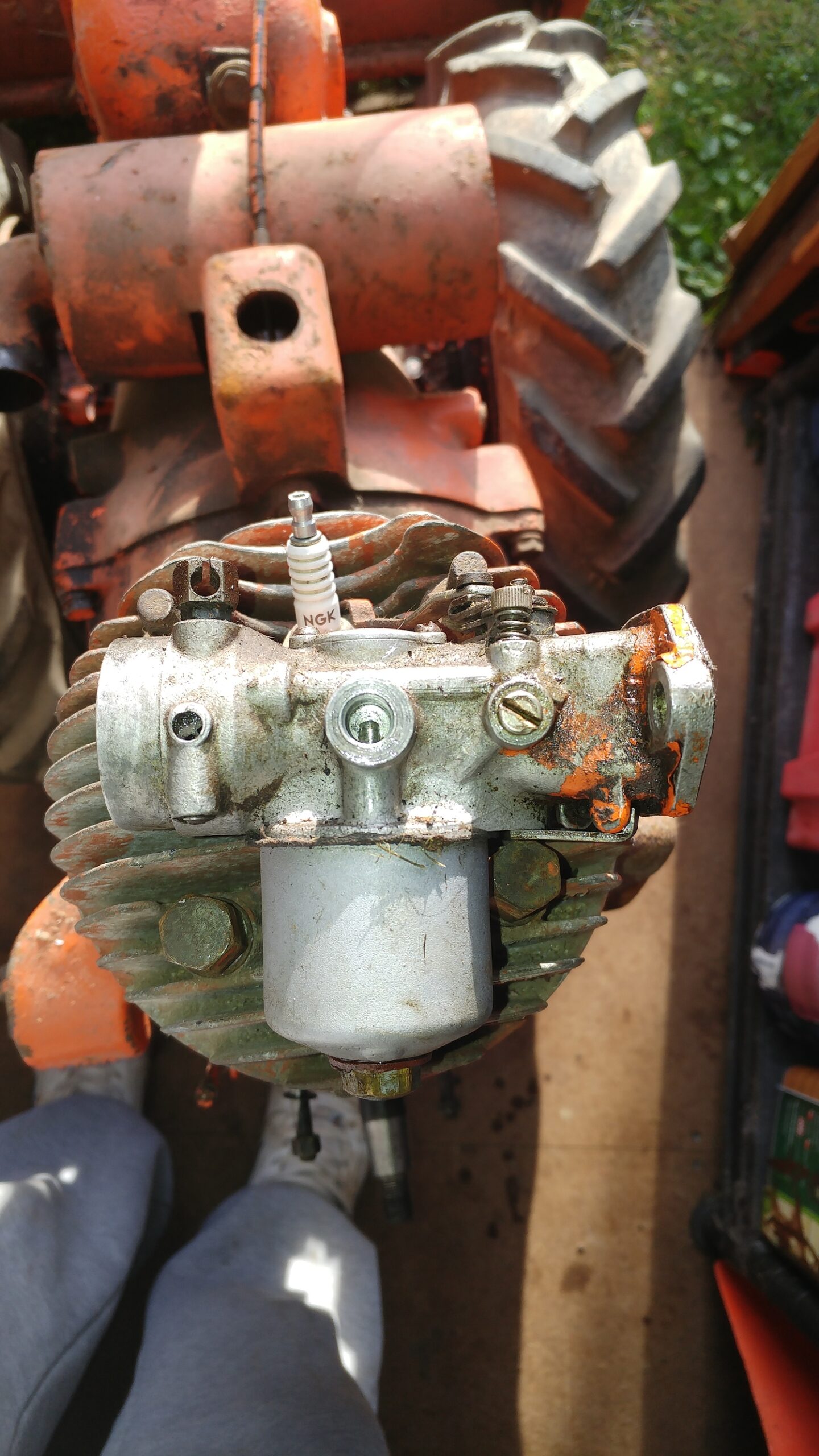

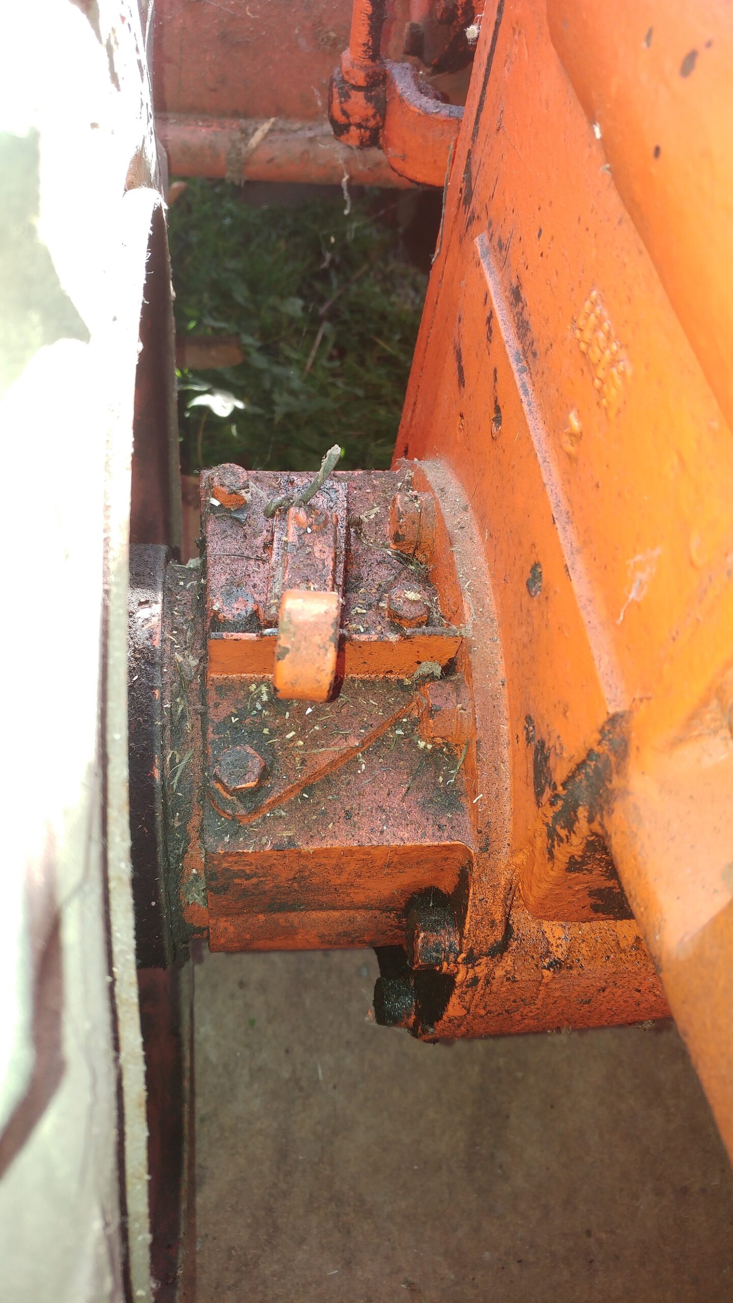

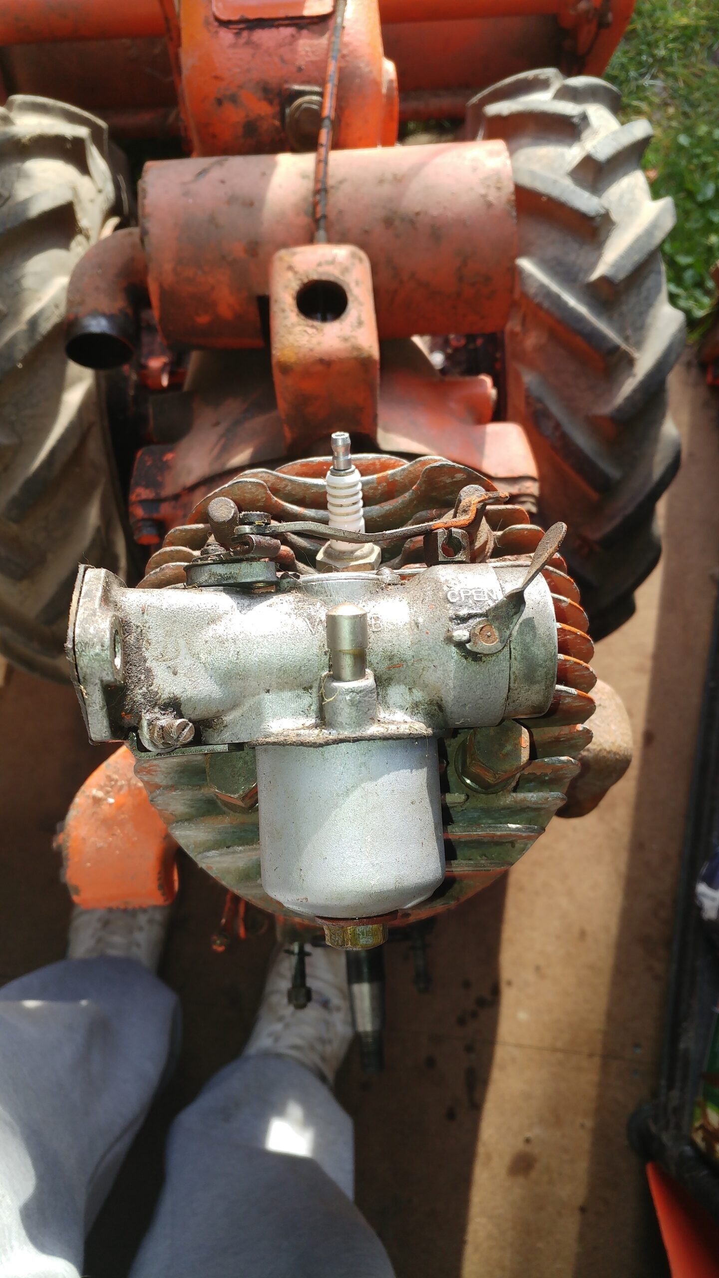

ParticipantThe linkage you refer to is the freewheeling system , in the position in your pic it is in freewheel , in other words it can be easily wheeled about without engine running. Slightly and gently lift the tab and move it towards the gearbox and your machine will be in drive , you may have to slightly wriggle the machine from side to side to align the internal splines , but this is common , under no circumstances force it.
Your cylinder bore , although not easy to tell from the pics , appears to be OK , is there any undue “piston slap”??.
Again from the pics it seems to already have had a new coil fitted , so assuming the conenser is OK , I see no reason why you shouldn’t have it up and running fairly soon.The bane of the 700 was the air filter , if you intend to use it regularly , make sure your hose and joints are all in good order , and that the filter is also , taking care that it seals properly inside the housing. I think I’m right in saying (Hortiman may well confirm) that a Diesel grey Fergie oil filter will do the job as a relacement.

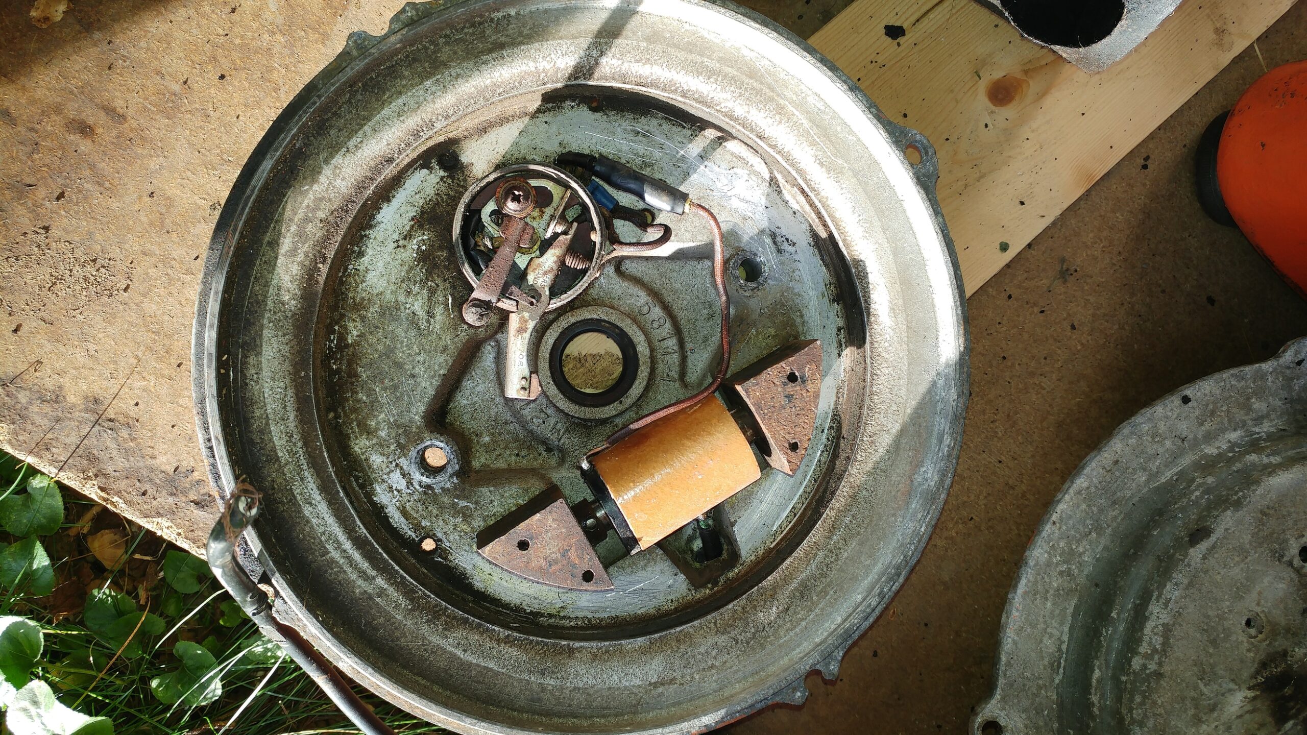

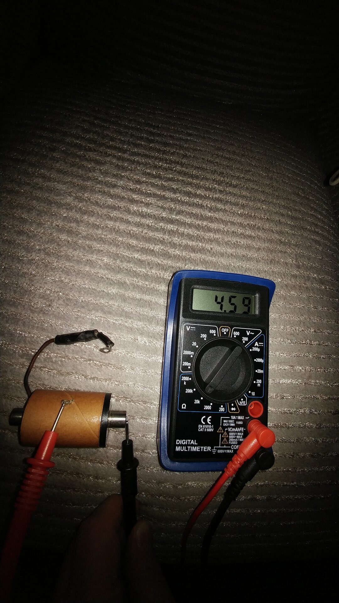

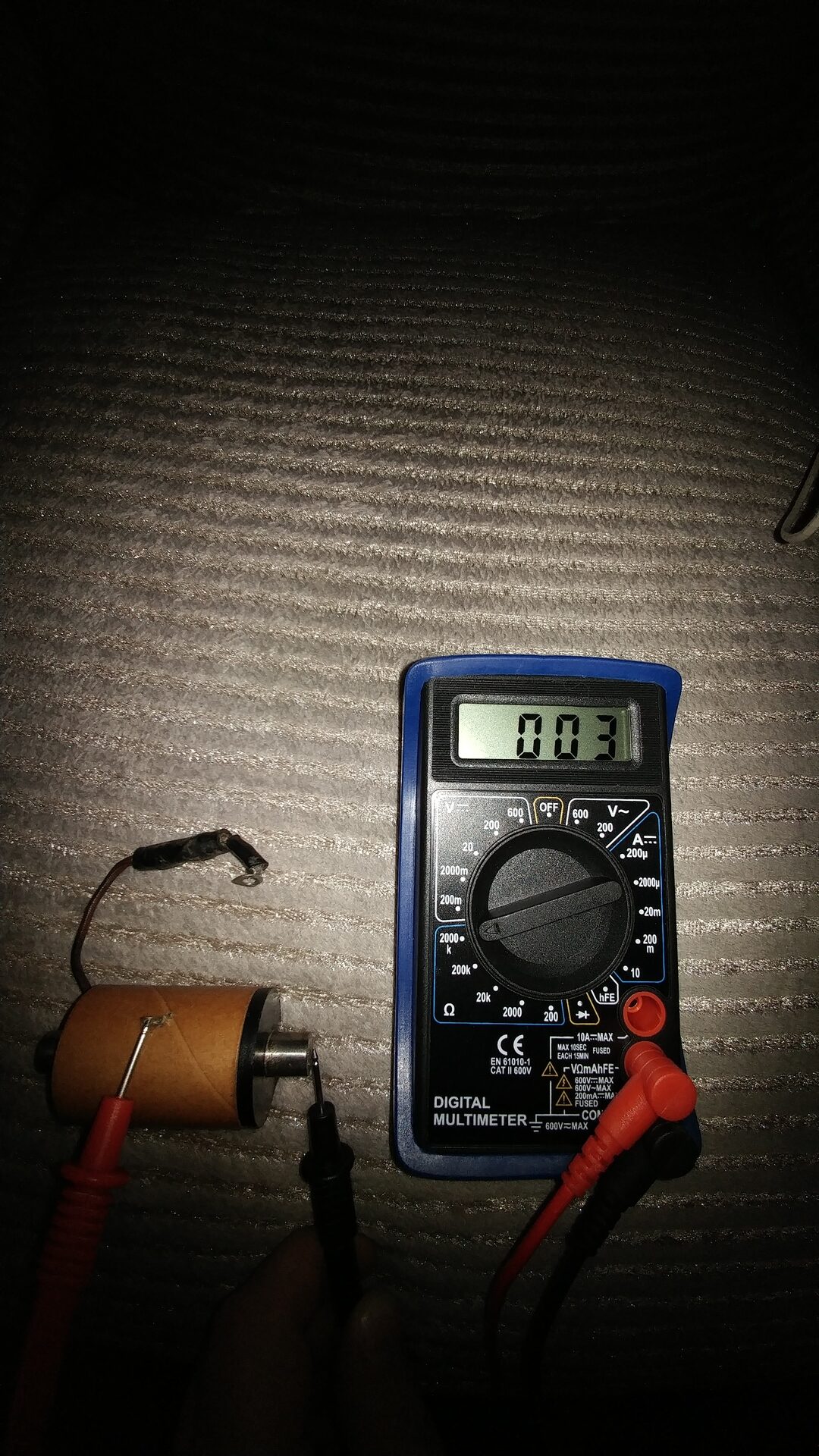

vhgmcbuddyMemberok ive just tested my coil after having to go and buy a new multi meter as my other one wasnt working. Ive done 3 readings on it and im no expert to say if the coil is ok or not, so yes i though id leave it to you guys lol . So here is 3 pictures for you to look at if you wouldnt mind giving me youre expert help , many thanks.
December 17, 2016 at 5:00 pm #23665andyfrost
ParticipantI’ve lost count of the number of times I’ve said on here that multimeters are no good for properly testing coils , they need to be done on a proper ignition tester.
It’s not always easy to tell from photos , but judging on the colour of the coil , it appears to be a later modern replacement , have you cleaned and reset points and tried for a spark , making sure all the wiring is correct.Andy.

vhgmcbuddyMemberThanks for your reply andy , i have no idea on the situation of the motor and points etc as im having to rebuild it all as it was in pieces when i got it. At the moment all im doing is cleaning her all up and re-building her as when i purchased it a fair bit of it was in pieces , so im replacing bits and piecess that i can manage to get hold of. Im no mechanical or electrical expert , so im going by very helpfull info im getting on here and watching videos on youtube etc.
You are also correct in saying its a modern coil also , but going on the reading im getting i believe now that the coil will be ok to use. Fingers crossed i get her going very soon.December 17, 2016 at 10:34 pm #23668andyfrost

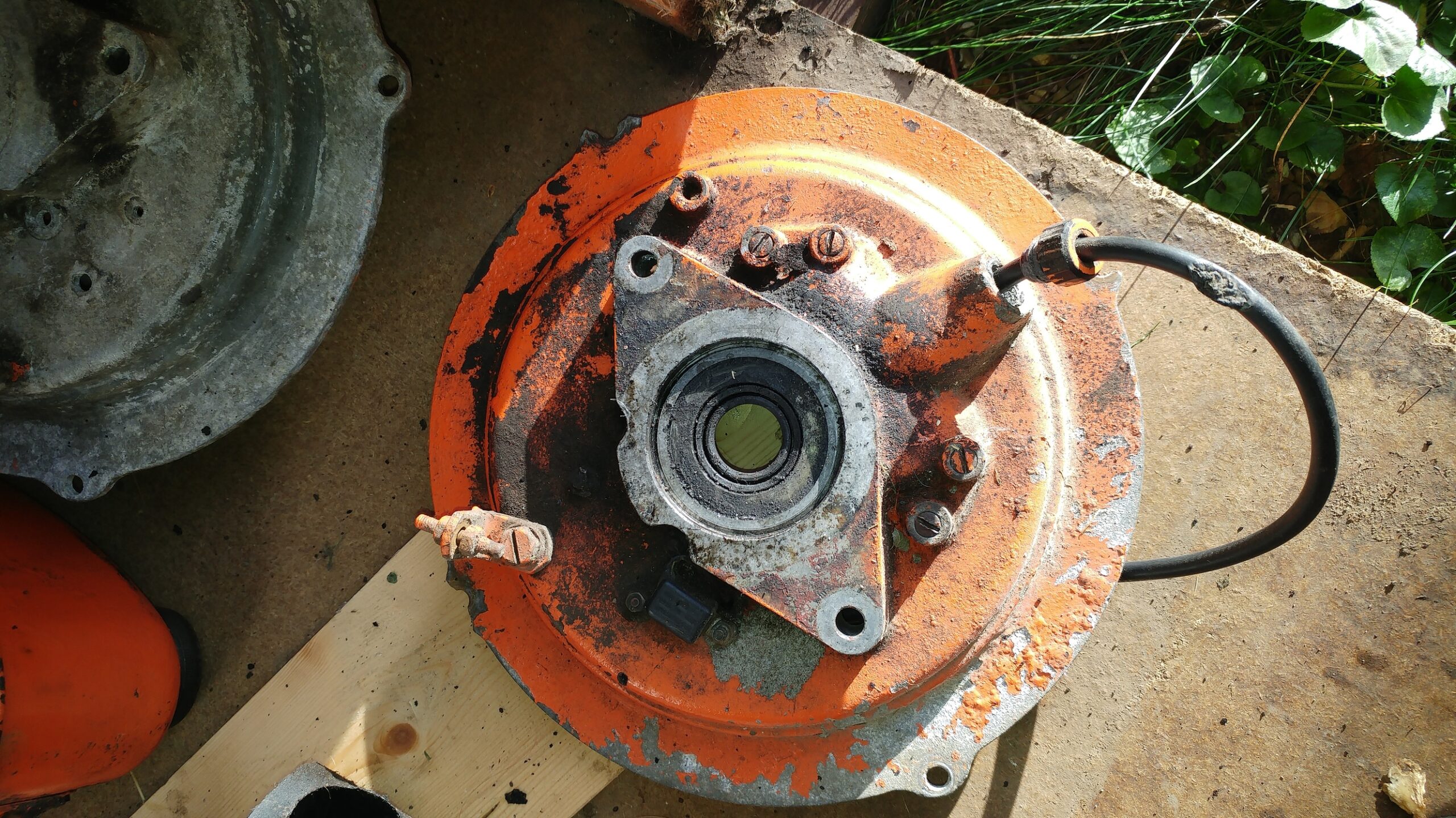

ParticipantBarry , looking back again through the pics you have posted , it seems the wrong coil has been fitted , it looks to be a “short” coil in place of the correct “long” coil. In all my years of fiddling about with Villiers engines , I can’t say I’ve ever encountered anyone doing this before, when taking into account both coil types are still easily available
However provided the correct bushing has been fitted , I can’t see any reason why it would not work. The correct coil is a 1030.
With no disrespect to the previous owner , this is more evidence that it has been messed with , by someone who , shall we say , is not quite fully switched on.Moggyjim , flywheel is held on a keyless taper , set timing to 3/16 BTDC.

vhgmcbuddyMemberThanks again for all your help guys , i think im going to bite the bullet and buy a new coil and new Villiers points/condensor box . The one ive got is in a prety poor state and id rather put in the correct parts and have it as close to a genuine machine as i can.

ParticipantThat’s a VERY wise decision , only my personal opinion , but I’m not a great fan of the cheaper coils that you have on yours. The new ones sold by either Villiersparts or Meetens are, I would say actually better than the originals. They’re not cheap , but in the long run far better , in terms of value for money, and most importantly performance.

I think your best bet is to replace the coil as recommended, the difference can be remarkable, even with a coil that is apparently working.
