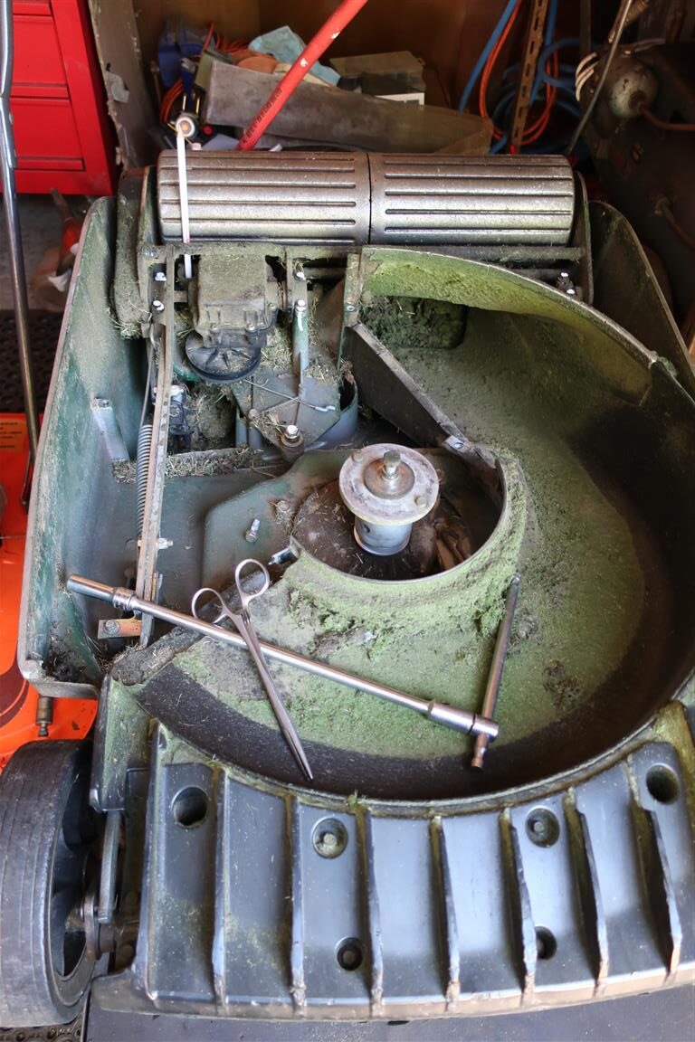

    Yes, I’ve got one on the bench at the moment!!!
    It’s a bit of a fiddle getting the belt on off and on to the trans pulley but can be done without any major dismantling.
    What do you need to know?
    Should add that depending on the model of 56 the trans belts may be 2 x 411024 or 1x 411024 and 1x 111-1254. so checking the part numbers against the model number – for example 560F – is wise.

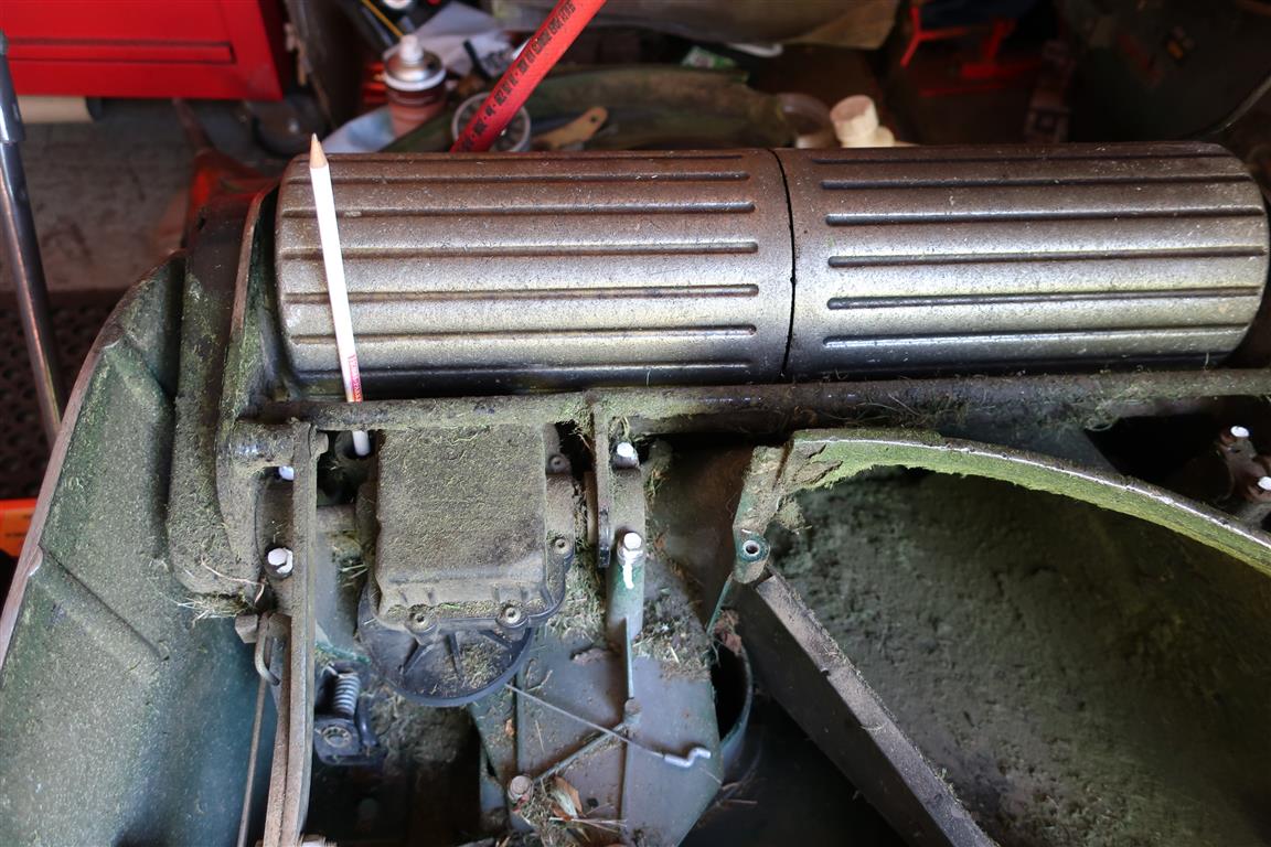

    Where the white pencil is on the images is a deep recess in the trans casing with a hex head screw in the bottom. Undo and remove that screw (hence the tweezers) and it allows just enough rock in the trans to make fiddling the belt in or out easier.
