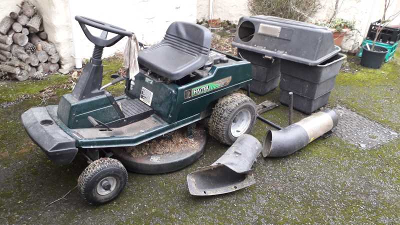

vhgmcbuddyMemberI have the fabulous Hayter 10/30 which i have used for over 10 years (I bought it second hand and restored it the best I can). It picks up grass, mulches and throws it out if required.
It has worked fine for all those years bar the odd belt replacement.This week after cutting, it suddenly would not drive after i switched it back on after
stopping briefly.
Not forward or reverse. Additionally the brake does not work ?
The engine runs fine.The drive belt has not broken either. (I have not yet replaced it as usually when
a non drive issue happens it is the belt snapped)In any gear engaged I can push the mower forward and back with no restraint.
With the brake on i can push the mower forward and back the same.This was sudden ?
I have adjusted the clutch mechanism to no avail.Any ideas ?
(Just so you know I am very familiar with mechanics and have restored
4 vintage motorcycles but this has got me ?)
