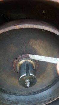

    Could the problem be that the key has been driven too far along the keyway and is pressing against the bronze bush on the clutch drum, causing it to spin with the crank?
    #22843
    Hi Busman. Yes, I did wonder the same thing.
    When I originally took the clutch drive off the key just dropped out, so I never got to see how it was situated.
    Do I assume the tapered end goes downwards and towards the bush?
    I could easily losen the clutch drive and pull the key away from the bronze bush a bit.
    One more question. Could I start the engine with the clutch drive removed? If so, I could then see if the drum rotates place – this might narrow down what the problem is.

    #22849

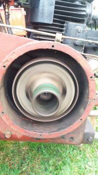

    It looks like someone has modified it at some point, as the normal key for this fitting is one with a grease nipple in the end and the key itself is drilled to pass the grease to the bush. The engine crankshaft is not normally drilled like yours, so it possibly has been a problem for the previous owner(s). From the first picture it does look like there’s a large gap between the bush and the crankshaft which will allow the drum to “pick up” every now and again, and no amount of greasing will correct it. It may be that you need to replace the bush- take the dimensions for the inside diameter, outside diameter and length of bush to any bearing supplier and they should be able to sort you out. Some suppliers only stock metric these days, so you may have to search around for one that sells imperial sizes.
    Of course, you may be right with your first guess that someone has pushed the key in too far and it is causing the drum to rotate with the clutch. Just pull the key out a little to test the theory.

    #22854
    With the knowledge you all have, I know we will get to the bottom of this problem. (interesting to know trusty220 that this is a modified crankshaft). The gap you referred to I believe to be an optical illusion as there appears to be no gap when seen in the flesh, indeed the drum seems to sit perfectly on the crankshaft.
    I will try pulling the key out slightly to see what that does and maybe position the clutch driver slightly away from the back of the drum.

    #22891
    The copper washer should be free to rotate around the crankshaft so that it doesn’t transfer the drive from the clutch carrier to the drum. The key should not protrude from the back of the clutch carrier.

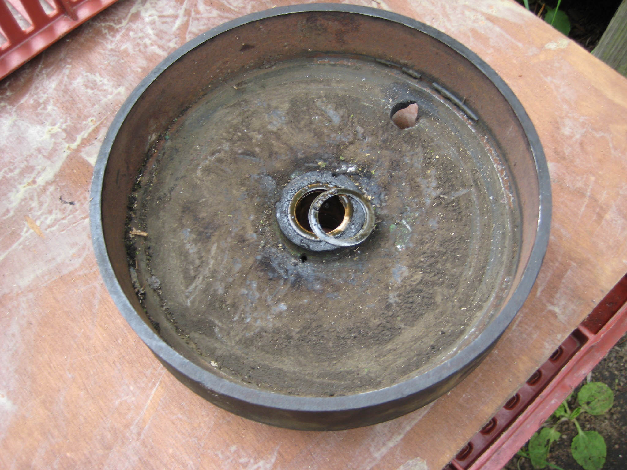

    #22892
    Here’s a photo of the copper washers on my Trusty. They are the same inside/outside diameter as the bronze bush in the drum.

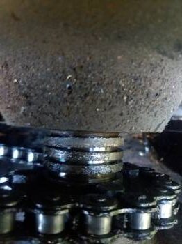

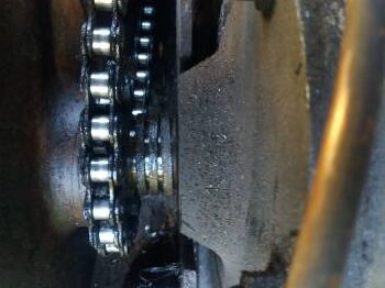

    Thanks for the comments, that all makes sense. Mine does not have the washer, so I will try and locate one of those.

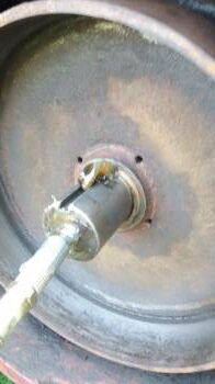

    I took the top of the clutch housing off today so I could get to the other side of the clutch drum. There were 3 spacers (see pic) which i cleaned up with petrol and re-greased. I also added more grease to the bush via the grease nipple, this had the effect of pushing out some dirty grease. I then re-located the clutch driver and key just a fraction away from the drum. End result of all this is that the clutch now works perfectly! So thank you.
    Next question – How do I remove the clutch shows from the driver, as I need to get them re-lined. Ben

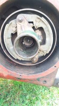

    #22895
    Sorry, can’t seem to get the hang of posting pictures – Here they are (hopefully)
    Pictures taken before I cleaned it up.

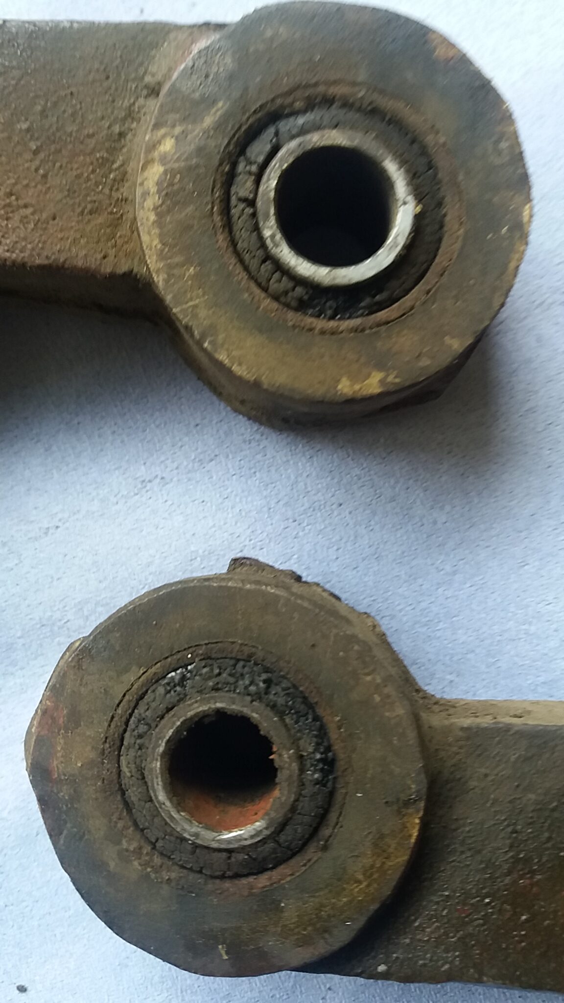

    #22991
    Ok. The Trusty clutch shoes came out of the driver just fine and I have found a local company that does re-lining. I have also ordered and received new clutch shoe bushes. So my next questions are: What’s the best method/tool for removing the old bushes and installing the new ones? Also what’s the best way / product to clean up the shoes before I have them re-lined (petrol and a toothbrush?)
