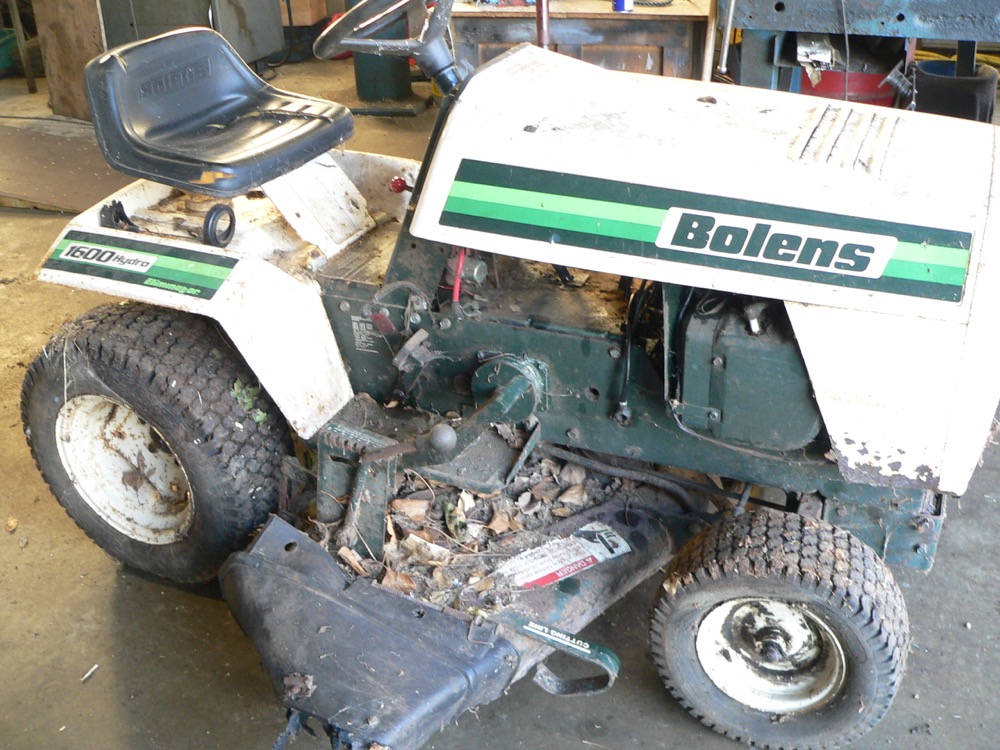

    Well done with finding the Bolens! Yes, the bent lift arm is quite interesting!
    I see that the Bolens has an ‘Eliminator’ badge on the rear fender which was used in the late-1980s and in to the 1990s. The Eliminator range seems quite random and included the model 1600 and ST140 hydro; do you know what exact model this one is?

    davidbliss

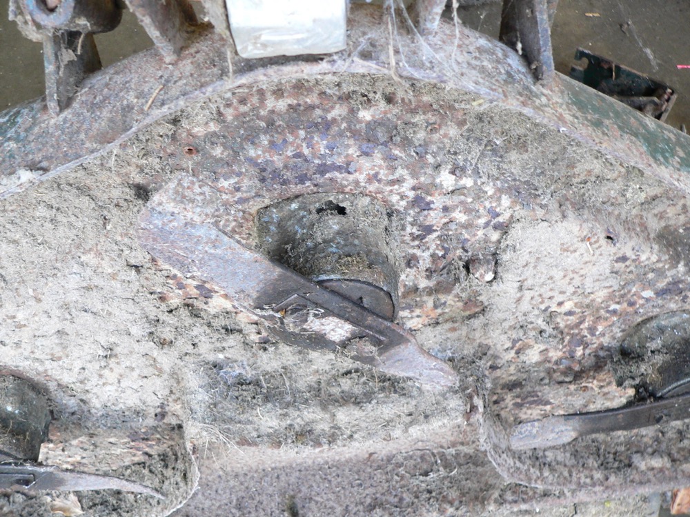

    Got the H 16 home this morning its a 1668 model and serial 0501139, Its really been neglected, deck is shot looks like one bearing housing will be ok, tyres aren’t good as perished with cracks, most bits stuck, hydro-trans is very low on oil, engines oil ok but blacker than black, however steering not that worn, so will just brake it for bits and if the hydro is ok will just use that and bin the rest after have rebuilt the Howard Bolens with a V twin, so engine and framework and tin will be spare, had to take tank off to straiten the deck lift lever,

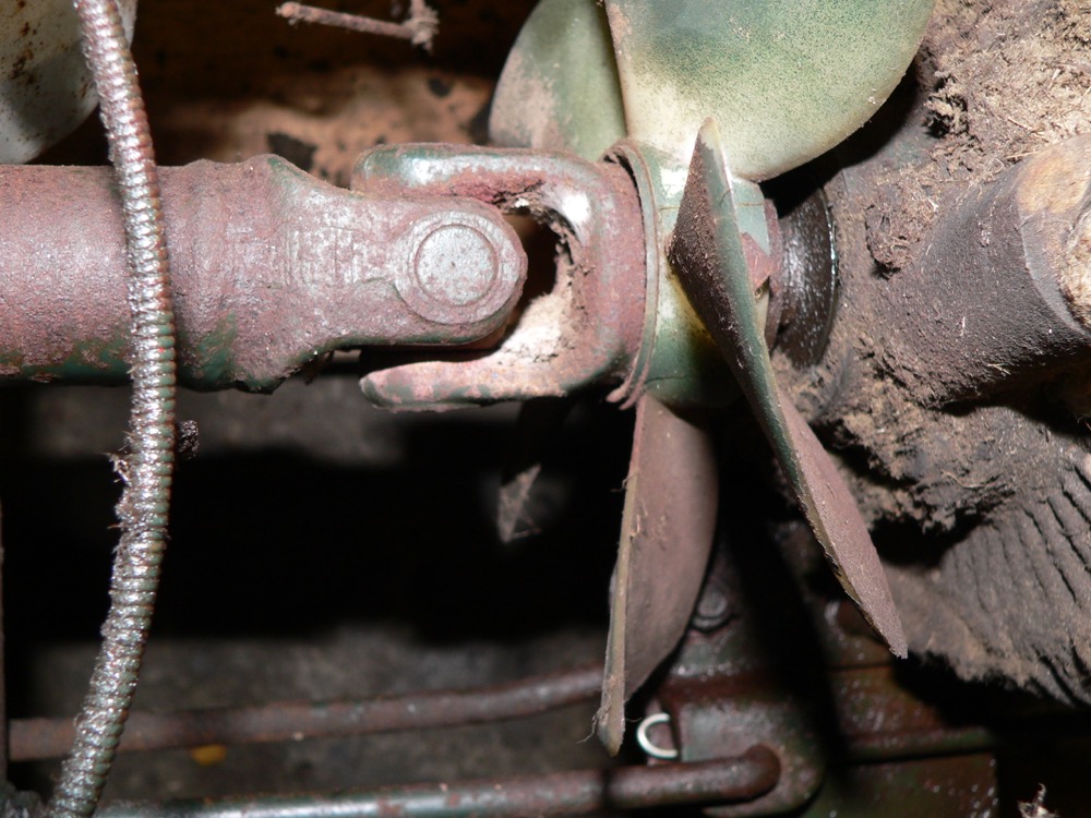

    davidbliss
    few photos, straitened the lift rod, can’t believe it had even twisted the tube at least it works easy, taken the mudguard and top above hydro unit found was packed full of? what looks like they tried to shear sheep with it, changed oil what was left in hydro as smelt rather bad.

    davidbliss

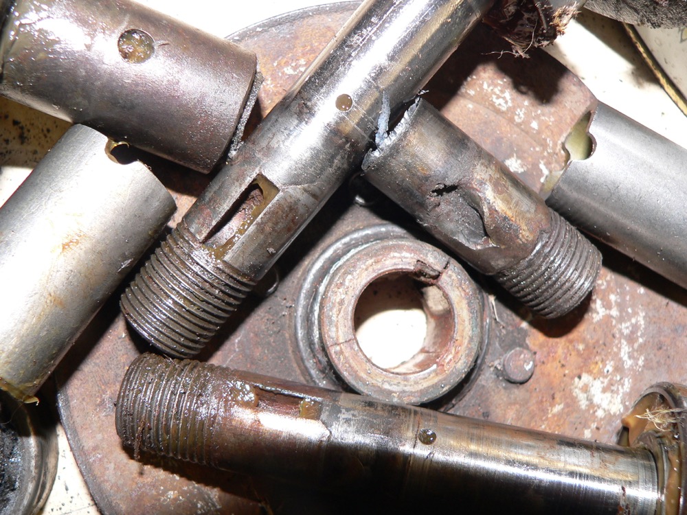

    Few bits really usable, all deck parts, bearing housings, shafts and two pulleys are scrap,note early and late pacers so been buggered before, supposedly only used three years, well my deck in forty years use and sometimes mowed 5 acres and weekly mowed 1+ acre has needed little attention and still good. I have now modified the last front carriage to be like the early 1980 one that is easy fit and doesn’t rattle like the mark 2-3 types why on earth did they alter them, never had any issues with the first type, now its been run the hydro is started to leak so thats why it was short of oil, overheated and that heavy drive shaft got lots of runout. several photos.

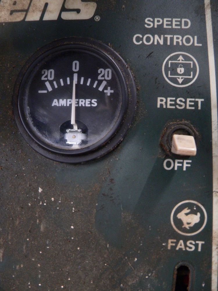

    A why did they do that?,
    On that Eliminator model they fitted an electric brake on the hydro pedal so when you have got to a speed you want to keep at flick the switch and lock the pedal, not a safe idea in my thinking, been far better to have a variable position stop just to restrict pedal movement to a given speed and if need be would stop as normal, my daughter at only 6-7 used to mow and use a trailer as the hydro was a fail safe as soon as the pedal was released it stopped dead, with the electric braked pedal locked could just imagine the fish getting a bit of excited with a new weed cutter entering the pond or worse.

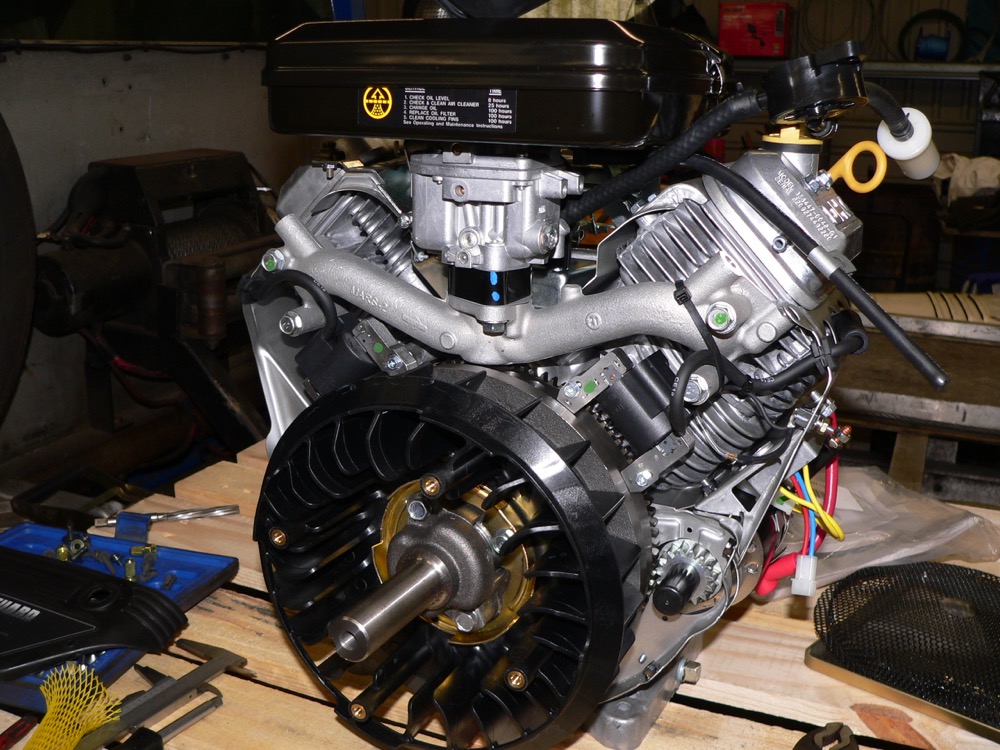

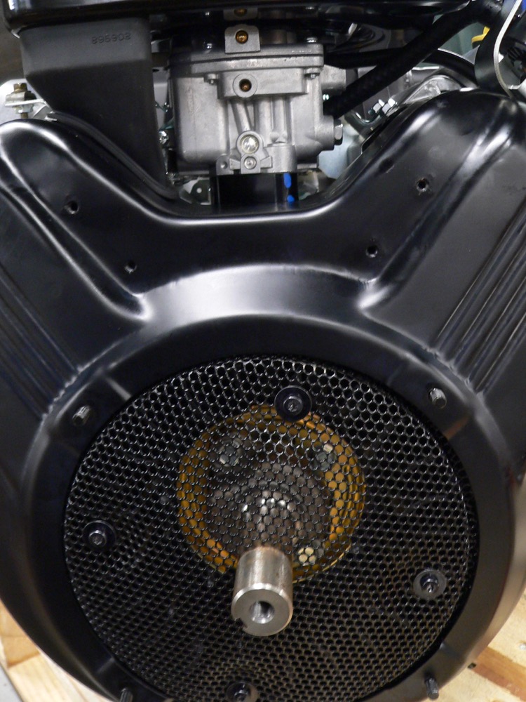

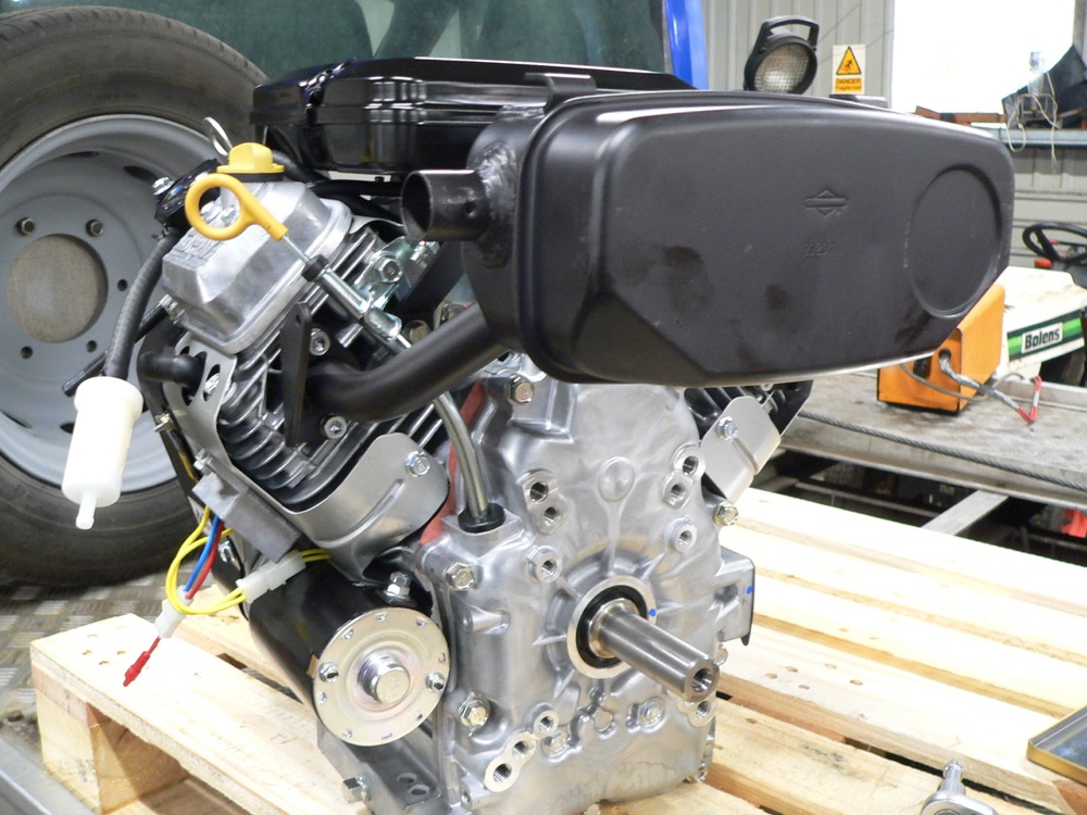

    Well not going to repair the Eliminator, my old Howard Bolens is in much better not been got at condition yesterday got a USA made V twin, but takes a day building it up, also the old Howard drive shaft is different to the later 14 HXLin that the copling has a 1” inch drive two piece where as the older one is a single piece and bolts strait onto the flywheel, so will copy the later one. just been given some bits looks like three bering housings and bearings with a good belt tensioning pulley still shiny.

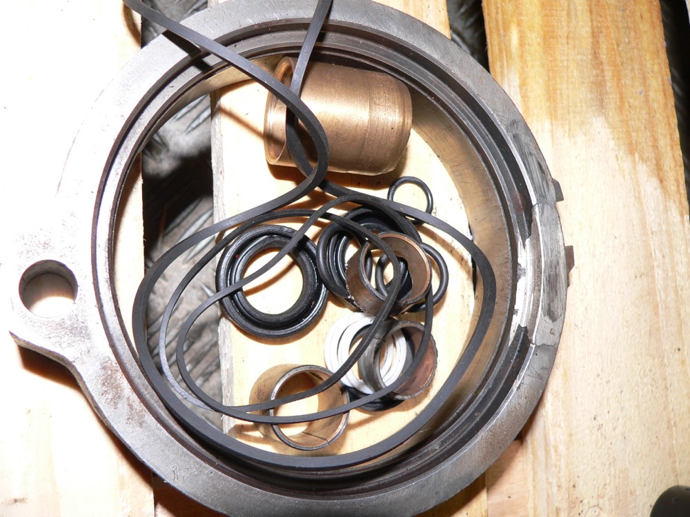

    Does any UK firm supply a Hydro seal kit. I have all the nessarsery plain bearings left over from the last one I did. I had forgotten just how many O rings and teflon seals there were in a kit. photo of what had to replace last one I had to do. I tried to building up the damaged squash plate but wasn’t hard enough and the hyro clamps just beaded in, made one out of a heavy duty cultivator leg.

    No, think its a Eaton, smaller versions are fitted in the Westwood, JD and others. running out of line with the Briggs flat twin and with the heavy prop shaft has knocked out the plain bearings, I was hoping the Eliminator would yield some useful bits but is shot everywhere, just taken the early 11hp out of the Howard Bolens,I rebuilt that 20 something years ago and as hole unit never been neglected going to rebuild that, just odd the 11hp has a 1” 1/8 output shaft flywheel end the new V twin has an 1”inch. When I done the 14hp and fitted the V twin in that that shaft coupling was same as the Tecumseh so a lot easier swap.
