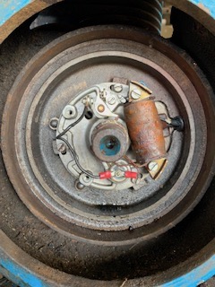

    HI, thanks for the response.
    The engine doesn’t have a separate ignition coil (like a mini) the flywheel has a magnet attached on the inner side and bolted inside is a fixed ignition coil. Does the coil need a 12v feed to energise or is the electricity created by the magnet rotating the fixed coil? There is a black wire from the points that follows the HT lead out of the engine casing, is this an earth?
    I will upload a couple of pictures to help.

    #30786
    Picture of coil
    #30788
    The magnets induce a voltage in the coil so no external supply from a battery needed. Circuit diagram for a Villiers flywheel magneto.
    #30789
    Ok, so the ignition is from a flywheel magneto which does not require an external power source. Your black wire is most likely the “ kill wire” to stop the engine when earthed via a switch. As your machine had electric start the “ ignition” switch would probably performed the kill function when in the Off position. With that set up you must be careful to get the wiring correct . Getting it wrong and feeding battery voltage through the ignition coil will most likely destroy it.

    #30858
    Hi Charlie, just a quick note to pass on my thanks for your reply and most useful link. After further investigation it appears the exhaust valve is burnt out and probably led to someone constantly cranking the engine and knackering the dynastart. Also it looks like someone has wired the coil wiring to the battery wire on the dynstart and might explain why the coil isn’t working… think I’ve found a company that can repair.
