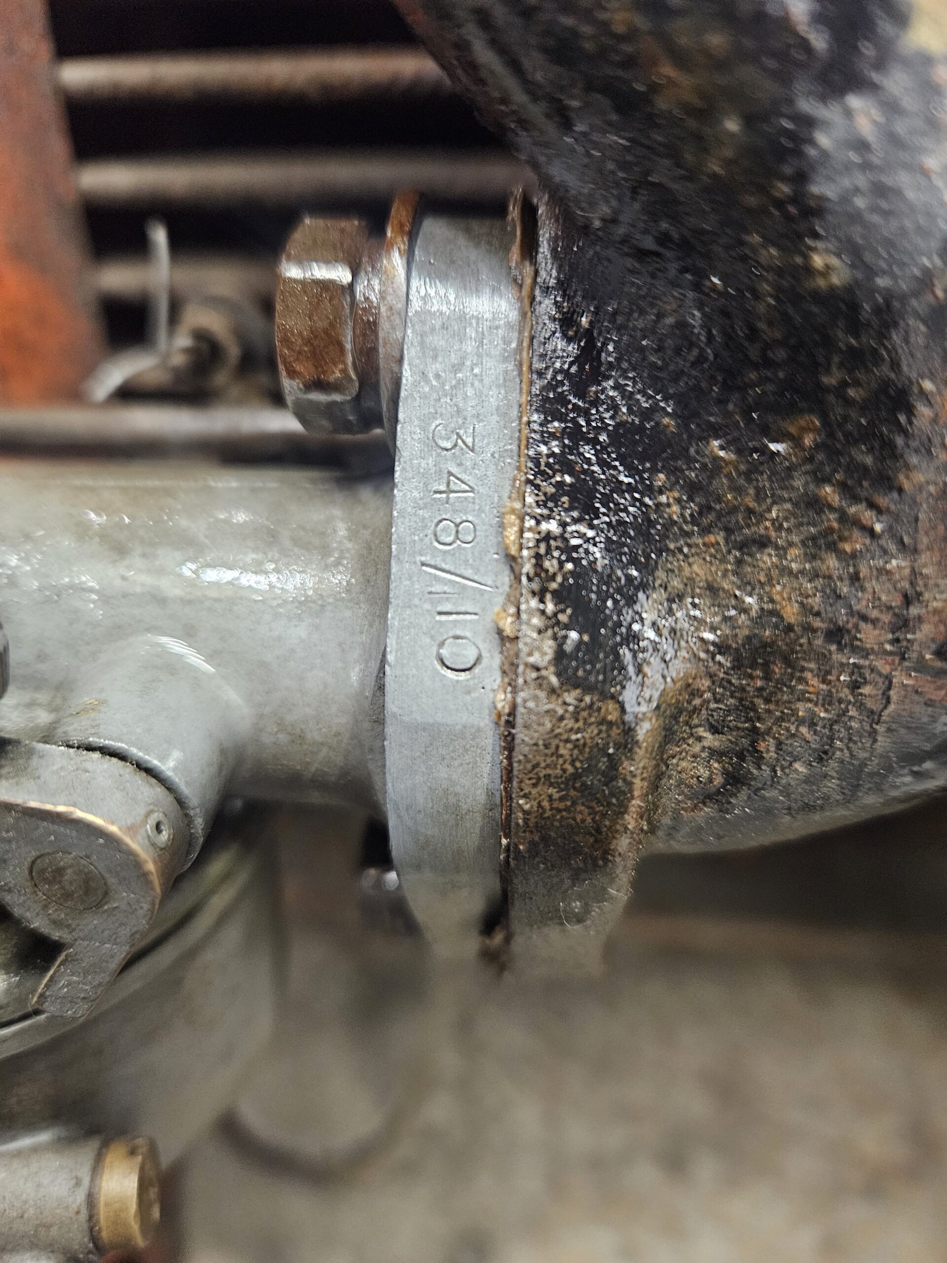

ParticipantHi all. Newbie hoping to pick brains. I have a Howard Gem with the 810cc 360 engine. It has what I believe to be an Amal 348/10 carburetor. Problem is I seem to have the only one ever made. I have finished the internet looking for eithwr a replacement or a rebuild kit but cannot find any reference to this particular carb. My uncle has had a tinker and has suggested getting new jets but cannot find anything anywhere. Would anyone either have a link or suggestions on a replacement carb that will fit maybe.

June 22, 2024 at 12:35 pm #42467andyfrost
ParticipantHave you tried George at villiersparts.

ParticipantIt’s a bit of a head scratcher this end too mate. It got put into dry storage a year ago. We collected it a few weeks back and obviously any fuel etc had gone stale. we cleaned the carb out and flushed the tank and it ran fine. We returned a couple of days later to run it up and then take to the allotment and it was running but the hunting almost with the governor controlling the revs a lot which it never used to. Now it only wants to run on choke and spits back every now and then through the air filter. I have a compression tester coming this afternoon so will try test and report back. also like I said it won’t hurt overhauling the carb either to rule it out.
