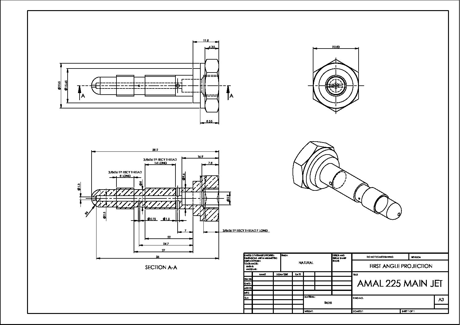

    I have a Douglas SV54 engine fitted with the same model carb, so have pulled the main jet out and produced the attached drawing. I also have a Trusty with Norton Big 4 engine and Amal 225 carb. The main jet is identical to that in the Douglas carb apart from the spanner hex on the Douglas carb is 7/16″ Whitworth, where the Norton is 3/8″ Whitworth.
    I think you will be very lucky to find anyone willing to make this. Even if you do, deep pockets will be required!! Expect the cost to be well into 3 figures.
    Anyway, hope the drawing helps and I will keep my eyes peeled for a donor carb. Autojumbles are the best place to find them (if any take place in these challenging times!!). Online auction sites are a last resort.

    Whilst getting an engineering company to make one will be expensive an alternative may be to find a local model engineer willing to make one, worth trying.

    Busman’s stunning drawing (thank you for the time and effort) means I can delve into the possibility of having one made and yes, charlie, it will have to be a rewarded favour from a hobbyist.

    If you get stuck, I can probably make you one from the drawing. I need to have a look to see what taps I’ve got and will need to sort out a couple of drills, but that’s no big deal.
    Let me know if you want one made but remember it will need to take a back seat for a few weeks while I try and sort out my Villiers engine.
