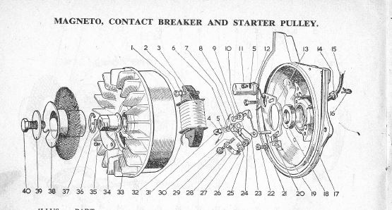

    Hi All, I need to remove the flywheel / fan from a Villiers Mk7 engine. So far have removed the bolt and washer and taken off the pulley. Now I’ve got a hex nut holding the flywheel on which won’t undo because there seems to be a circlip deep in and hard to get at. Is this stopping the removal or is the nut just tight? I’ve seen conflicting stuff online but most seems to be saying undoing the nut should self-pull the flywheel off. I don’t want to give it some real force in case something breaks. Advice please on how to properly get the flywheel off. Many thanks, Mick

    That’s as it should be, the nut is captive to exert a force on the flywheel to pull it off the taper on the crank. Villiers provided a special spanner designed to be struck with a hammer both to remove and, equally important, to tighten it sufficiently to maintain the flywheels position on the crank to preserve the timing – there’s no key to position it.

    I’ll mark up the flywheel and crank before undoing the nut
    You may find that Villiers have done that job for you. At some point in production they used to set the timing using basics such as piston position and points opening and then rotated the crank to Top Dead Centre and stamped an arrow on the flywheel rim to coincide with another reference mark on the flywheel housing back plate. If you are fortunate enough to have one of those engines, all you have to do is to clean and set the points to the correct gap (12 – 15 thou),turn the crank so that the piston is at TDC (probably best to remove the head to do this rather than at an angle through the plug hole), and fit the flywheel so that the arrow aligns with the mark.

    Hi Wristpin, Many thanks for helping out someone who’s very much still wearing L plates with his first mower. I had a more careful look at the flywheel last night and there’s punched dots on the flywheel and the back plate that I hadn’t noticed previously. Took the head off to be sure and they correspond to TDC. Phew! Hopefully that will make cleaning, checking* & refitting the ignition parts easier and for an accurate set up. So will sort through a toolbox full of rusty “vintage” spanners in my Dad’s garage at the weekend. I suspect (hope!) there are some Whits in there and one of the right size. Failing that I’ll invest some £££ in acquiring one. Once again many thanks. Cheers, Mick
