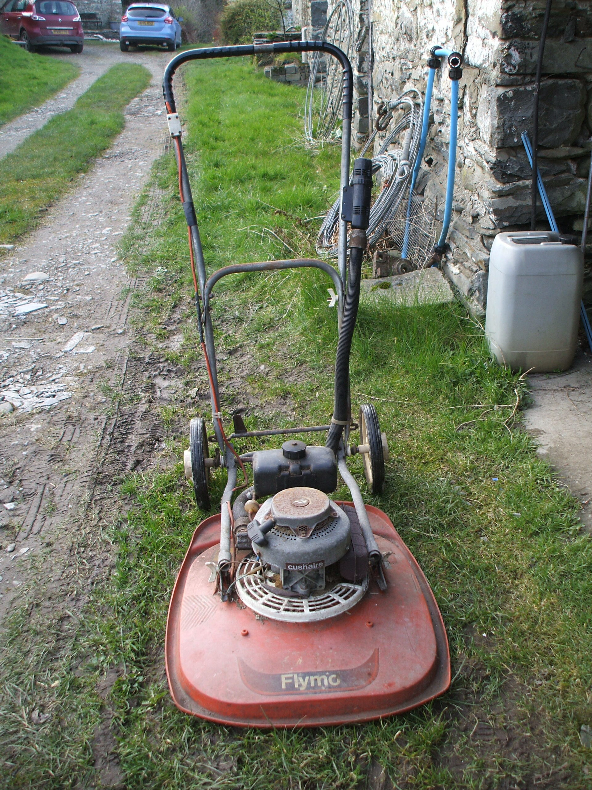

    I have just acquired what I believe is a Flymo Professional, not seen one with with two rear wheels before. Does anyone have information on this machine such as age and the engine make, it says Cushaire on the cowling.
    #41947
    hdtrust
    Flymo’s were sold under various names, the one you have in the picture is a Flymo Contractor 52, 52 coming from the cutting width of the blade.
    The engine should be an Aspera 122cc long life heavy duty, air cooled, third-port induction, loop scavenged two-stroke.
    The one you are showing dates from the earliest 1975 – 1981
    The engine speed is fixed at 3,300rpm, the carb has a diaphragm with a fixed jet and primer, don’t go pocking any wire into those jets, as you will ruin the engine!
    They were sold by the lorry load to Councils for use on banks, I can remember quite clearly the wheels were great for travelling site to site, but that frame always got in the way on steep banks, times many we attached ropes to them, sending them down steep banks then pulling them back up on the rope and at the end of the day having arms the length of Orangutans!
    #41949
    philip-s
    Many thanks for the detailed information.
    #41950

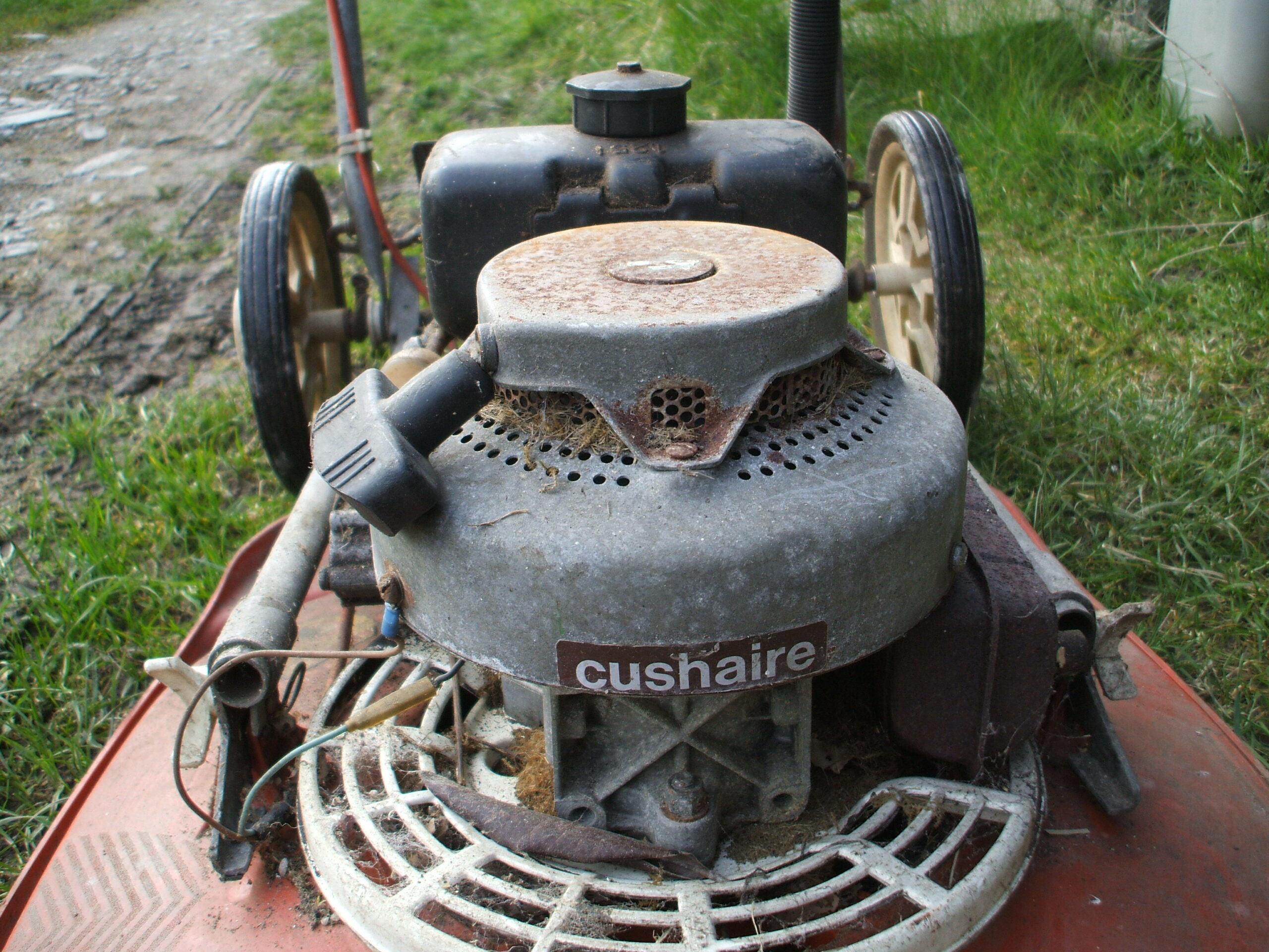

    I would say it is a Contractor GT2 model with a 2-stroke 98cc JLO engine. The GT2s had 19″ (47cm) cutting decks, and were available from the late 1970s.

    #41953
    That one is Definitely a GT2 ( some badged Contractor) with a JLO engine which was available with or without the wheeled undercarriage . The original Flymo Domestic had an Aspera TA633 engine a metal fuel tank, fibre glass hood and an alloy impeller. Next came a similar machine , Aspera VA633, plastic tank and impeller and plastic (ABS?) hood. Then there was a similar machine with badged Professional with an Aspera VA633 and a blue hood , optional handle bar mounted snorkel air cleaner and optional undercarriage.

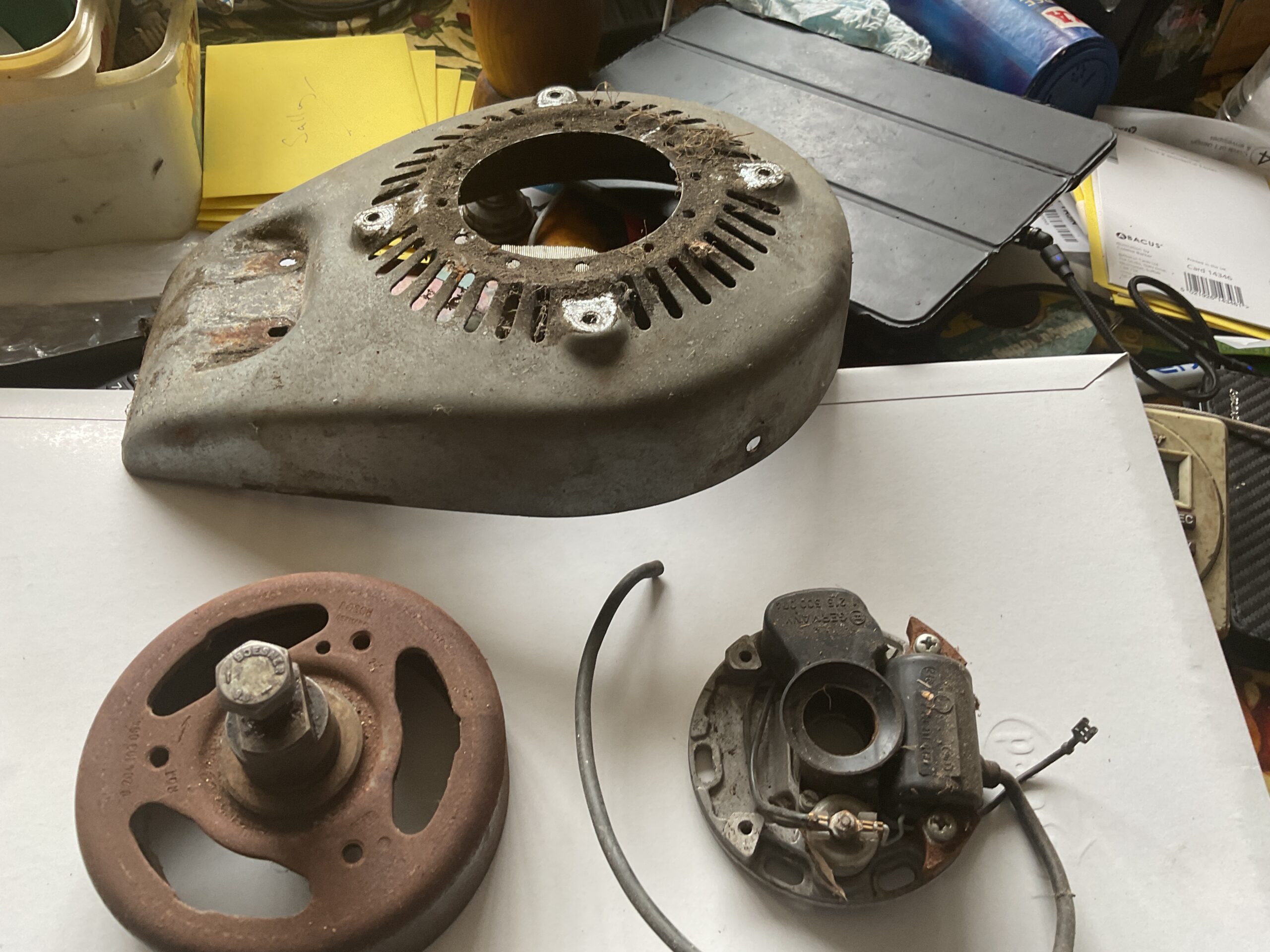

    The cutting width is 19 inch. I wondered about the cowling being apparently aluminium so it appears it is a GT2 JLO model. Now I just have to get it going, does it have the usual points and condenser under the flywheel?
    #41964
    Yes , from memory they are Bosch components
    #41965
    Yes they were Bosch magnetos. There was a special tool that screwed into the centre of the flywheel to pull it off the crank. Annoyingly the points gap had to be set with the flywheel in place as the cam was part of it. The “ windows” in the flywheel provided to give access fot feeler gauge and screwdriver, never seemed to be in just the right place.
    Back in the 80s we were servicing lots of contractor and golf course machines so to make the job easier I cut the centre from a scrap flywheel to provide a dummy cam before refitting the flywheel – still got the puller and my dummy cam.
