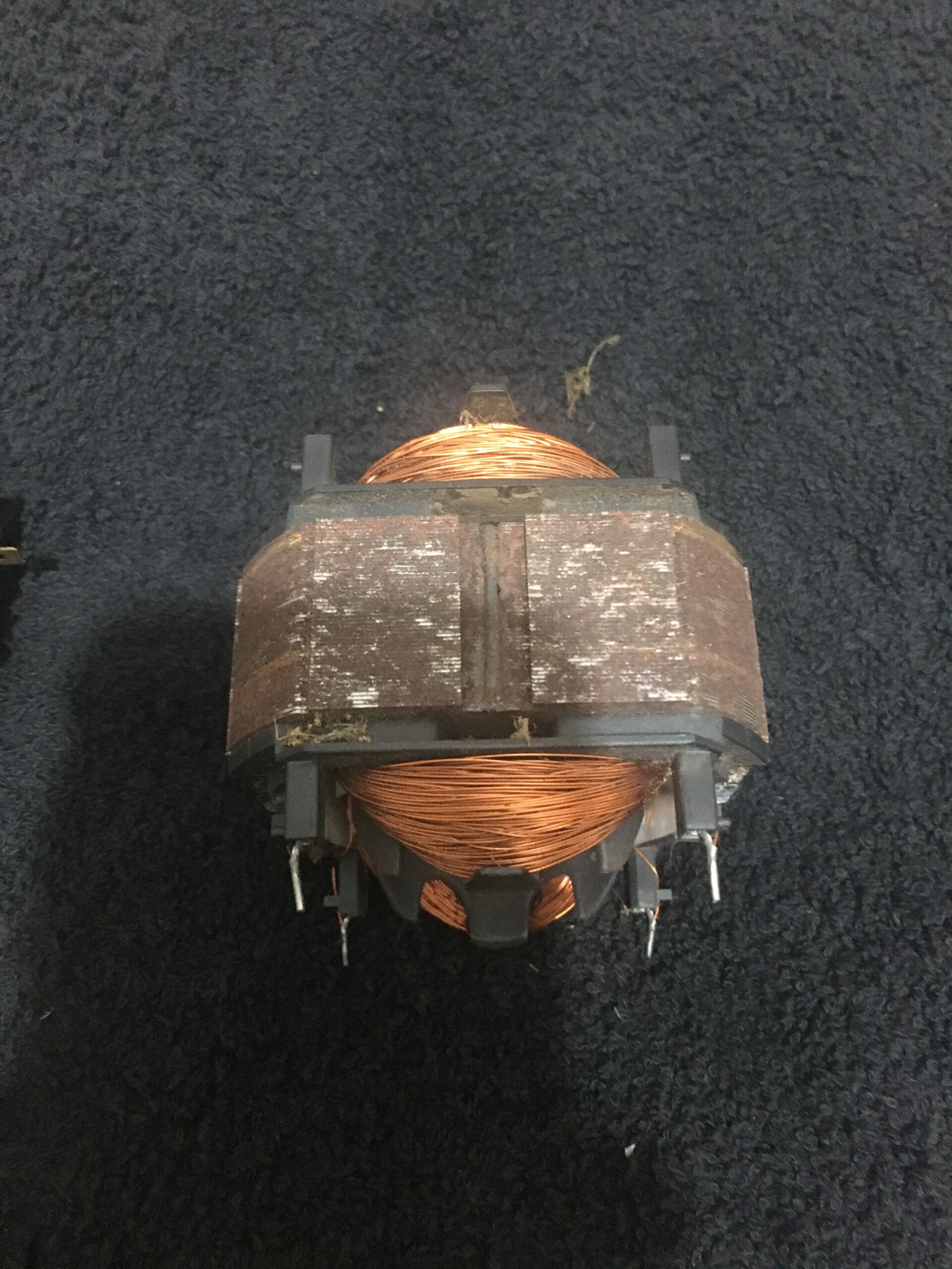

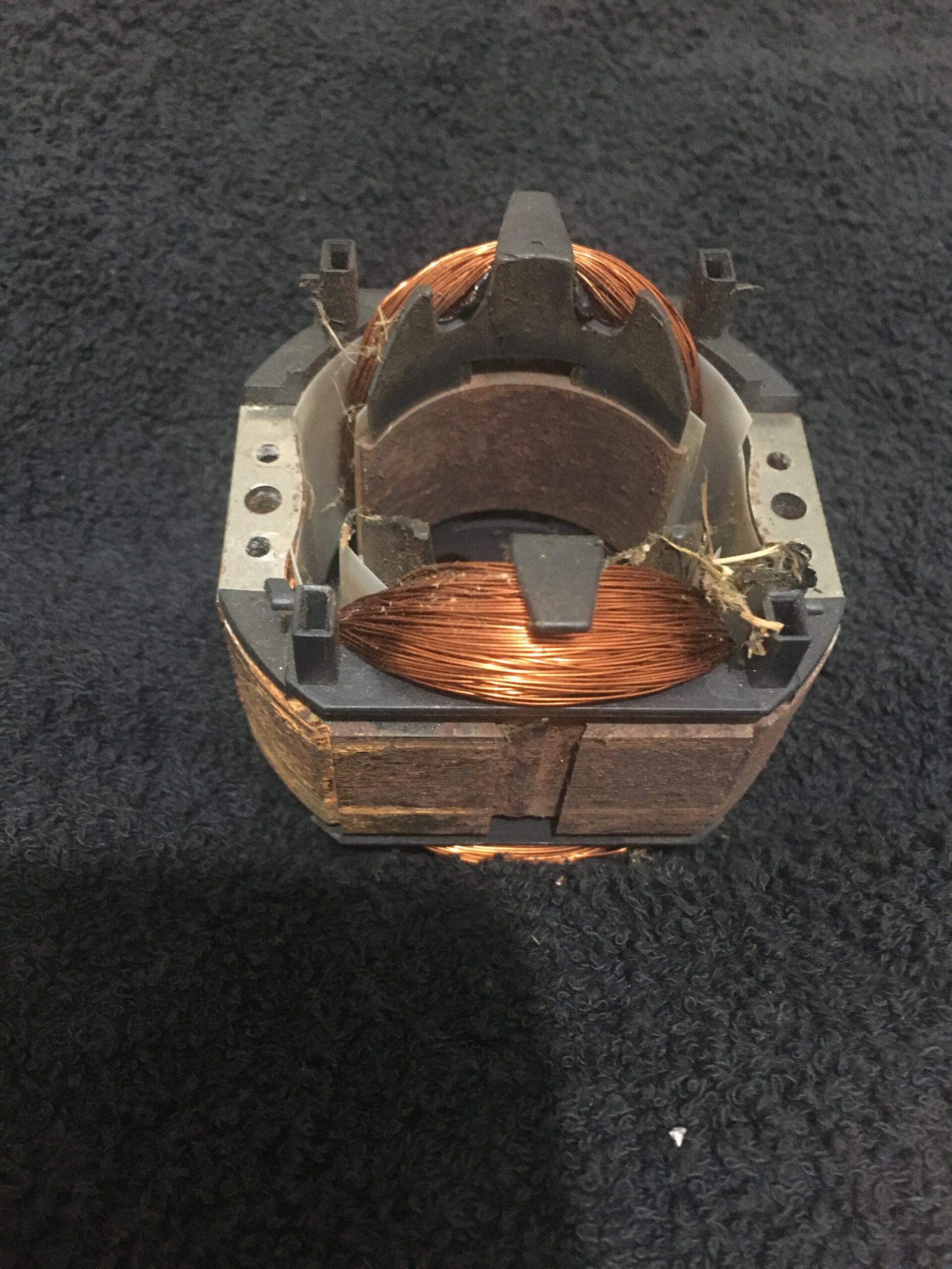

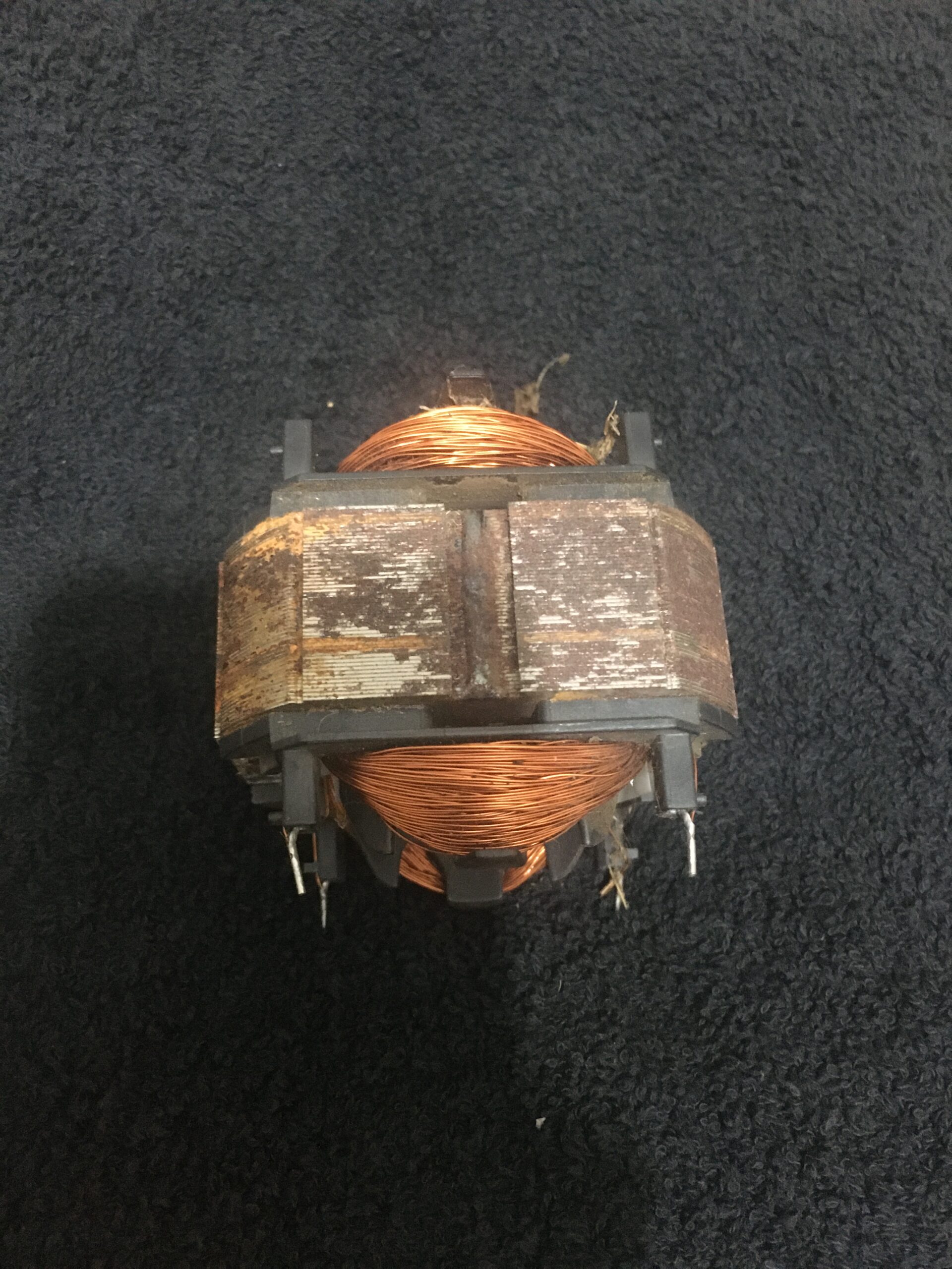

    Upon close inspection, the brushes are in good shape, but the stator and armature are extremely rusty and in real need of an overhaul and a good brush down. I will clean tbe commutator as I am at it as well.

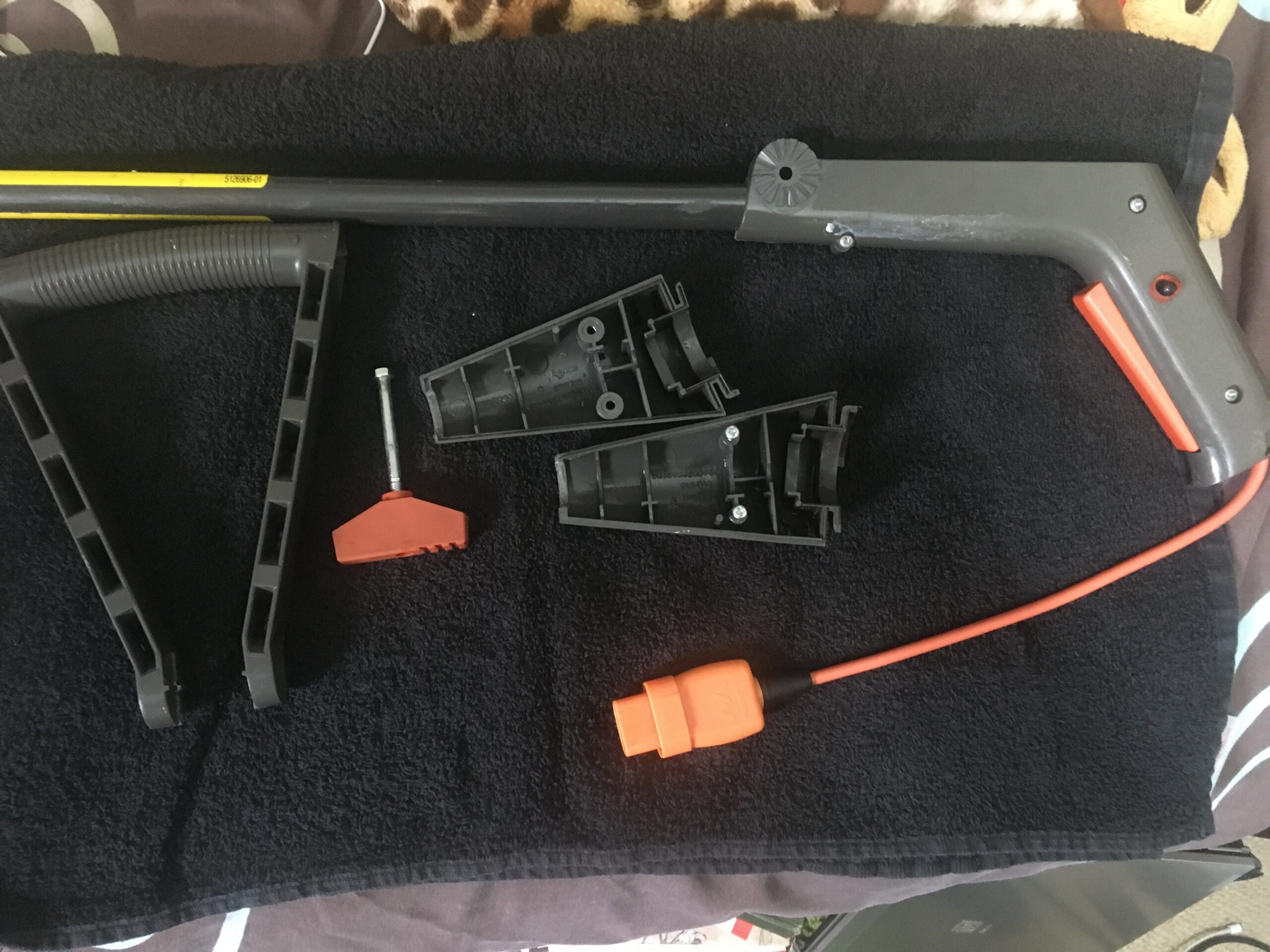

    I also gave the plastic parts and inner wiring a clean and wipe down.

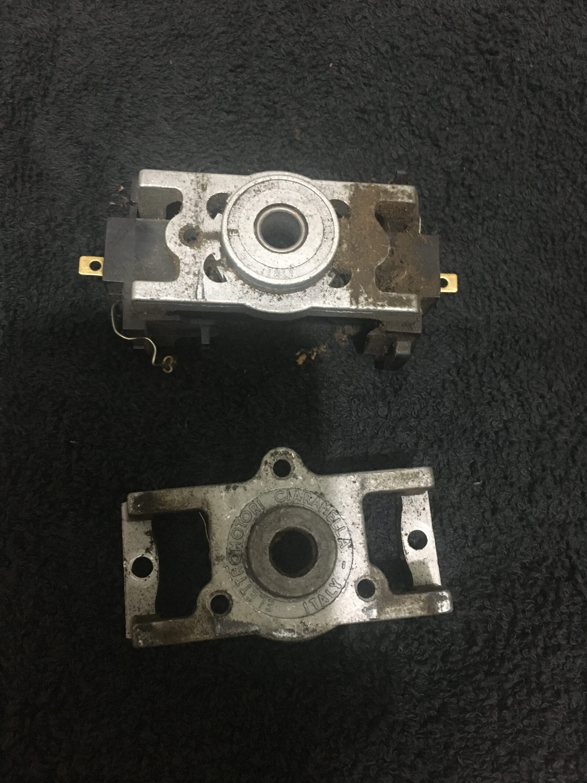

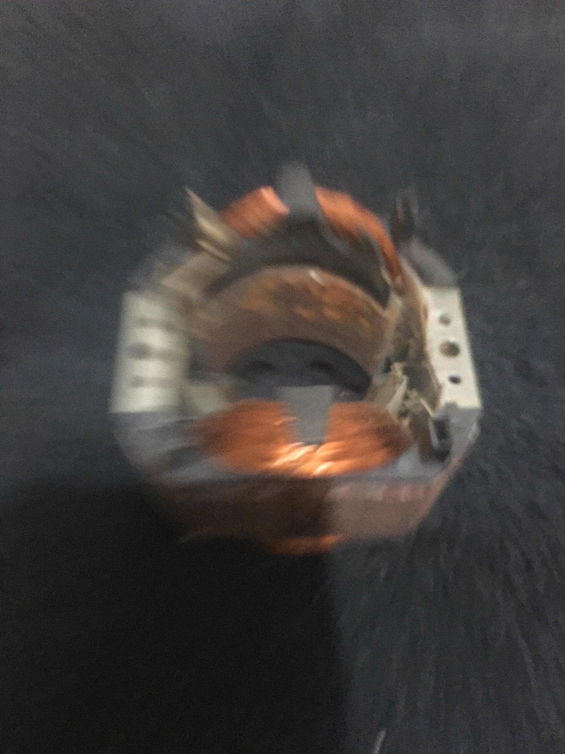

    As promised, here’s the motor, dissassembled.
    The brushholder bracket is branded “ELLETROMOTORI CARAMELLA, ITALIA” which I presume is the motor manufacturer. I can’t find much info regarding them.
