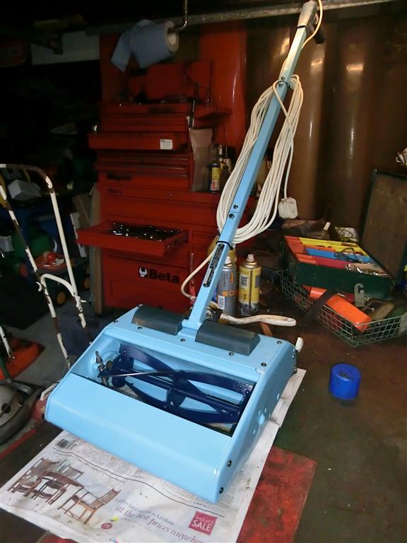

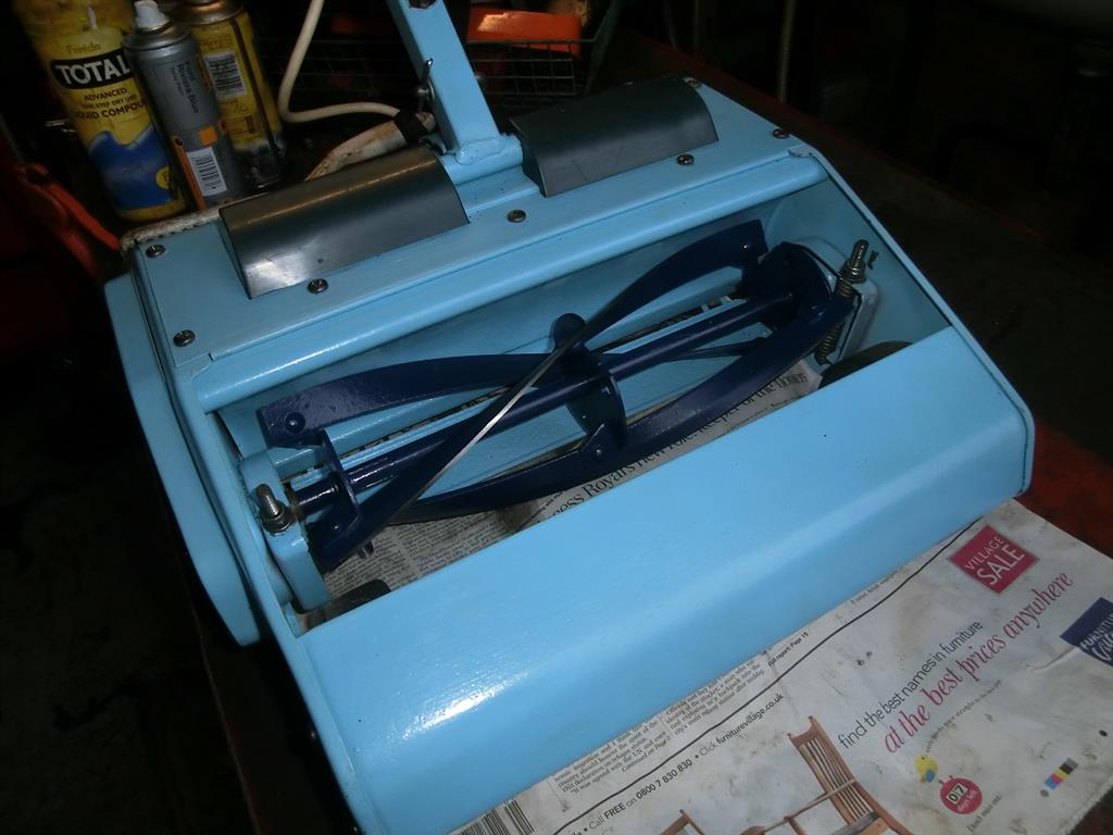

alanParticipantThe Qualcast E30 of my childhood!

Nice to see the photographs of the old Concorde E30, incidentally that was the first lawnmower I ever used, I can remember the distinctive noise it made to this day.
