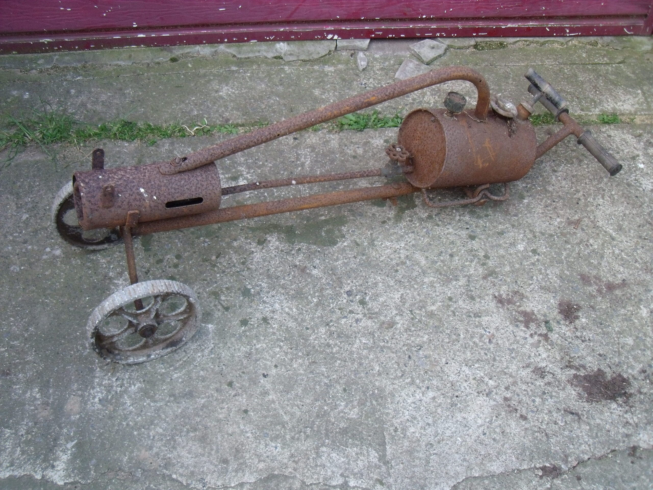

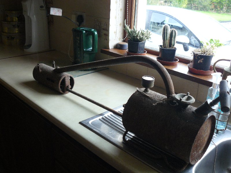

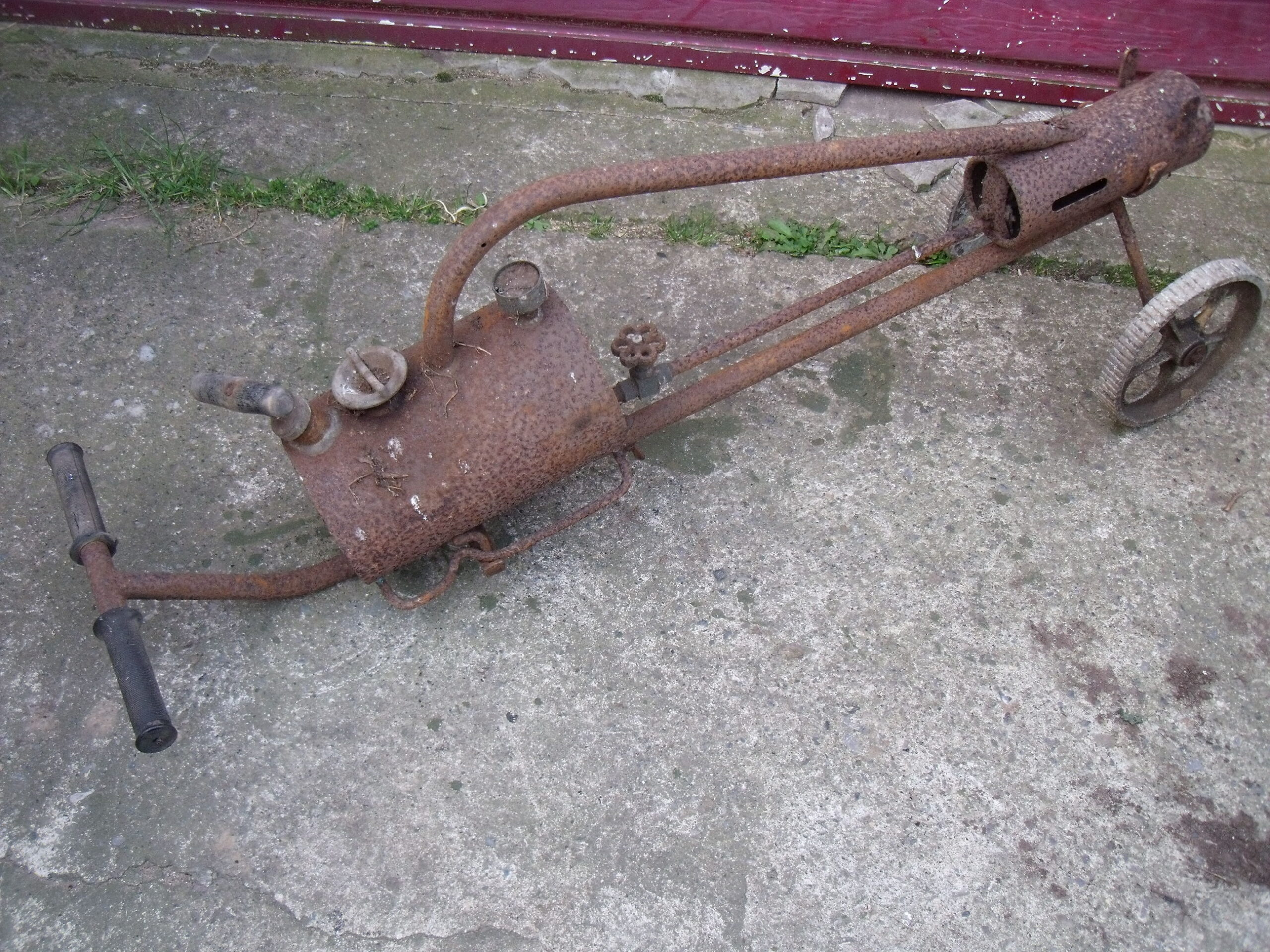

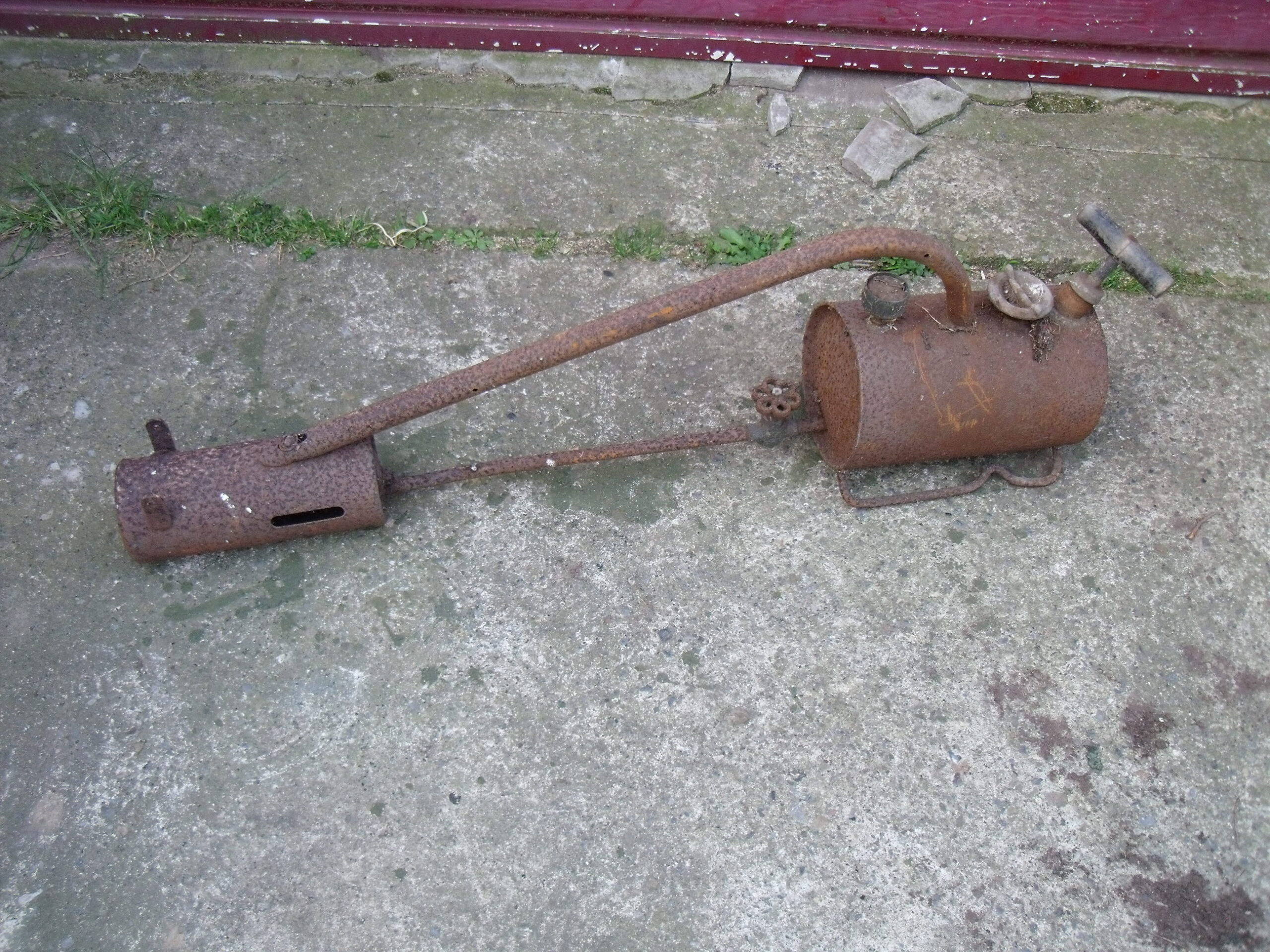

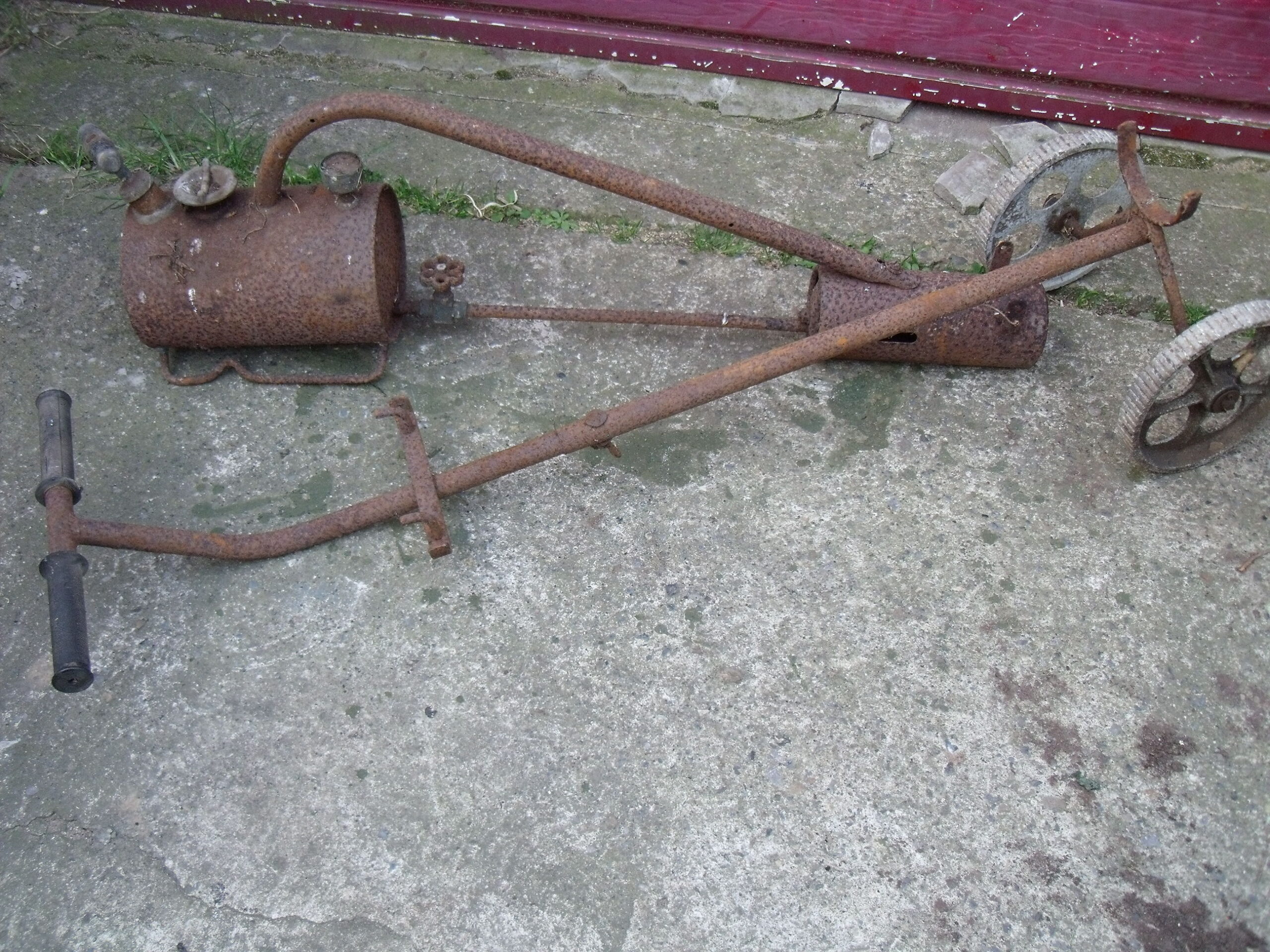

I think I have an old Sheen flame gun I bought at the weekend. No name on it that I can see and the little bit of remaining paint seems gold? I would like some help dating it. Correct colour, and how to fit a new pump washer as the old one is gone. The end on the punp does not seem to open like a primus pump to make a new washer. Im going to try include some pictures so please be patient! Cheers DaveOctober 20, 2013 at 9:16 pm #1560
vhgmcbuddyMemberI should mention I tried making a washer from building up o rings but it just pulled the fuel back out the top of the pump on the up stroke without pressurising the actual tank….

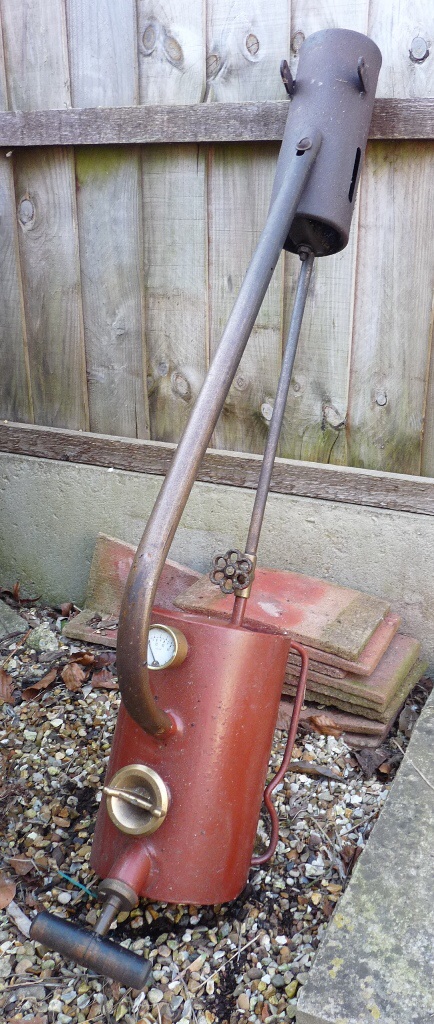

vhgmcbuddyMemberYou appear to have a Sheen x100.
See attached Dropbox downloads for full info. (if I’ve done this right). Also a photo of my Sheen X-100.
I’m not sure how to replaced the pump washer as my machine was fully working so have not opened it up. I’ll try to remember to have a look, but am away this weekend so not sure when this’ll be.

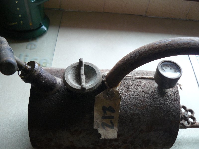

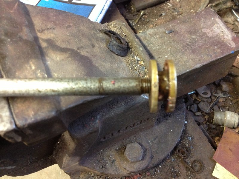

vhgmcbuddyMemberHi I had already seen those manuals on the old website. Very nice. However they don’t show how the washer goes on. On a primus lamp the end of the pump normally screws apart so you can fit the new washer between the 2 pieces. See my last photo. This one does not seem to screw apart and I am afraid to force it incase I damage it. As I said I put a washer into it but it sucked the fuel back into the pump tube so I am going to take out the non return valve tomorrow and see is it stuck open. Any ideas on the original colour would be appreciated as it seems to have remenants of metallic gold and not the usual sheen orange I see on the web. I’m wondering does the washer being rubber from the looks of the ones on eBay just stretch over the brass end ? Thanks for any help!

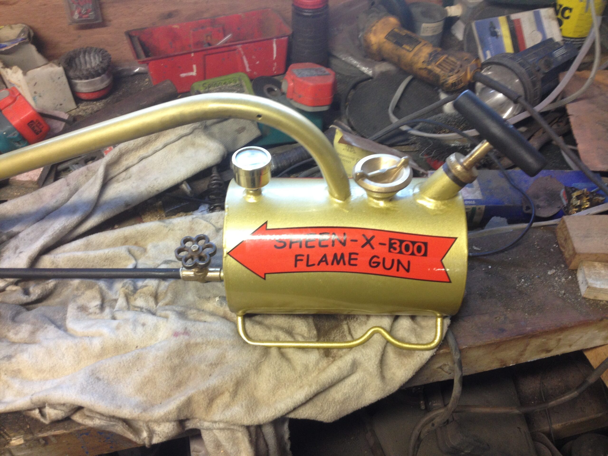

vhgmcbuddyMemberI have ordered a new set of washers and a new jet and non return valve . I have stripped it down and unblocked the full length of the burner tubes. Going to start prep for paint next. Original colour ideas please ? I’m thinking its a sheen 300 ?

January 2, 2014 at 2:03 pm #4731
vhgmcbuddyMember
Just ready for Titch to produce some magic de cals!January 22, 2014 at 8:51 pm #5363
