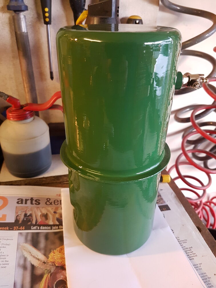

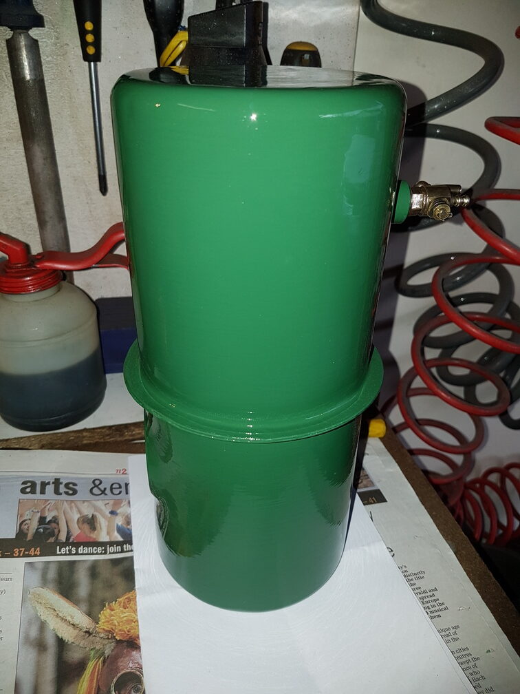

wristpinParticipantFinished painting the fuel tank this afternoon. Small dents were filled and then etch primed, before top coat was brushed on. I will be clear coating the fuel tank with a 1k lacquer, as the enamel is not fuel resistant!
Out of interest, what 1k lacquer have you found that is fuel proof – I’ve yet to find one! Even powder coating does not seem to fend off ethanol adulterated fuel.
February 9, 2017 at 6:06 pm #24339
darmic1ParticipantHi Angus
The brand is Pro-XL, supplied by Automotive Paint Supplies. I believe they are mainly in the south of UK, I have a branch 5 minutes from me. Have used these products on all my restorations and used the 1k laquer before on my Alloys when I refurbed them. It lasted 7+ years on them before I sold the car. Oil/salt/detergent/acid resistant! Have also used it on fuel tanks before on the 1st Gem I restored. I used waterslide decals and clear coated the fuel tank to protect the decals. The tank still looks like new despite being 6 years ago and been out in all weathers! I would say with confidence it is resistant to fuel, however prolonged or intense direct contact might have some damaging effect. Splashes and spills just run off and evaporate…… I’ve even wiped spills without damage occuring……February 9, 2017 at 9:56 pm #24341

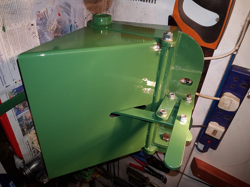

February 10, 2017 at 10:55 pm #24356

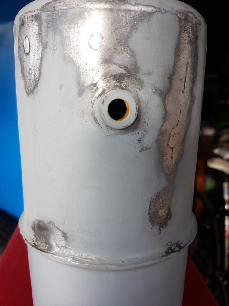

darmic1ParticipantThe original fuel tank was rather rusty inside, after it had soaked in some rust eating acid it had become a sieve…… So I etch primed it just to prevent flash rust forming. I then soldered up the 13 holes! Filled the worst of the dents and primed it again. It’s now been treated with a good dose of POR15…. It will do as a ‘spare’ tank, as I have numerous machines with this type fitted!
