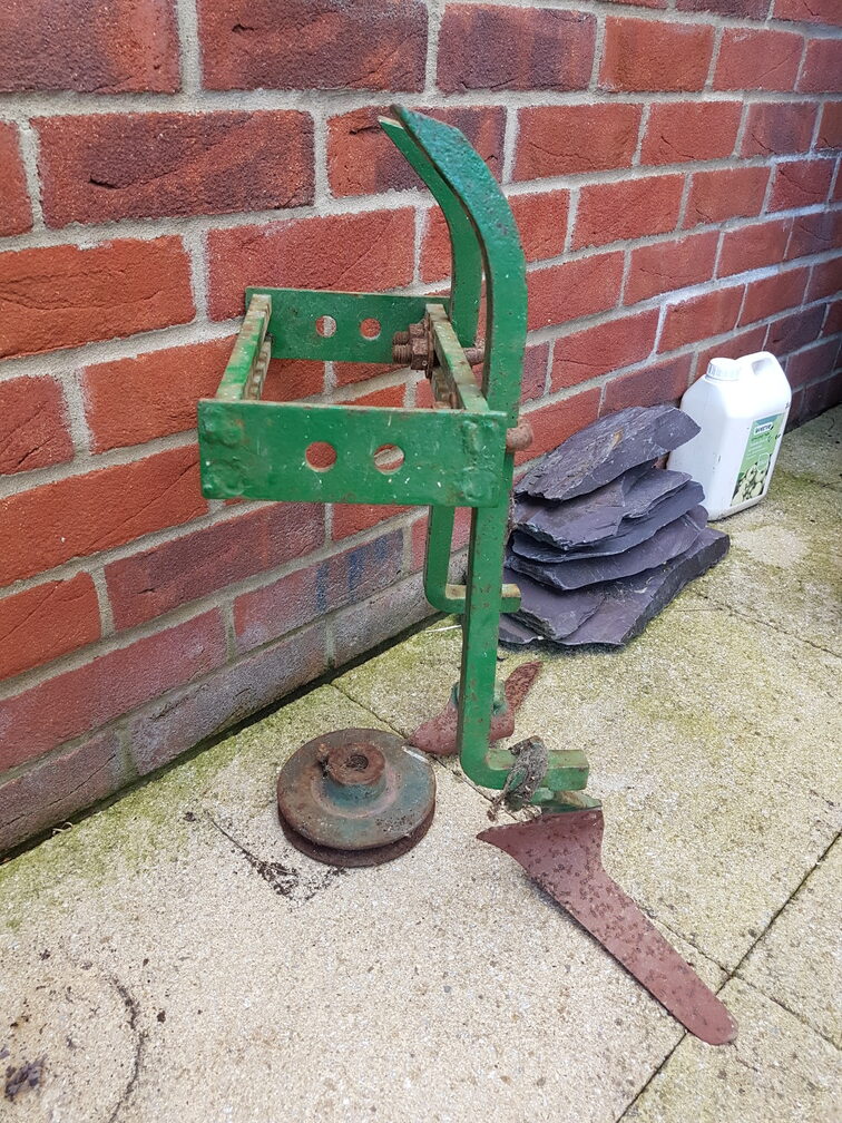

    I’ve decided to make use of this machine as a working exhibit. I will however give it a makeover, so I made a start on the attachments due to space and storage restrictions. I’ve broken everything down to component parts, and took it all to the shot blasters. It’s been etch primed and I’ve decided to brush paint this one, as it will be easier to patch up, should it get damaged during use.

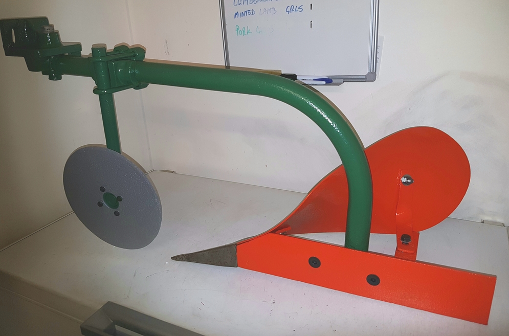

    I’m using brush enamels mixed to match the original colours. The green is BS282 Forest Green and the red is BS593 Rail Red. The paint itself covers really well, goes on quite thick and flattens out leaving virtually no brush marks……
    #23852
    darmic1
    Once all the bits were painted and dry I made a start putting it all back together……

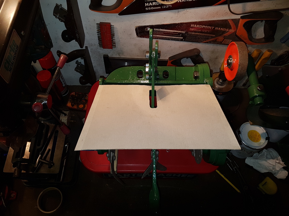

    darmic1

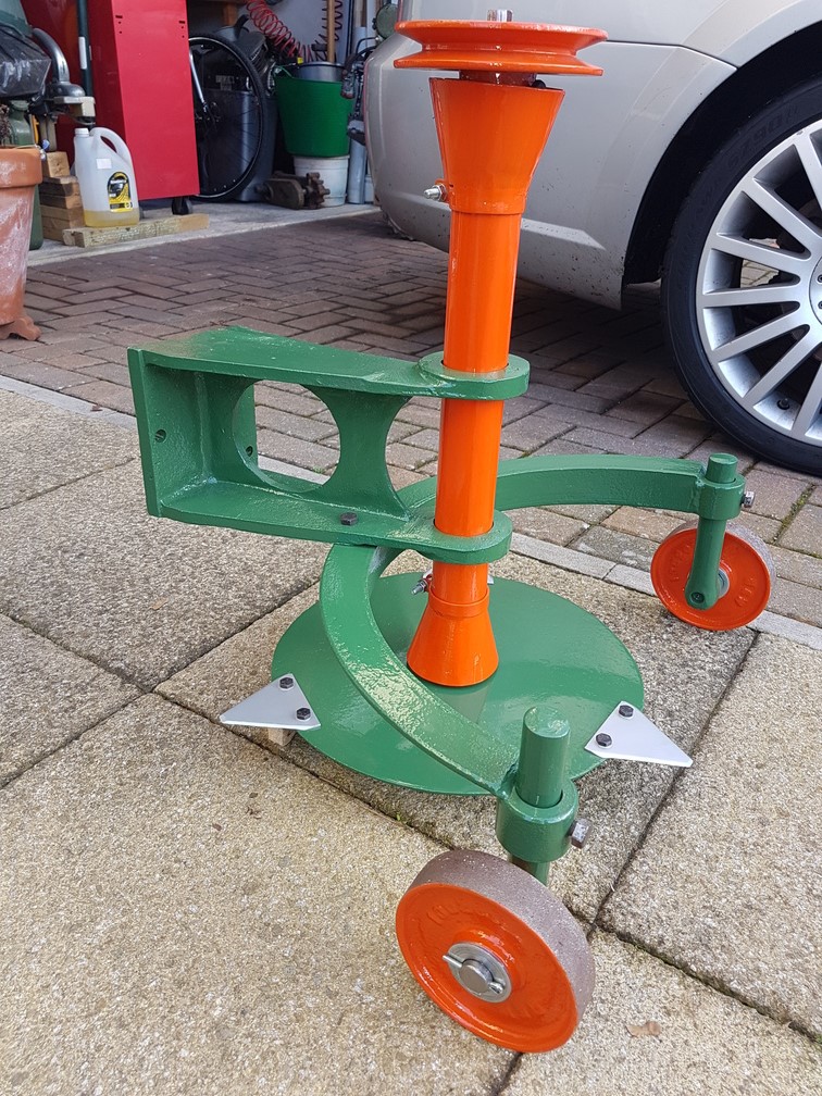

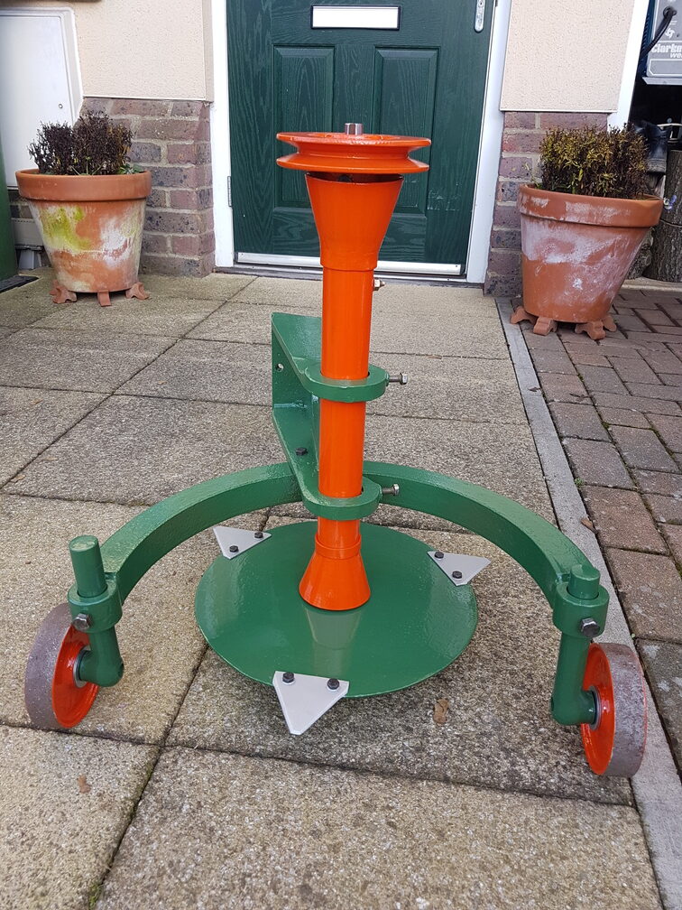

    The mower was missing one of the safety guards. I made a cardboard template, marked out the steel and cut it out. Rolled the steel by hand to get the conical shape, welded it together and made the mounting bracket……

    Once painted and dry I reassembled the rest of the mower……

    darmic1

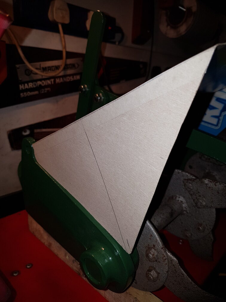

    I have made a start on the rotovator attachment today. Have fitted new modern nitrile seals to the rotor shaft replacing the original rotten felt ones, also fitted a new end seal to protect the shaft end and bronze bushes. Next job was to re-make the missing rotor cover. I made a cardboard template using photo’s from a ‘youtube’ video as reference. I will get the steel cut tomorrow….

    Progressing well, you cant beat using CAD (cardboard aided design).

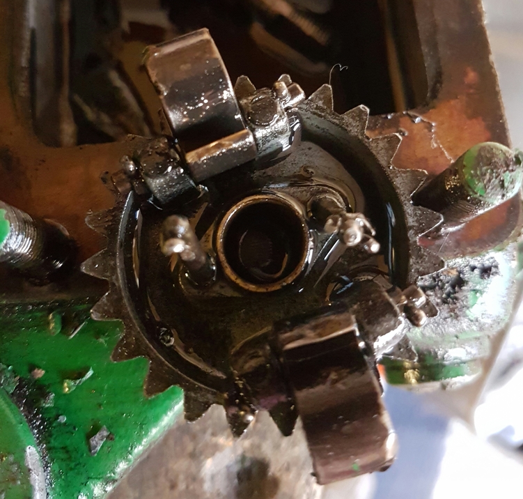

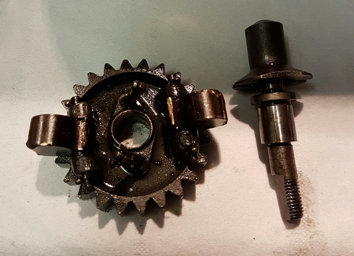

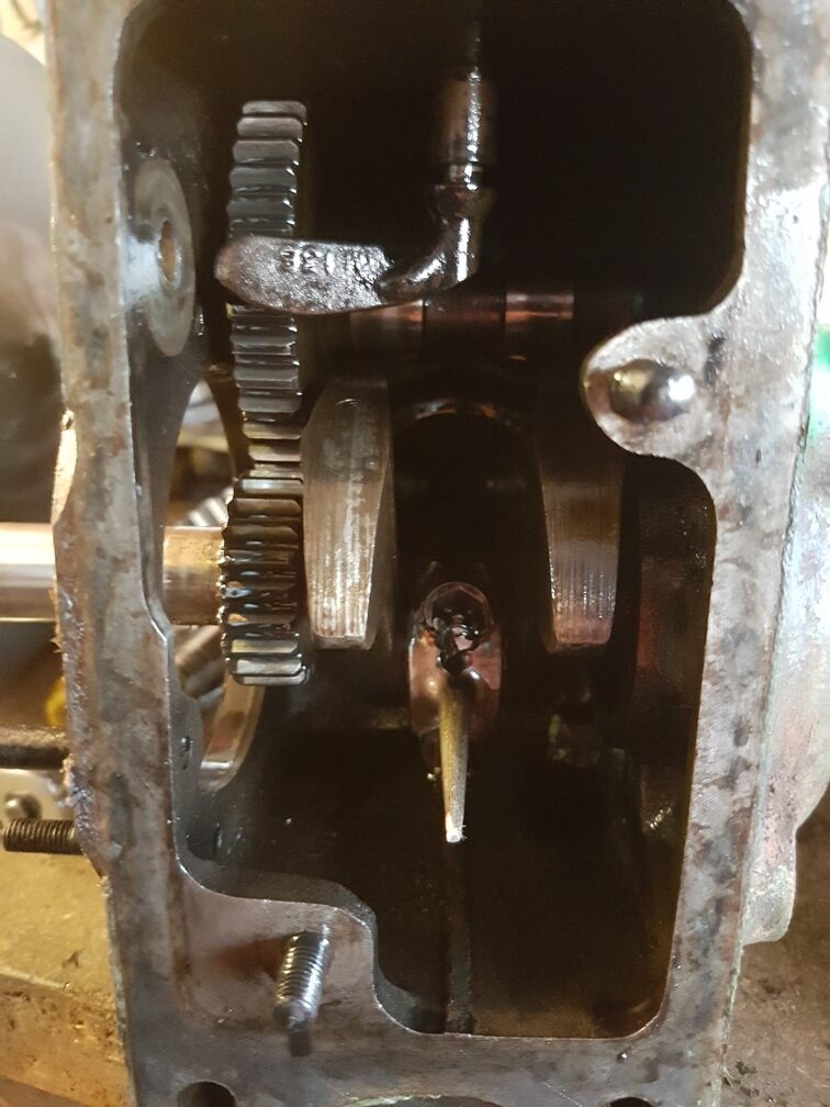

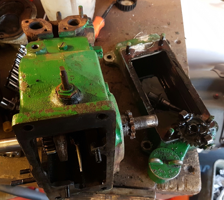

    Made a start inspecting the MK12 engine from this machine yesterday. I wasn’t too concerned about the internals as I had previously had the head off to check the piston and valves etc. I had also had the engine running with just a squirt of fuel, enough to make it run. However, I wasn’t prepared for what I found when I pulled the sump off……. 2 rather large components sitting in the oil at the bottom! these bits were the governor gear and its shaft……. I had previously noticed the governor arm was broken where the spring connects, but didn’t associate that with anything more serious. It would appear that the governor arm has broken whilst the engine was running, the engine has then ‘run away’ ungoverned causing the counterweight gear to self destruct! Thankfully nothing more serious than a few light scratches to the crank lobes has resulted, the crank itself, con rod and piston skirt are all intact and serviceable. Thankfully I have a donor engine I can cannabalise for the required parts!

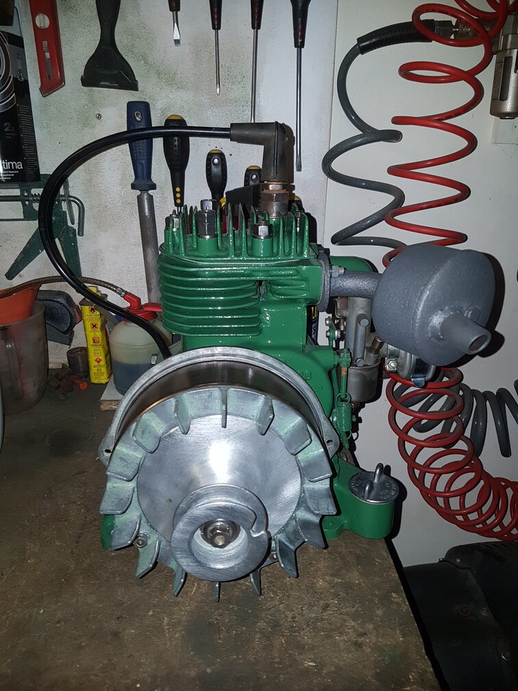

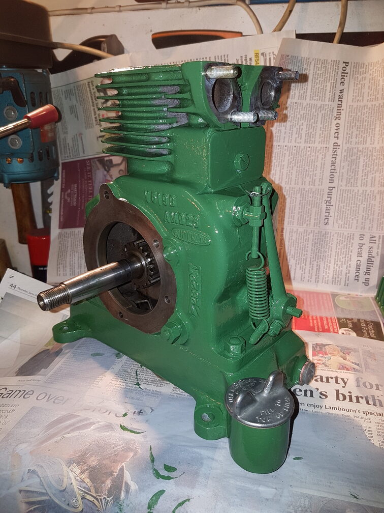

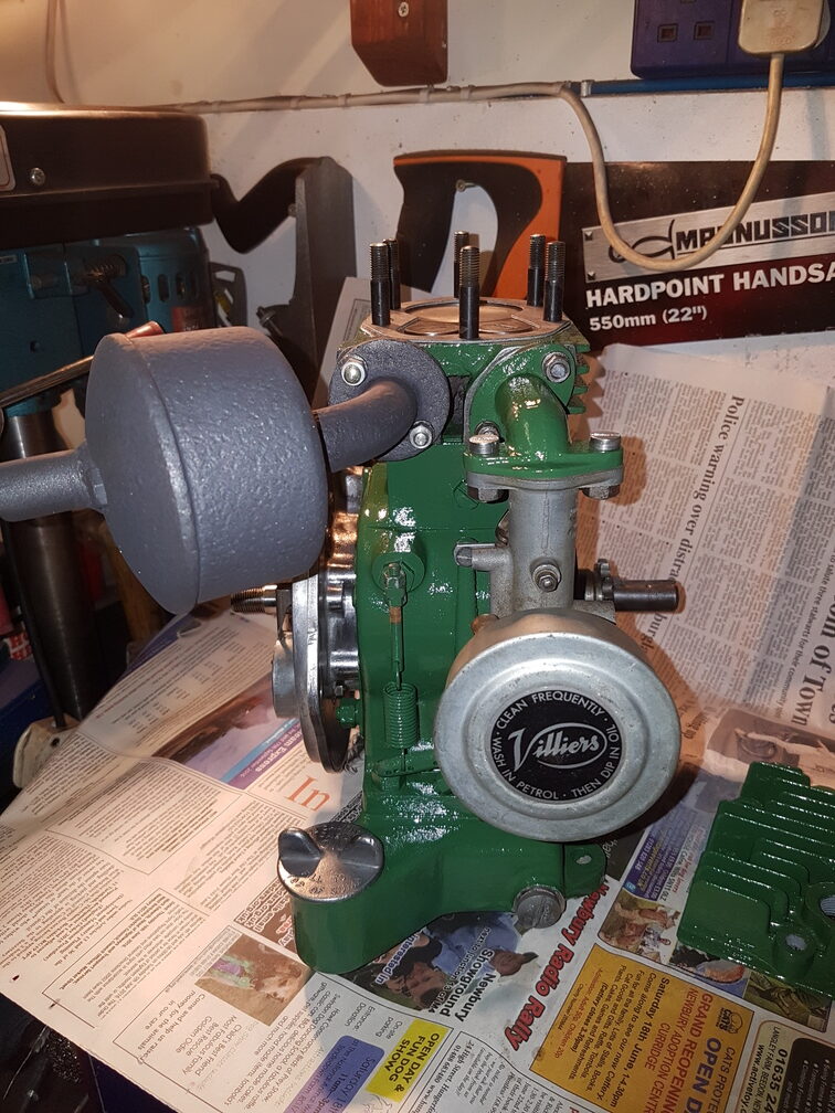

    darmic1

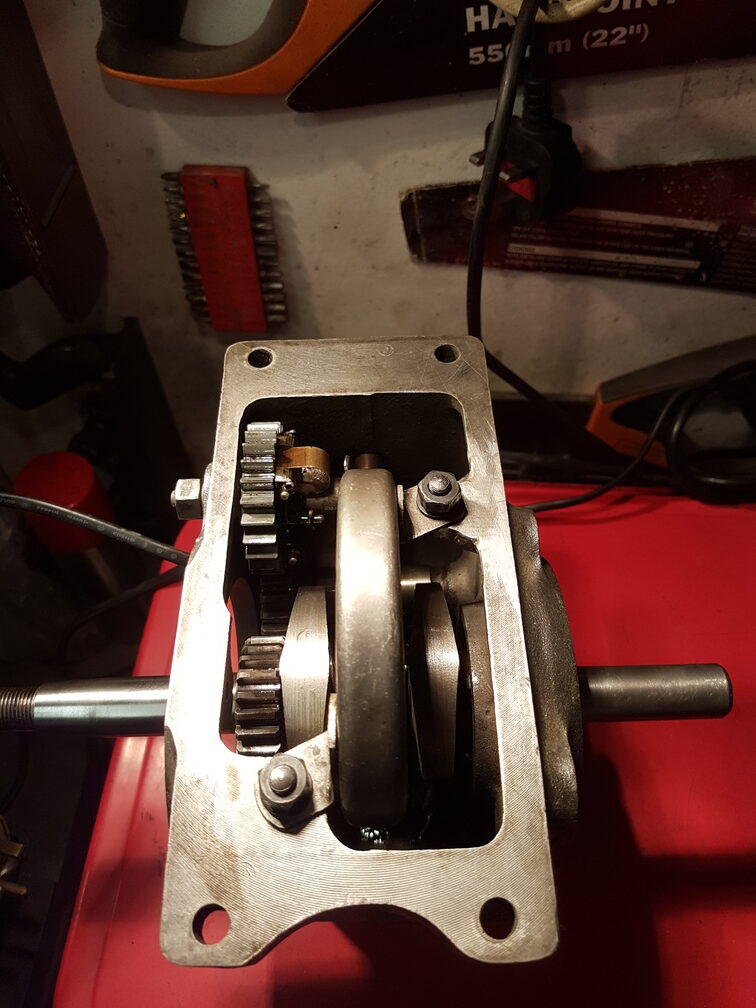

    Have now rebuilt the engine using governor parts from the donor engine. stripped, primed and painted it. Repaired the exhaust, rebuilt the carburettor and fitted the new air filter.
