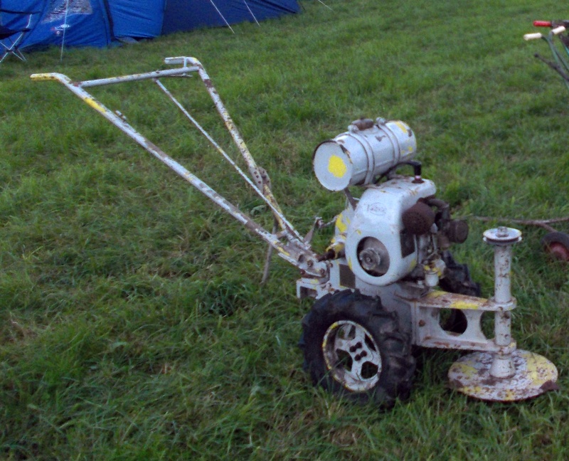

    #25692
    This one was shown at Lanlivery in Cornwall in 2013, also with no belt!
    #25701
    Thanks for that Will-haggle, I couldn’t find a picture with a belt on either.

    stevewoollas
    From machines I have seen on the rally field I think the only thing missing is the belt. The vee belt fits in a twisted foremat rather like a 90 degree figure of eight (if that makes sense)–Steve
