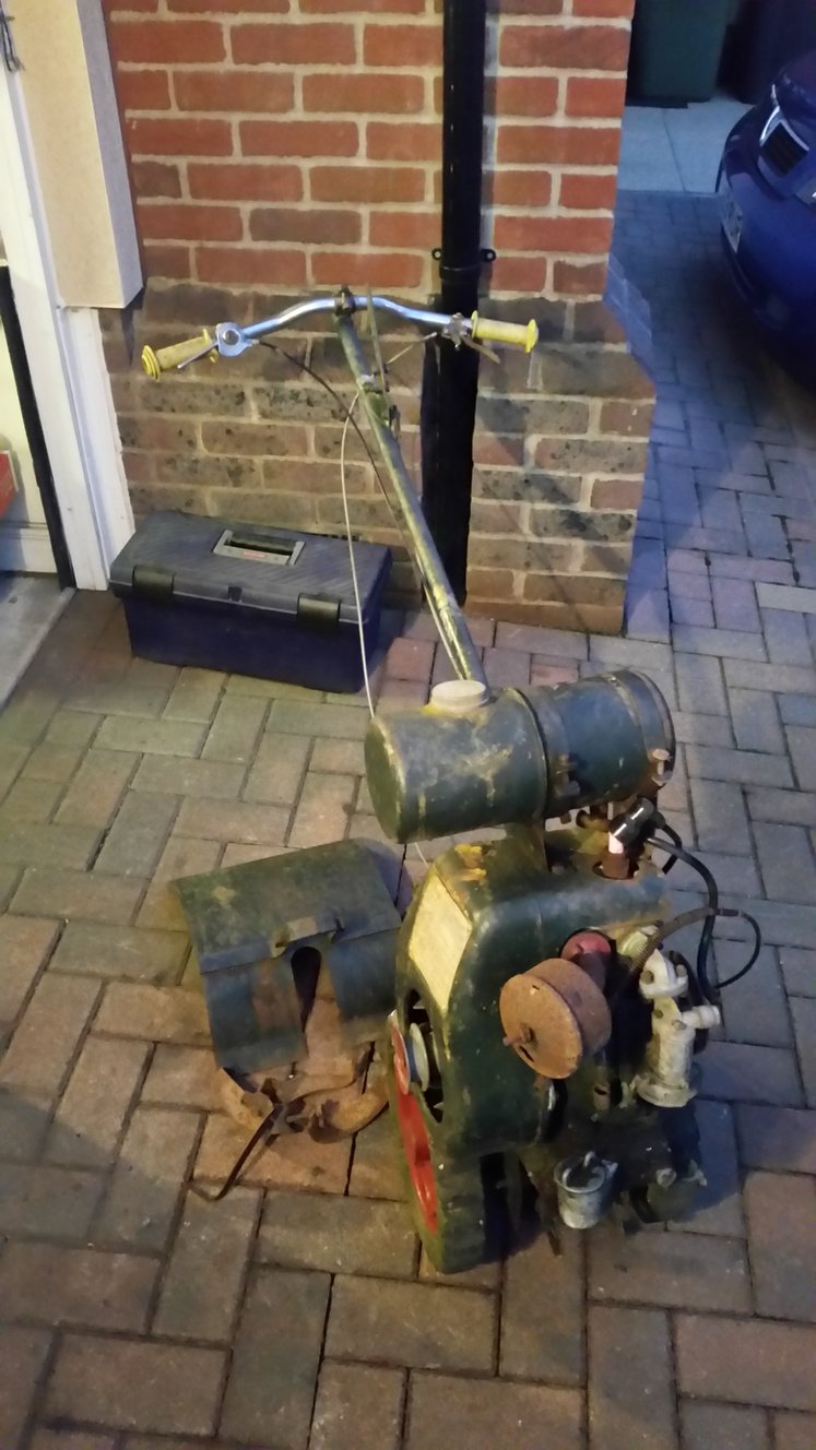

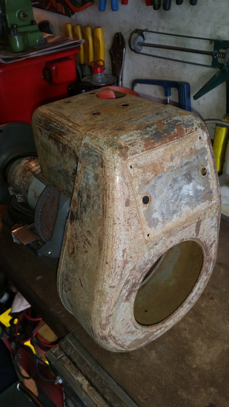

Have just acquired this machine. It will require some work to get it back to, A original, and B working! I was informed that it last ran about a year, 2 years ago? A previous owner had replaced the either missing or broken handlebars with something borrowed from a child’s bike??? The engine turns but has low compression. The B10/1 carb is broken where the air filter clips on. S1G, Gareth has already offered a replacement for that. All the cables are seized or broken. Belts are missing, as is a complete set of blades from one side. The good news is the tin work is solid, rotor cover is only surface rust, the gearbox turns freely as do the rotor shafts.
I do want to save this one, get it running and then restore it. So if anyone has any spares going for one of these I would be extremely grateful.

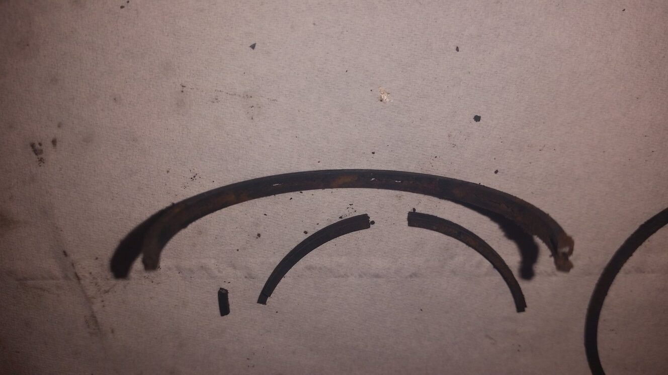

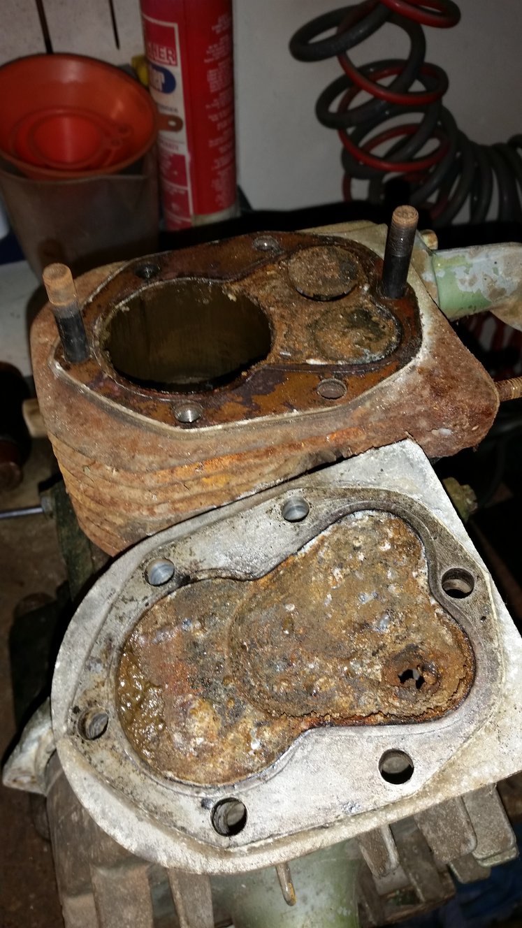

darmic1ParticipantMade a start stripping down the Mk12 Villiers on this machine. I was a little surprised to find the internals of the engine in this condition, given that the machine was supposed to be running 1-2 years ago. It almost made me wonder if it was beyond repair? There was some serious jellified rusty goo in the cylinder and head. the piston rings were corroded in the piston, the exhaust valve seat had some of the worst pitting I have ever seen and the re-buildable ‘Lodge’ plug base was corroded into the head.
I eventually teased the rings from the piston, unfortunately in pieces……. Had the valve seat re-cut and cleaned the detritus from the remaining parts. Am pleased to report that the rest of the internals are reusable.September 24, 2015 at 9:13 am #14567

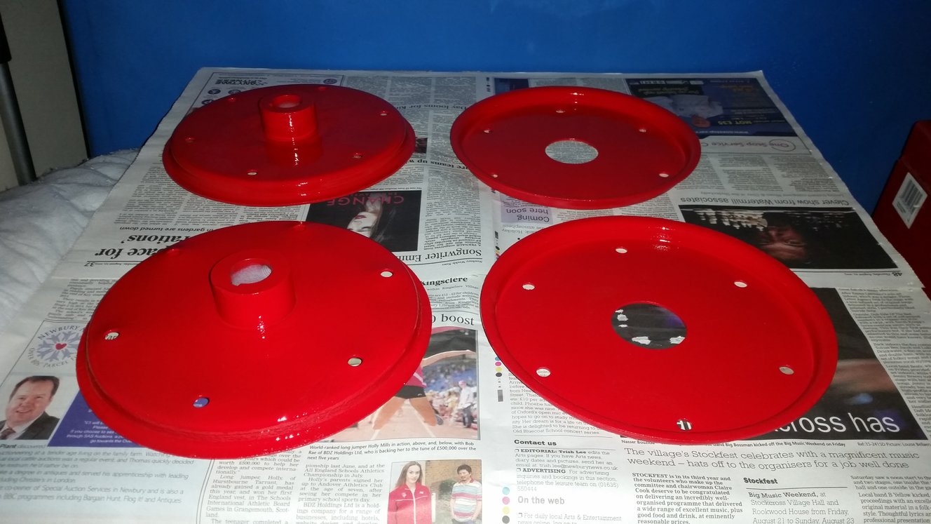

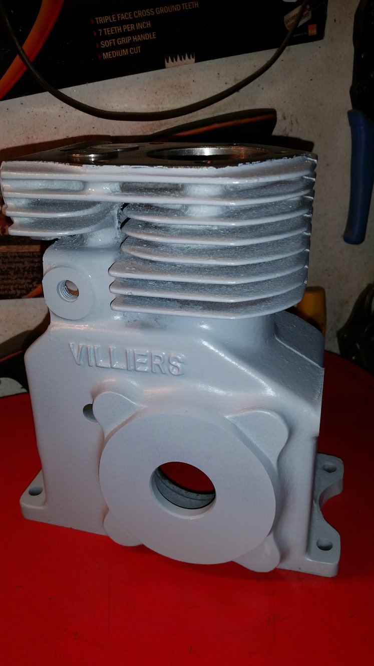

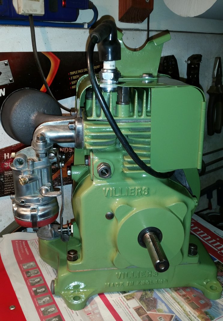

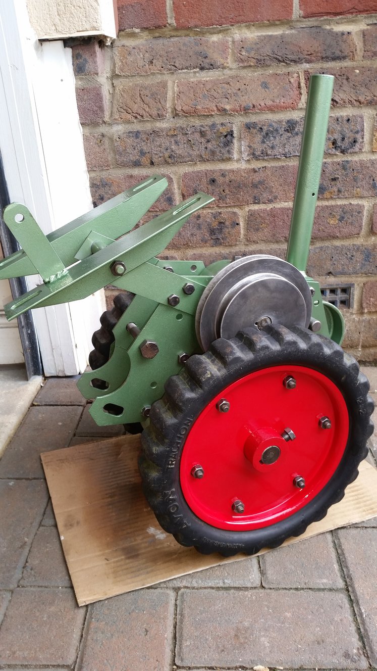

darmic1ParticipantI forgot to put the rest of this restoration project on here!

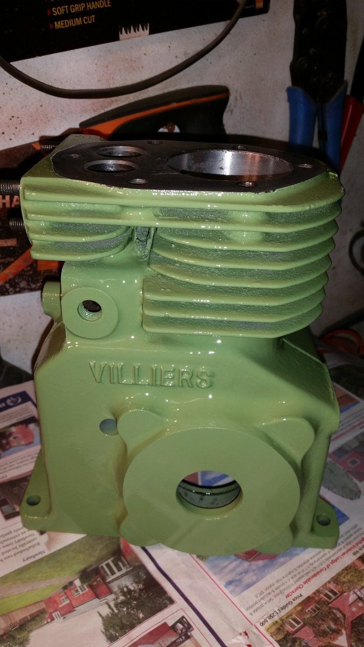

So, here goes…….

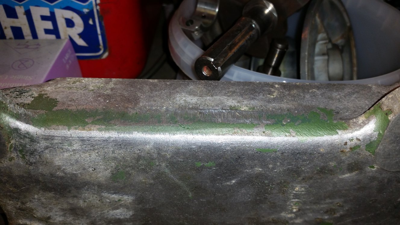

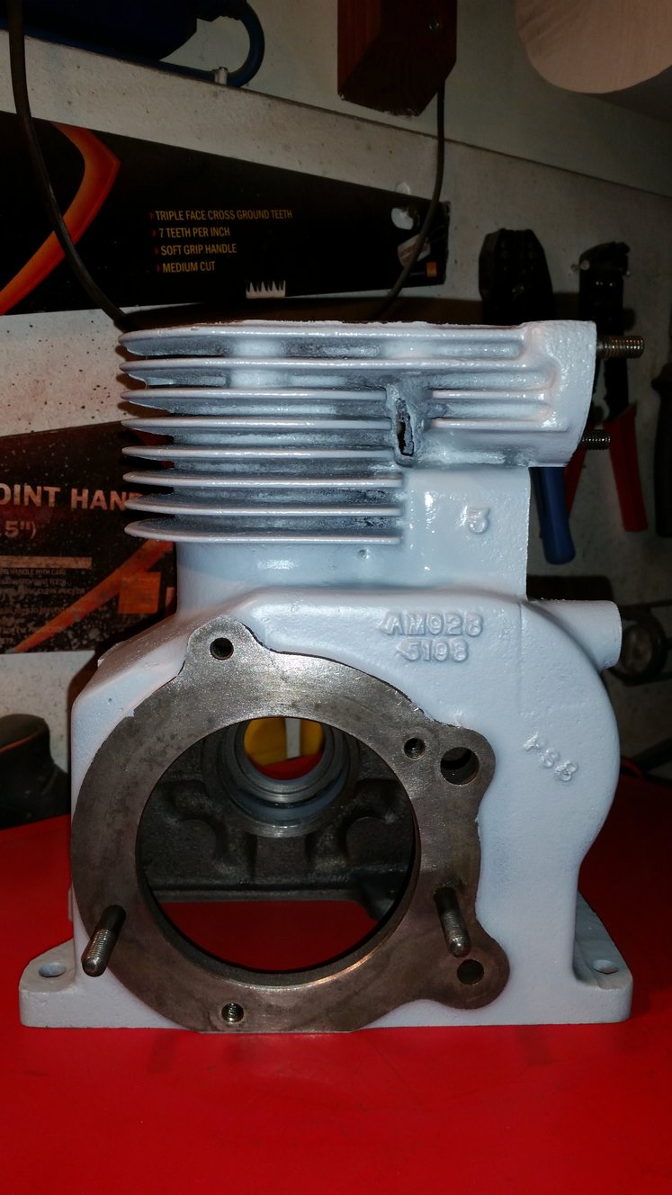

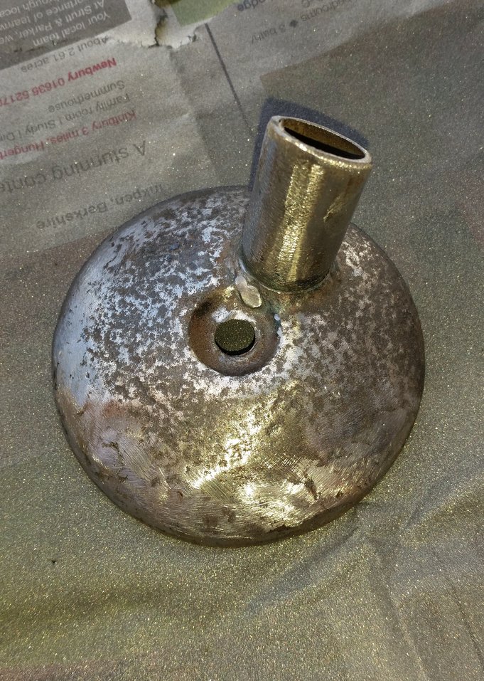

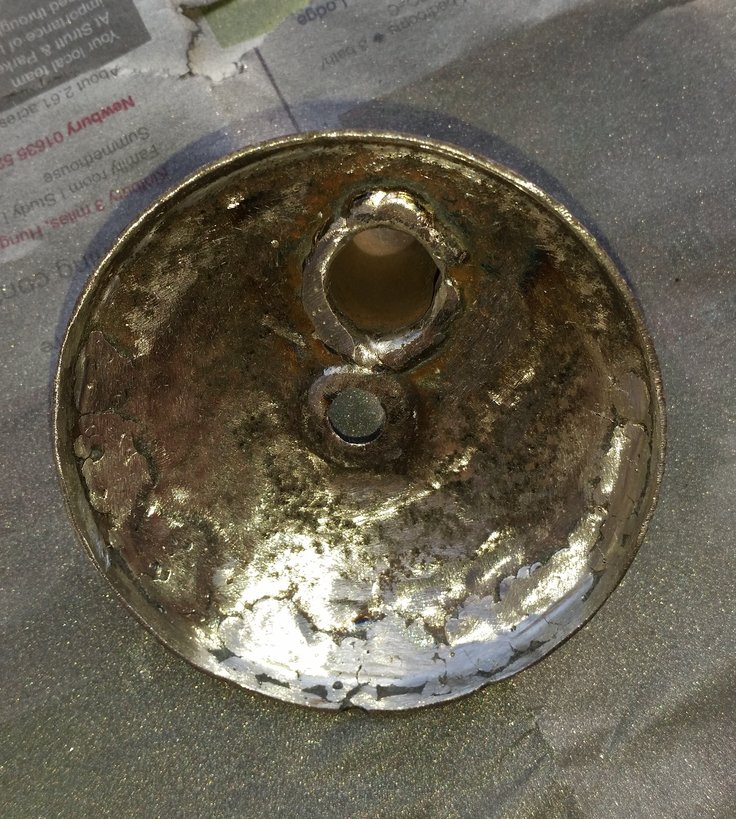

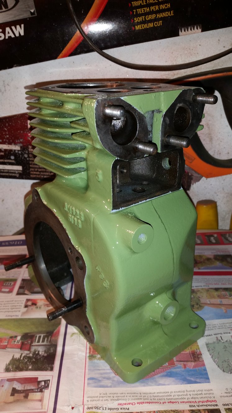

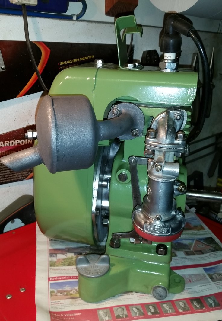

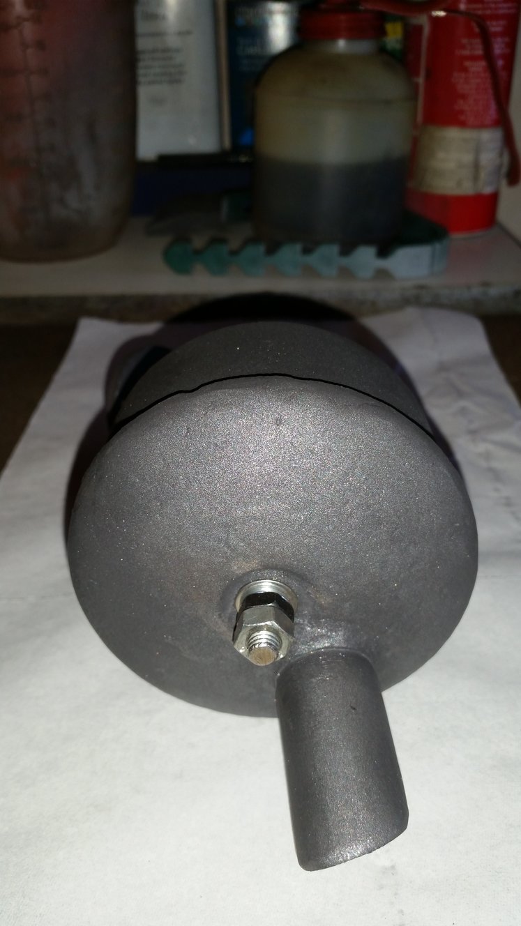

I got the engine back together, to a point where the points could be set ready for the flywheel to be timed and tightened. I then made a start on welding the holes in the rusted exhaust. I ended up chasing a few of the holes around until I was able to plug them totally. Here it is once welded and then again when painted with heat resistant exhaust paint.February 16, 2016 at 12:51 am #19532
darmic1ParticipantHmmmm! I see the photo’s still do not run in sequence, despite being chronologically correct.

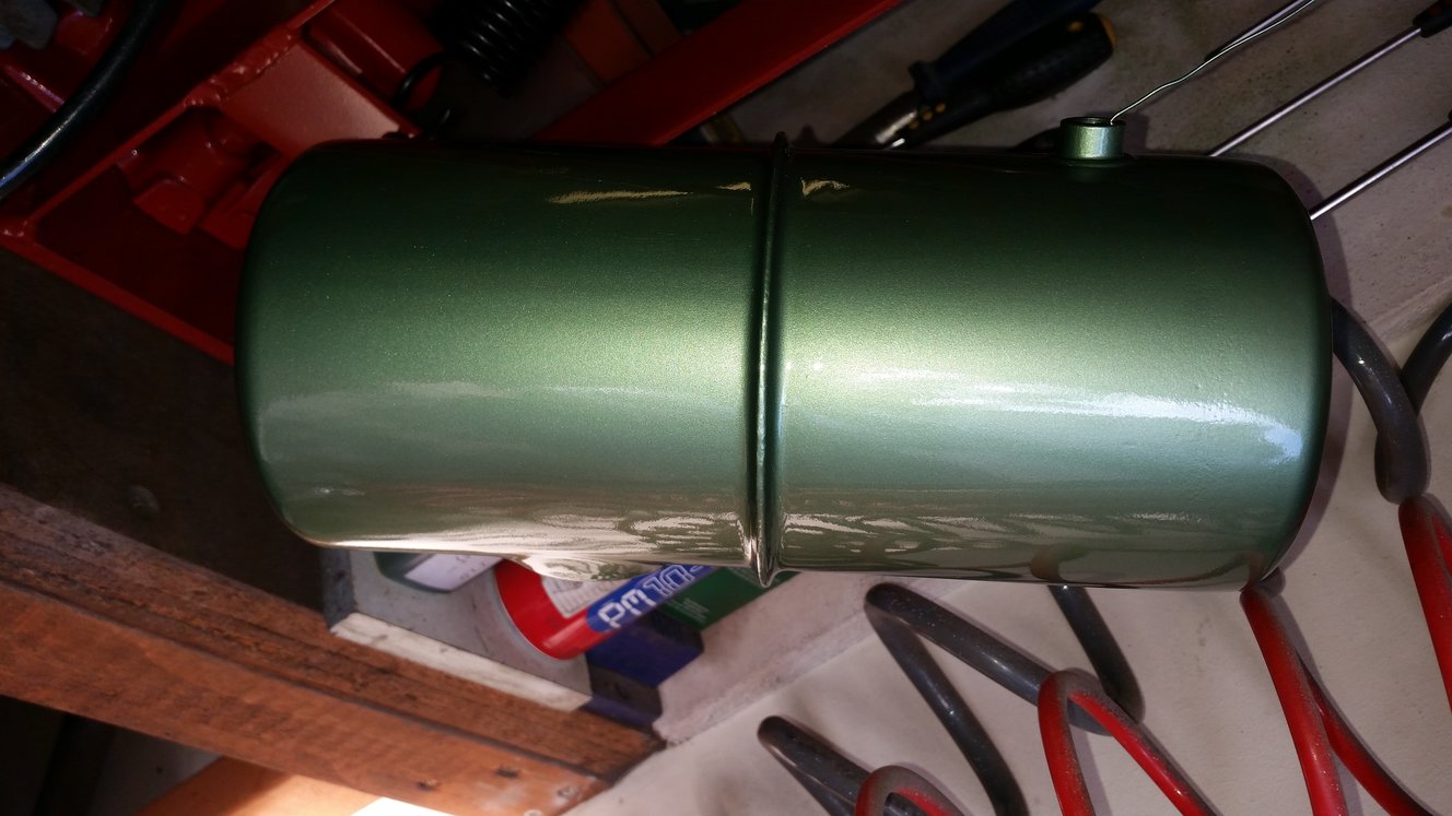

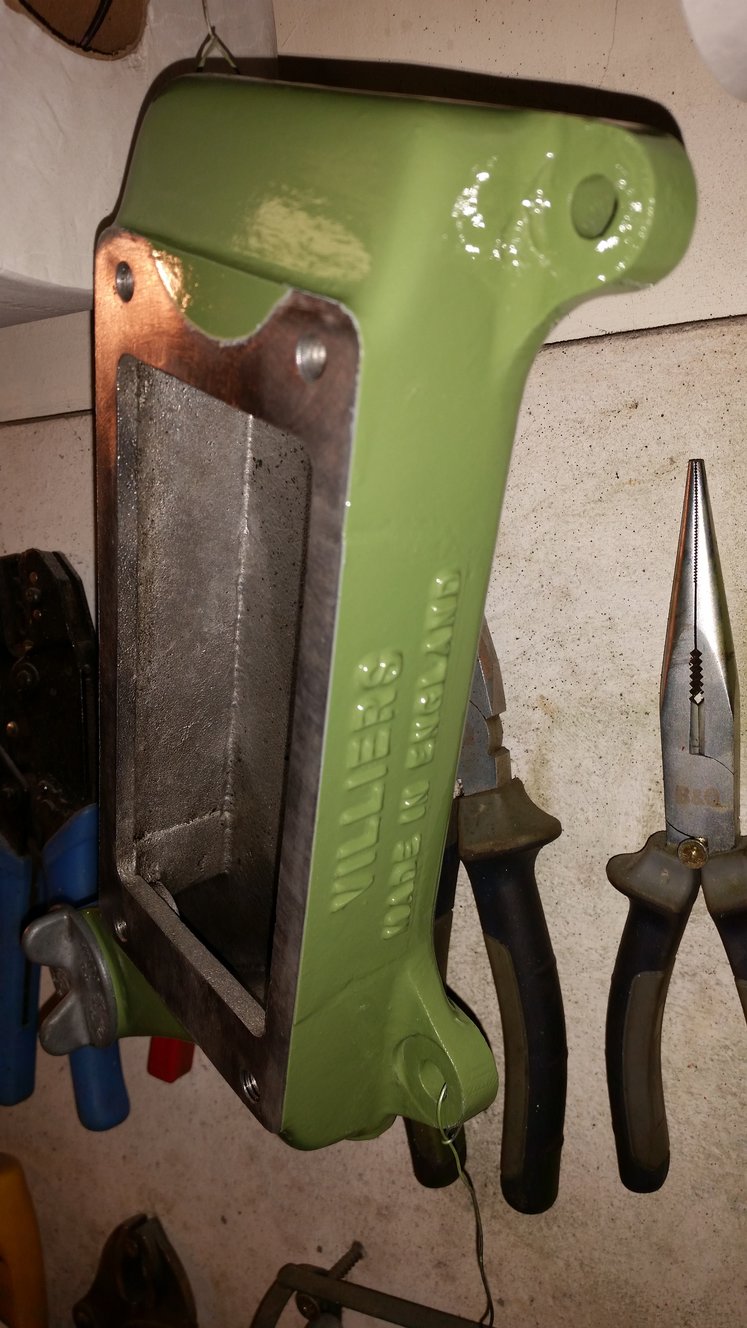

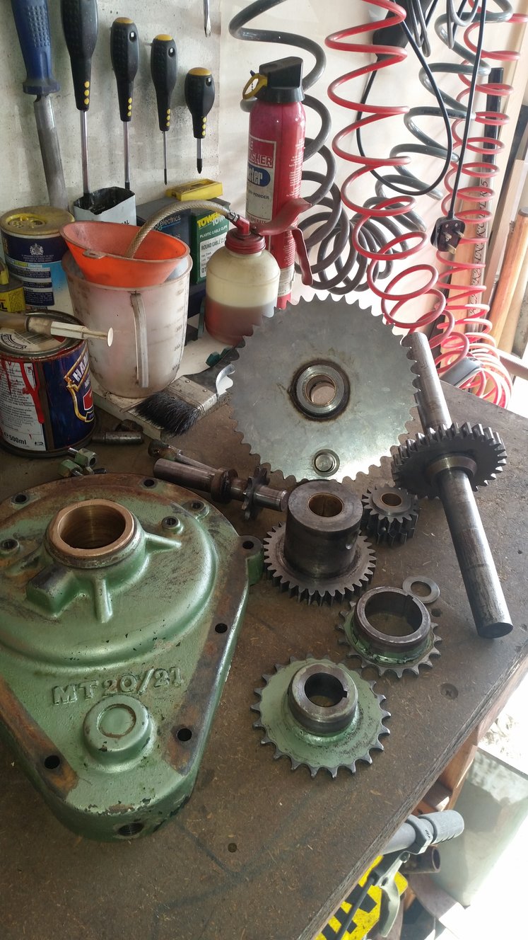

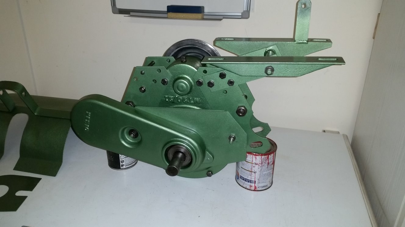

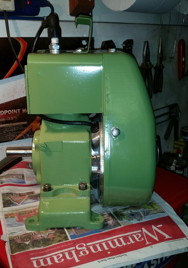

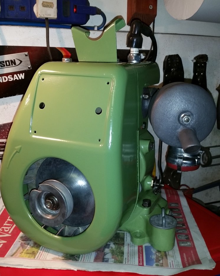

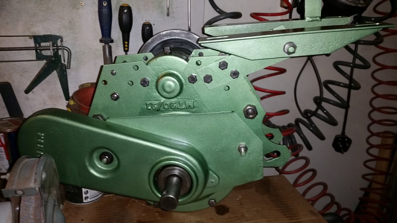

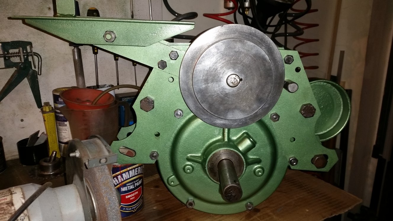

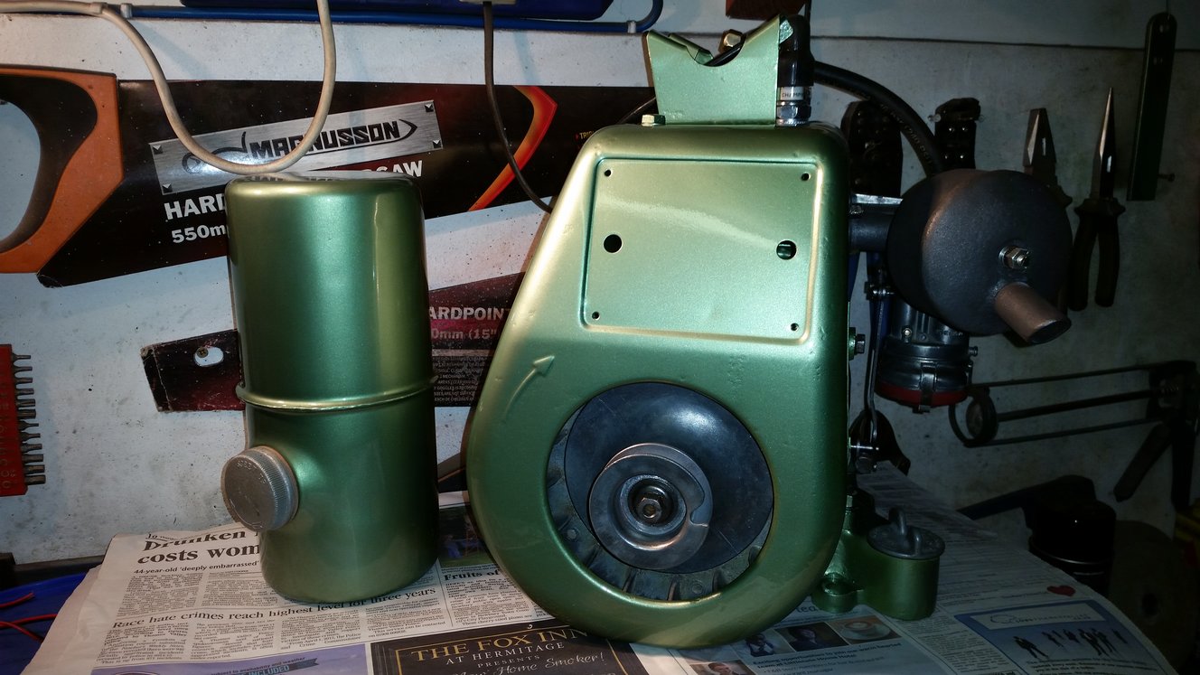

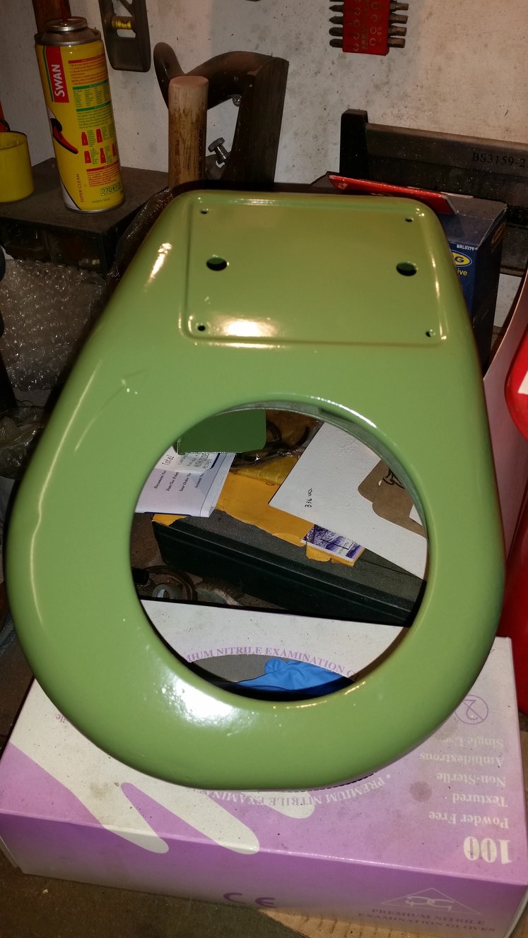

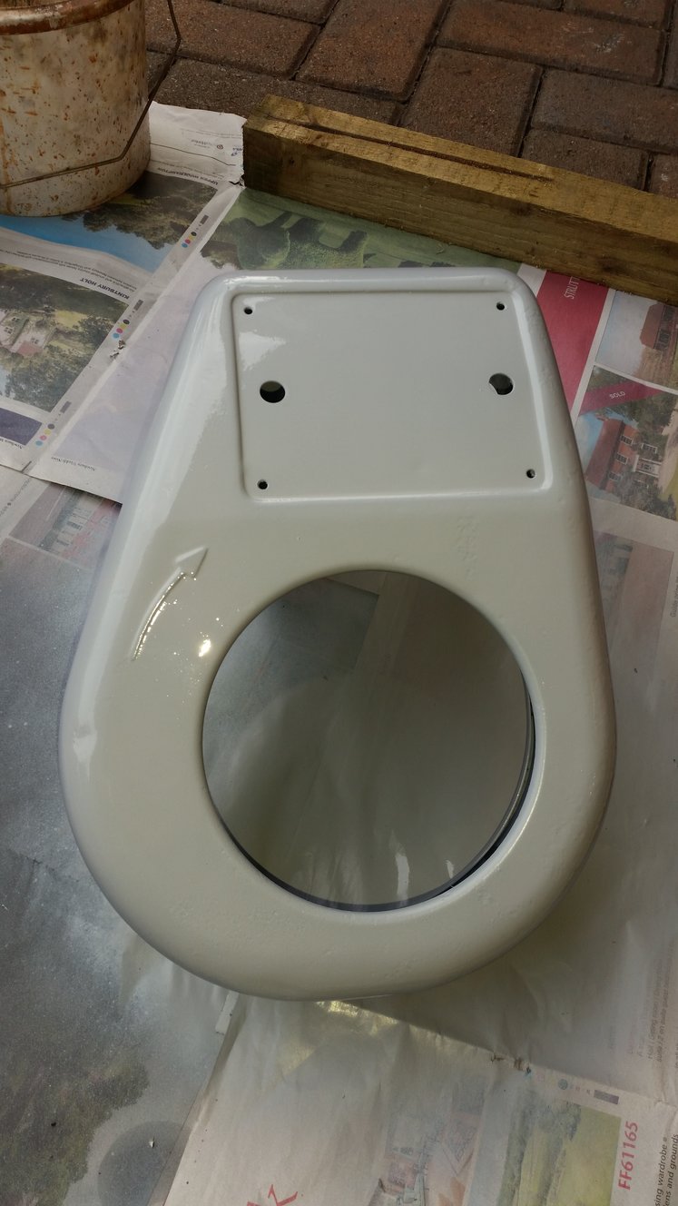

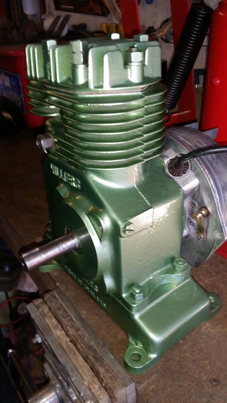

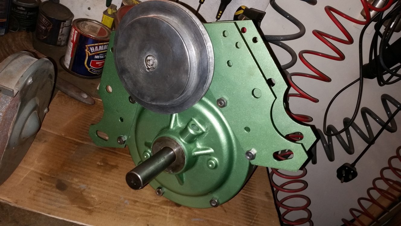

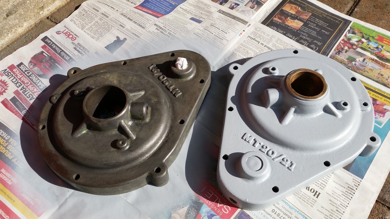

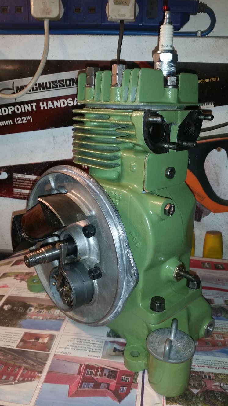

darmic1ParticipantOnce the gearbox was cleaned of all the dried mud and oil, I discovered the actual flat colour I was using was wrong. So a trip to my paint suppliers with a sample to obtain the right metallic colour. Of course this meant taking the engine back to where it could be ‘scotch clothed’ back to key the surface for a re-spray. Here is the gearbox case with the original metallic green found, and the engine following the re-spray.
