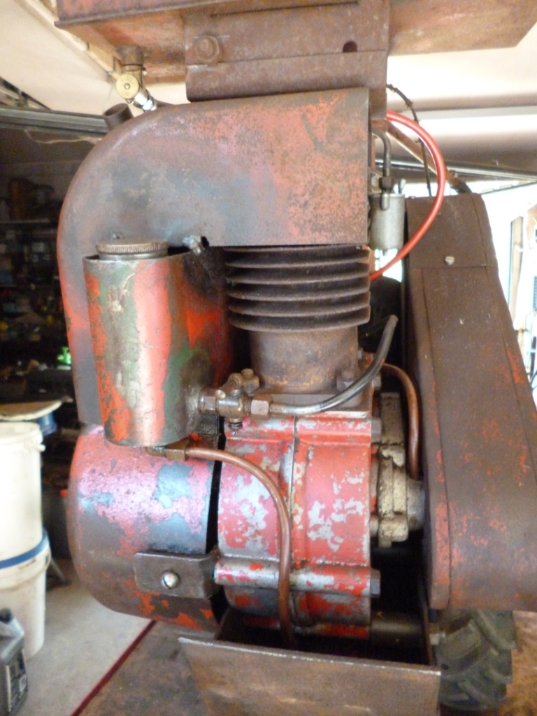

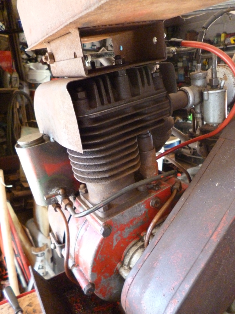

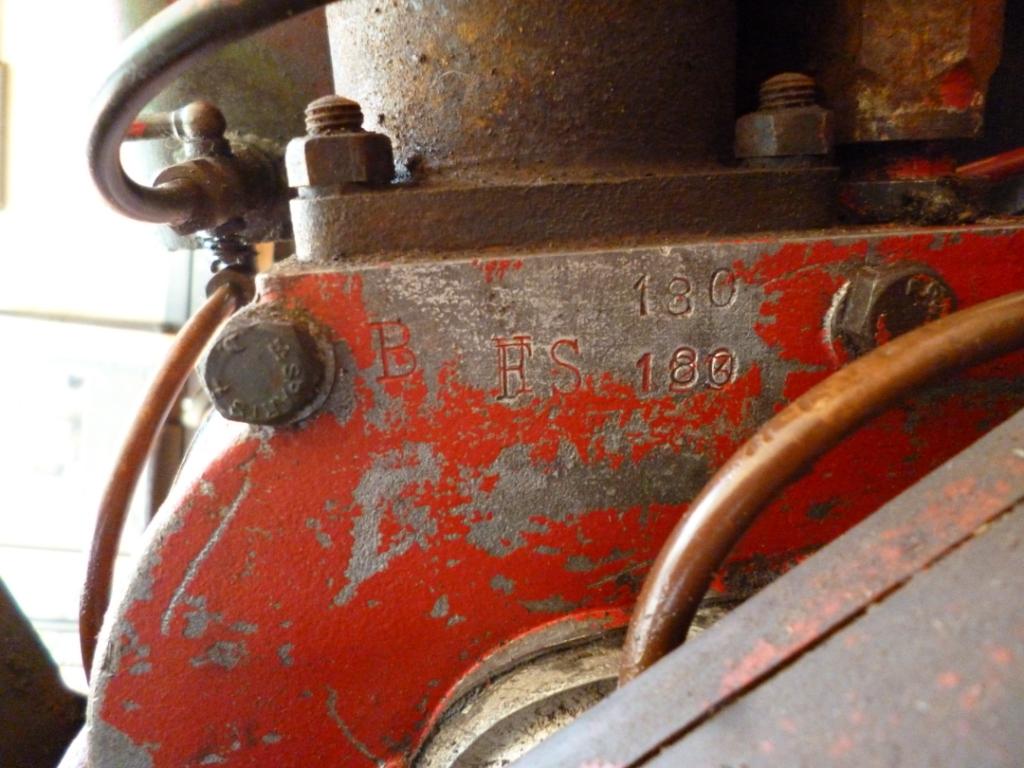

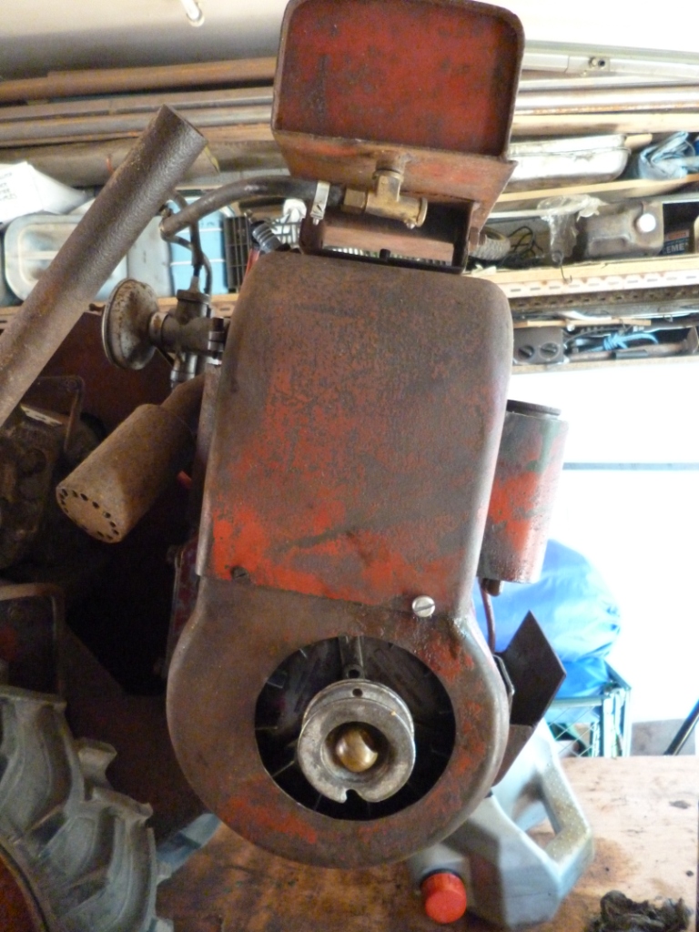

charlieKeymasterMy latest acquisition is an Emery rotavator. The engine has no makers name but I think it could be a JAP. 4 stroke, air cooled, dry sump. Magneto is a Wico FW880. Carb is an Amal. Bore approx 63.5mm and stroke approx 76mm. Any help identifying engine model would be much appreciated as would any information about the engine. The only numbers I have found on the engine are a B and what looks like FS or HS 180.

As far as I’m aware J.A.P. always had some form of stamping somewhere , whereby they could be identified , but like Stuart I would stand to be corrected.Andy.

trusty220KeymasterAccording to my Wipac manual the FW880 was only fitted to JAP 2A’s with clockwise rotation. I’m very confused now, because Charlie’s photo’s show an engine very similar to the 2A in layout, but it doesn’t look like the 2A that is fitted to my Trusty mower.

charlieKeymasterI took the Emery to the Lotmead event and one thought was it could be a motorcycle engine, but no suggestions as to make.
July 10, 2017 at 12:18 pm #25812
trusty220KeymasterI can see why you think that because it has a circular crankcase. I had an old JAP engine some years ago which came off a Ransomes mower of unknown vintage which was a similar shape, but it had J.A.P. cast into the crankcase just below the barrel..
