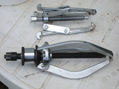

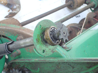

wristpinParticipantThe M in the Mk5M tells you that it’s probably a metric bearing . I say probably because it’s not unknown for machines to be “cut and shut” over the years and someone may have fitter an imperial bearing and holder at some poit. In fact your spare shaft assembly may have come from an imperial machine.
When you get the bearing out you may find the size imprinted in the outer race. If it’s imperial it’s probably an RL5 or RLS5. If it’s metric possibly a 1203 or 6203.
To get your good sprocket off without damaging it you will either need grips or a stilsons that are thin enough to grip on the boss behind the toothed part or devise a way of gripping the toothed part without damaging it. Having worked on dozens of Marqueses over the years I made a long bar with a bit of quarter plate welded to the end with four pins that engaged the teeth of the sprocket – spreading the load over four teeth.
A commercially available chain wrench or even a short length of chain wrapped around the sprocket and then gripped with stilsons are other options.
The bearing itself is a light interference fit on the shaft and can be removed with one of your legged pullers.August 6, 2014 at 8:20 pm #9577

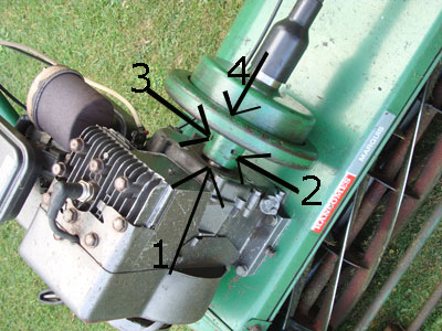

I did find the bearing 1203 and replaced both. It works.But now I have another problem:
There’s a knocking noise coming from the flywheel.
It seems that the drive shaft from the engine isn’t fixed for 100% to the flywheel.
if you turn the flywheel for a few millimetre, the drive shaft isn’t turning.
Screw nr 3 on the flywheel seems not to be tightened for 100%, when i tighten the screw
there no knocking noise anymore for 1 minute, then it comes back.
Changing the screw nr 3 and nr 2 doesn’t help.
How can I fix this?
Thank you.Picture expl:
1 – drive shaft
2 – screw
3 – screw
4 – flywheelAugust 8, 2014 at 3:06 pm #9598
wristpinParticipantGuess that it’s been running with the flywheel loose and that it’s flogged on the key. Hopefully the damage is confined to the key itself and not either the key way in the crank or flywheel.
Get a new key – you can probably get a length of “key steel” from your bearing supplier – and cut it to take up the full length of the key ways. Key steel comes in both metric and imperial sizes – the Briggs engine will be imperial and I’m guessing 3/16 square.
Offer up the flywheel and see if the movement has been eliminated. If it has, put a drop of Loctite on each grub screw and tighten hard.
If the new key has not eliminated the slop there are two options. The easiest is to get some Loctite Bearing Fit and apply it to the bore of the flywheel, assemble the whole thing and leave it overnight before running . Hopefully that will have done the trick.
The second option requires a bit more skill and work and is to make an oversized key to eliminate the slop . I haven’t got any here to measure but you may find that the metric equivalent of 3/16 is a bit oversize and will do the job but S**s law says it will be undersize. You may have to start oversize and dress it with a flat file until it’s a snug fit.
Let’s hope that a new standard key and Loctite does the trick!!August 8, 2014 at 3:41 pm #9599

hillsiderParticipantThe easiest route to get to the loose clutch flywheel is to remove the four engine fixing bolts taking care to watch for any pieces of packing that may sit between the engine and the bed plate. Then slide engine away from the drive shaft. You should the be able to see problem.
The advice given by wristpin is the exactly the way to go.

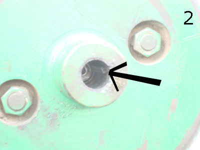

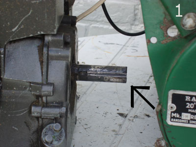

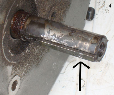

vhgmcbuddyMemberI removed the engine from te mower, and took some pictures.
The key seems to fit on the flywheel but not on the engine’s output shaft.
You can easily move it, it seems to small.
Is it a wrong key?I have a spare Marquis but with a BSA engine, I could take that key if it fits.
“picture 1”: the keyway on the engine’s output shaft.
It doesn’t seem damaged to me.“picture 2”: the key in the flywheel.

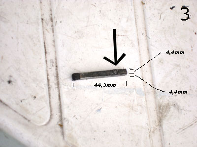

“picture 3”: the key with its sizes. 4,4mm x 4,4mm x 44,3mm,

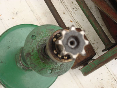

if you look closely you’ll see it has a bit of damage of the screw“picture 4”: the key on the engine’s output shaft.

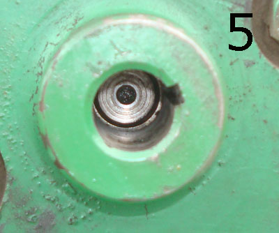

It doesn’t fit for 100%, it is a little loose, easy to move.“picture 5”: the flywheel cleaned.

wristpinParticipantYour BSA has a tapered crank, no key.
Everything else is covered in my previous detailed post.
Get a new 3/16″ (decimal 1875″) square key and go from there. -
