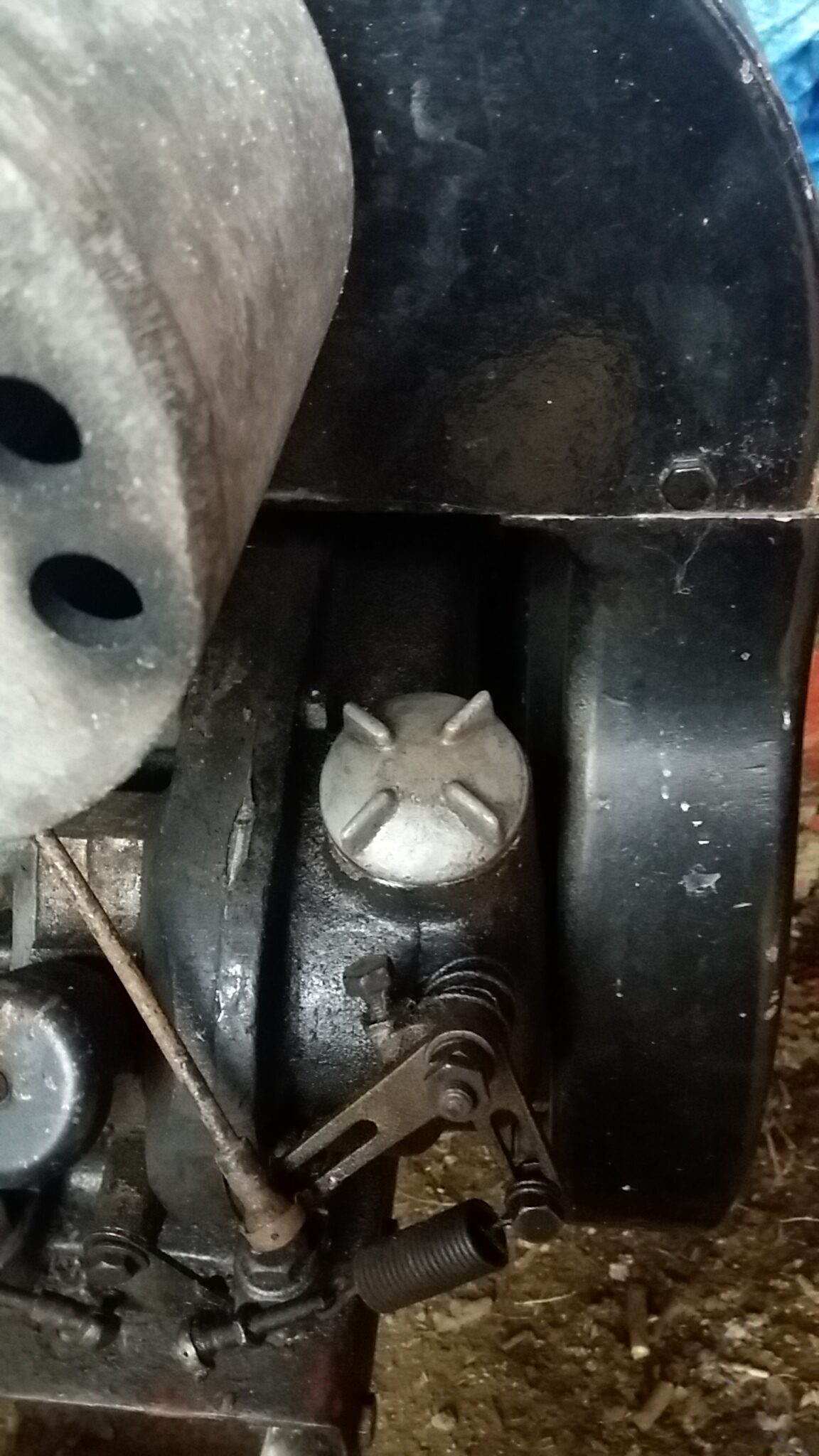

    My Douglas engined Trusty is missing it’s oil filler cap from the crankcase cover. As the cap also incorporates the dipstick, can anyone tell me how far below the filler neck the oil level should be?
    Also, would the Aluminium crankcase have originally been painted? Mine has no trace of paint on it, but may have been stripped by a previous owner.

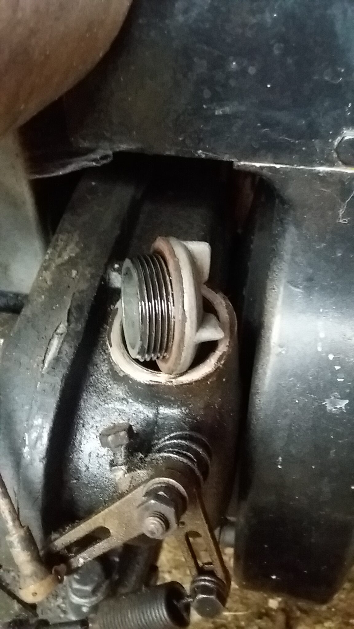

    Ok, unless I am missing something here, it looks like the filler cap and dipstick are two different things in my Douglas engine.

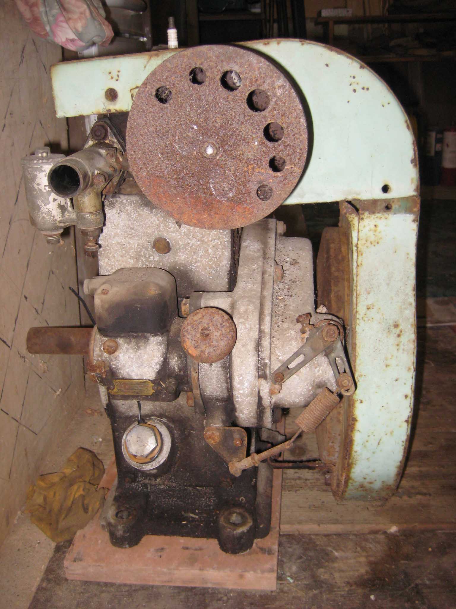

    The oil filler/dipstick arrangement on your engine is different to mine. As you can see in the attached photo, on my engine the oil filler is directly below the magneto, but yours is on the timing case. I am guessing that one of our engines is a later version.

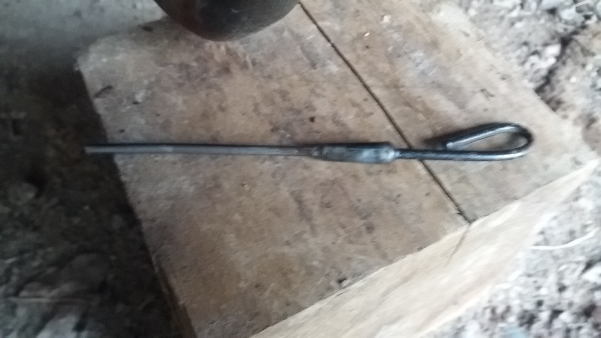

    The manual for the engine states that the sump capacity is 3 pints, so I will drain it and then refill with 3 pints. I can then measure the depth myself and make a suitable dipstick.

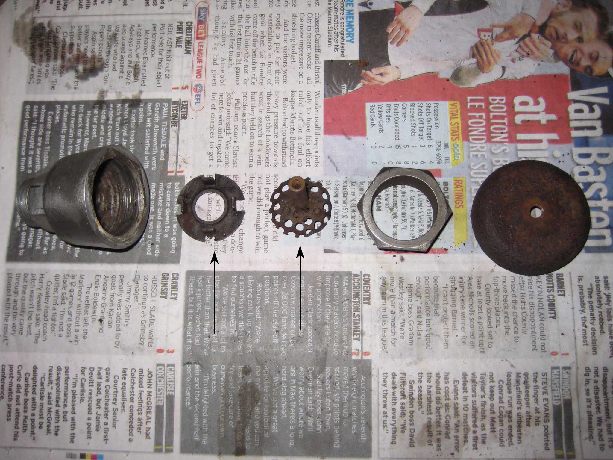

    Further dabbling with the SV54 has left me a little puzzled over the breather. Normal breather operation allows high pressure to escape from the crankcase and close when crankcase pressure is lower than the external air pressure (correct me if I’m wrong). On my Douglas, it is open to breathe in and out, which makes me think something is missing. Attached is a photo of the breather stripped down. I reckon that there should be something between the items arrowed. Anyone else had one of these apart before?
    #30432
    You should have a thin spring steel disk as in the image below. It is 0.20mm thick.
