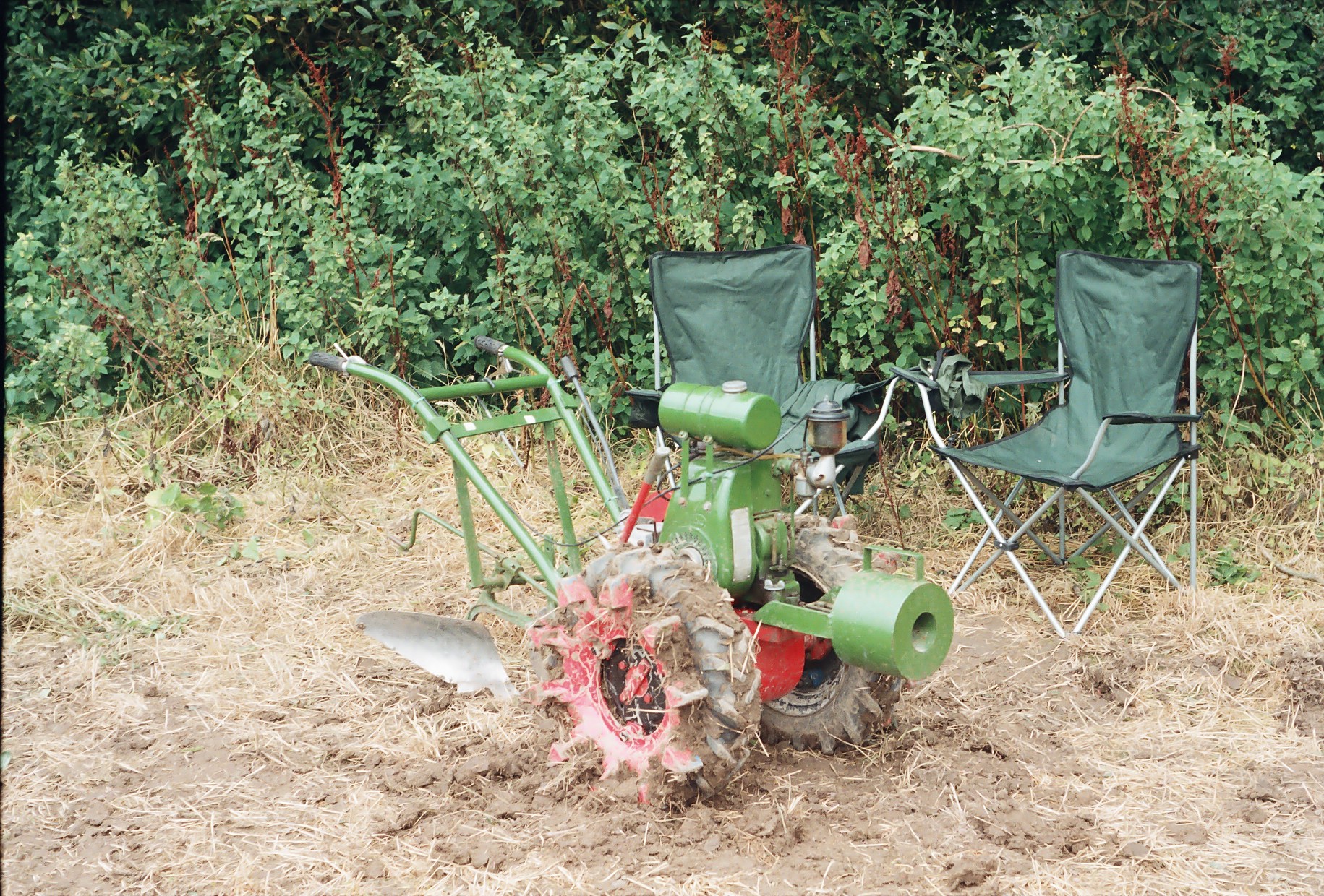

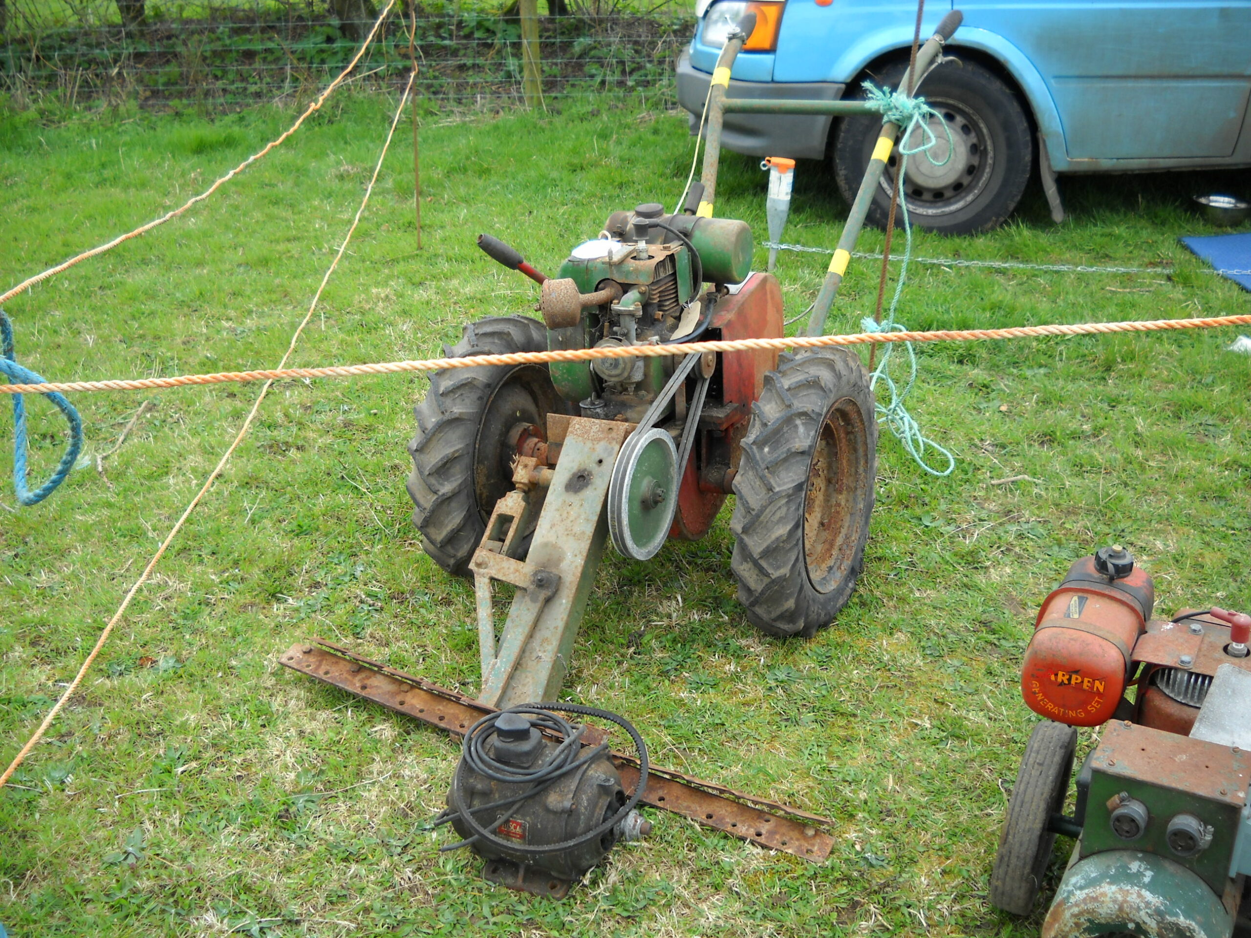

will-haggleParticipantMayfield garden tracors had ratchets in the hubs which would ease steering, my Fouroaks Spraymobile has a Mayfield chassis but the hubs are seized making it a bit hard to turn, if it had 25 gallons of weed killer on board it would be even harder! 1st picture. My 1953 Mayfield, 2nd picture My 1955 Spraymobile.

kmacaoidhParticipantThe Mayfield looks like a very adaptable tractor? I have looked at the vhgmc photo gallery, there are some wonder variations, along with your own finger-bar mower and sprayer. The sprayer is a fixed unit? The other attachments interchangeable? The flywheel is very useful. The Mayfield seems to have good ground clearance as well, for inter drill work? Ploughing. Was there a Mayfield plough? The barrow feature is also great. And if it can take 25 gallons, it’s a strong enough engine for every job?

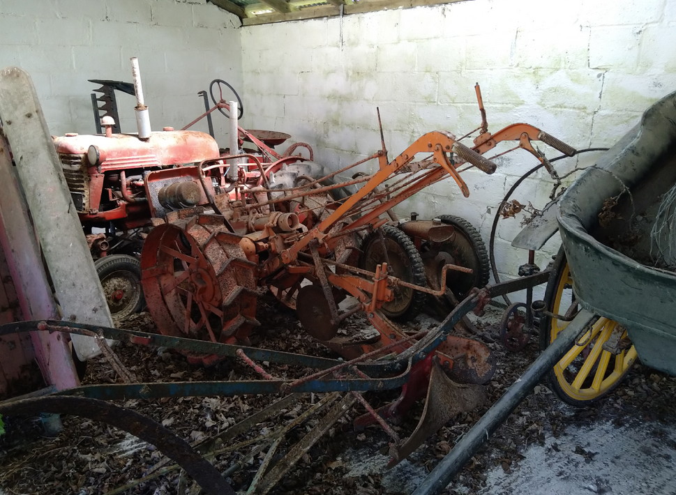

kmacaoidhParticipantIt’s not a Mayfield in this photo, a British Anzani and the smaller wheeled tractor in behind it, amongst a very busy garage i stumbled upon. Full of old farm equipment. I’ve seen photos of these smaller machines before but can’t think of their name now, abs I couldn’t really climb in to get a closer look! But not a Mayfield?
