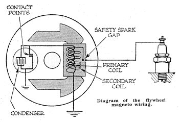

charlieKeymasterThe following diagram of the Villiers flywheel magneto can be found at https://www.historywebsite.co.uk/Museum/Engineering/Villiers/Villiers9.htm
This should help explain the circuit.September 2, 2021 at 11:21 am #37814
wristpinParticipantYour resistance reading on the primary is probably ok but the zero on the secondary is not good – a good coil will show resistance on both windings.
A bad winding on my meter will either show 0.L ( open loop ) or 0.00 for a dead short – no resistance. So the zero on your secondary suggests an internal dead short – not unusual for an old coil with internal corrosion.September 2, 2021 at 5:36 pm #37817
