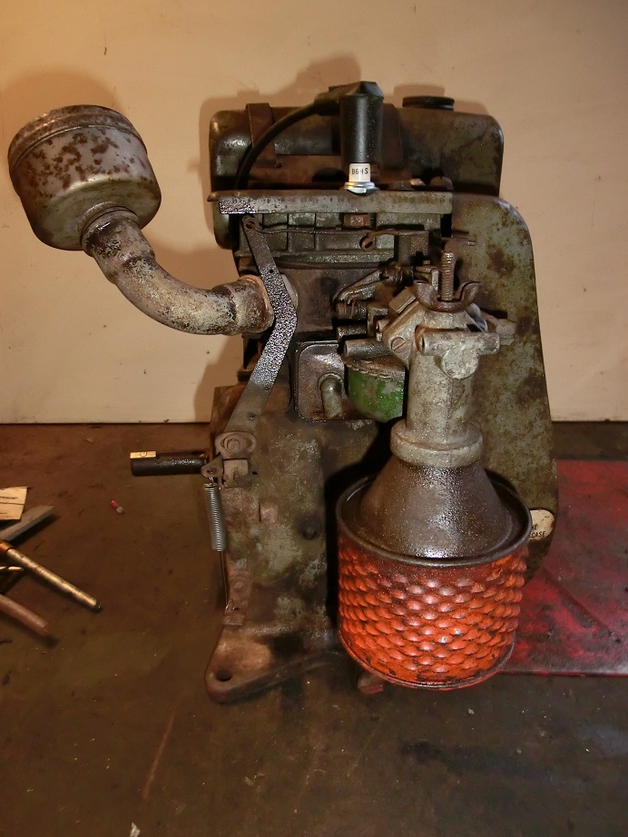

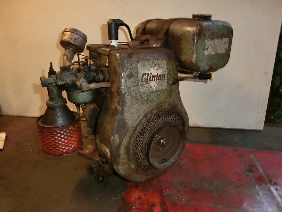

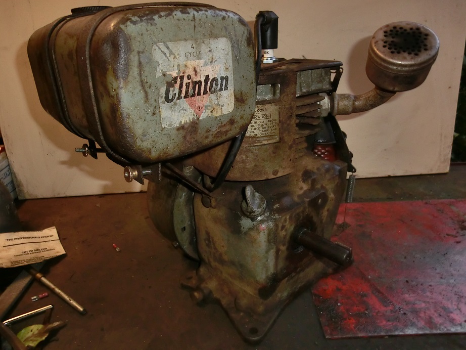

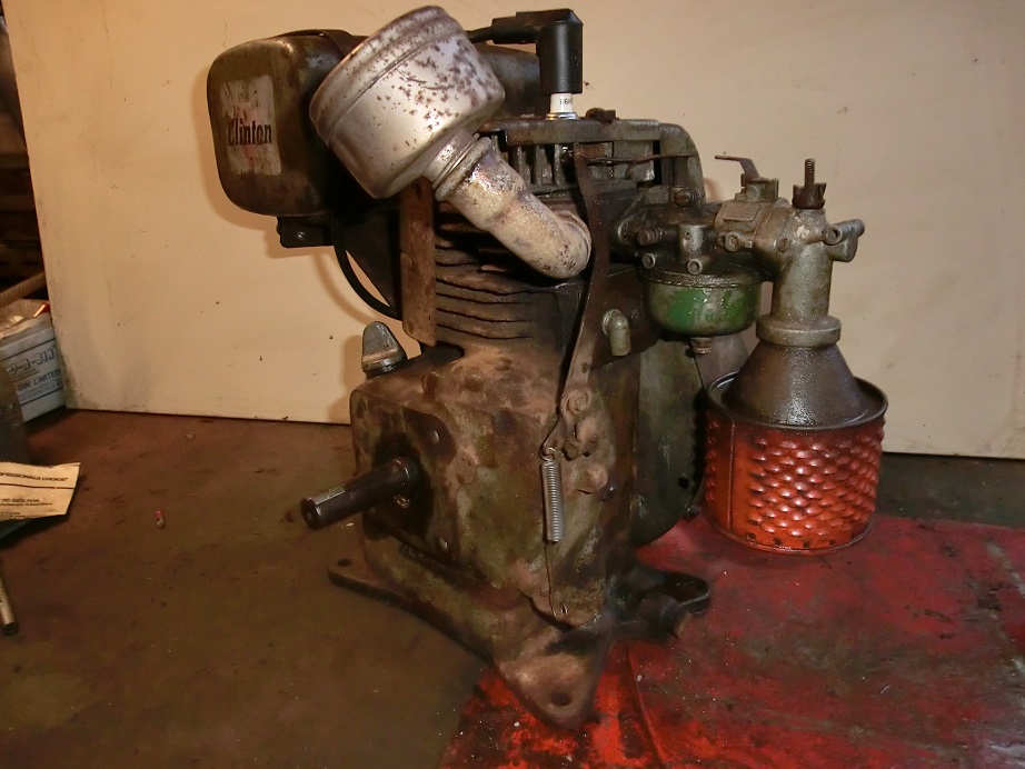

    Was asked to see if I could get this Cast Iron Block Clinton up and running and other than a bit of a struggle with a perforated fuel tank it was fairly straight forward but there is no sign of an engine model or serial number anywhere.
    I have found quite a bit of repair info’ on the net, valve clearances and points gap etc but it looks as though the only way if narrowing it down to even a group of models is to measure the bore and stroke – and it’s a bit late for that!
    It’s the first iron block Clinton that I have seen and will be grateful for any information.

    Hi angus. The number is stamped on the metal shroud which wraps around the cooling fins near to flywheel cover

    Thanks for that info’. The engine has gone to a new home courtesy of that auction site. Never did find a model number but used some generic information to set up the points and valve clearances. Must have got it about right as it had good compression and was a reliable second pull starter.
