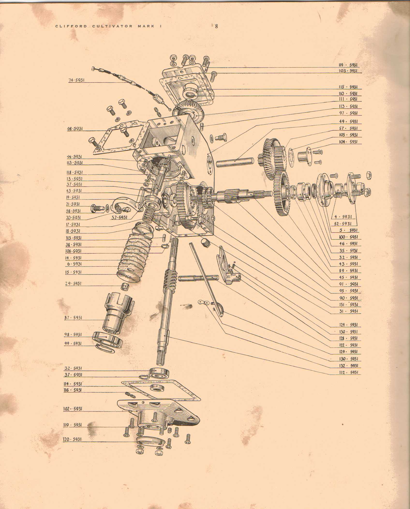

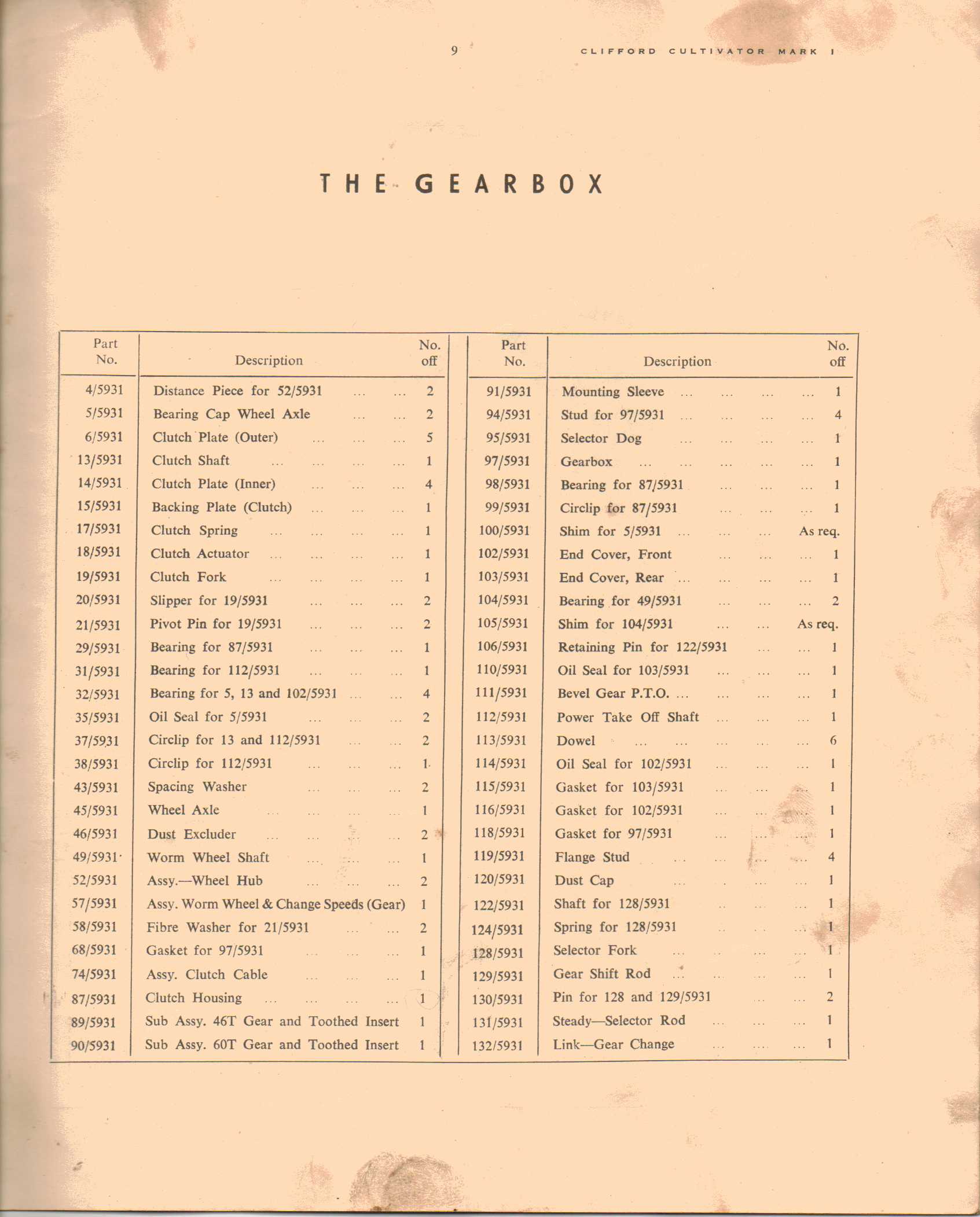

    Below are the relevant pages showing clutch. The manuals do come up on that well known auction website.
