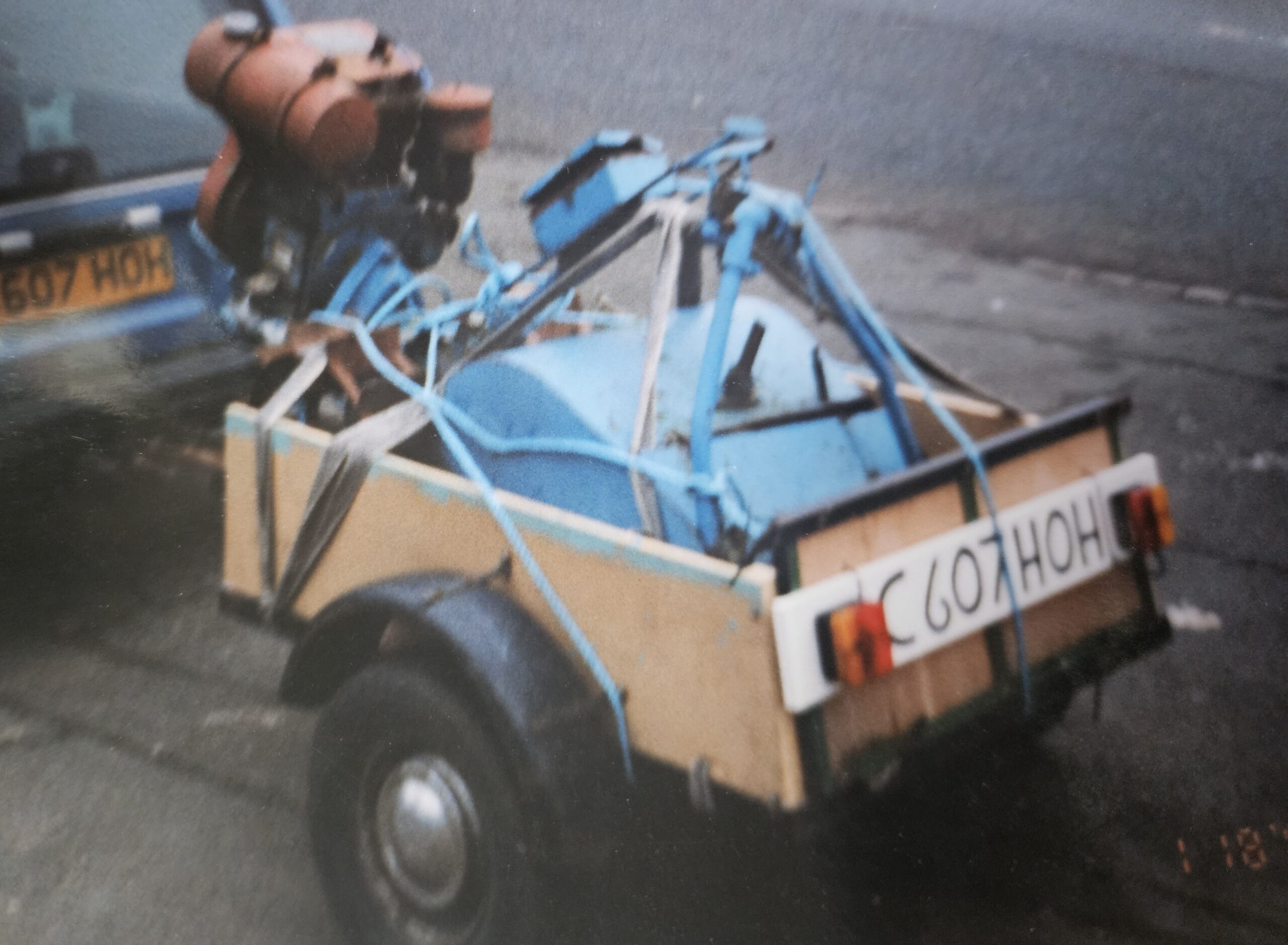

sidevalve5ParticipantHi,
I have the same machine in its original colour. Have taken the engine off, so some non faded paint is now exposed. Will take a photo so you can colour match if you wish. But this may take a few days, the machine is buried at the back of a shed. Some experts in the club may be able to help with the exact colour from a previous restoration.
Best wishes,
Grahame
