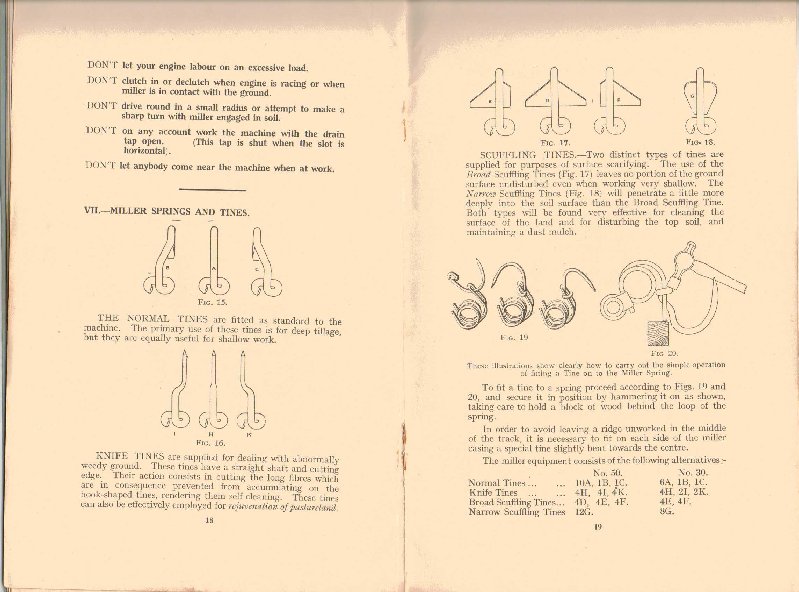

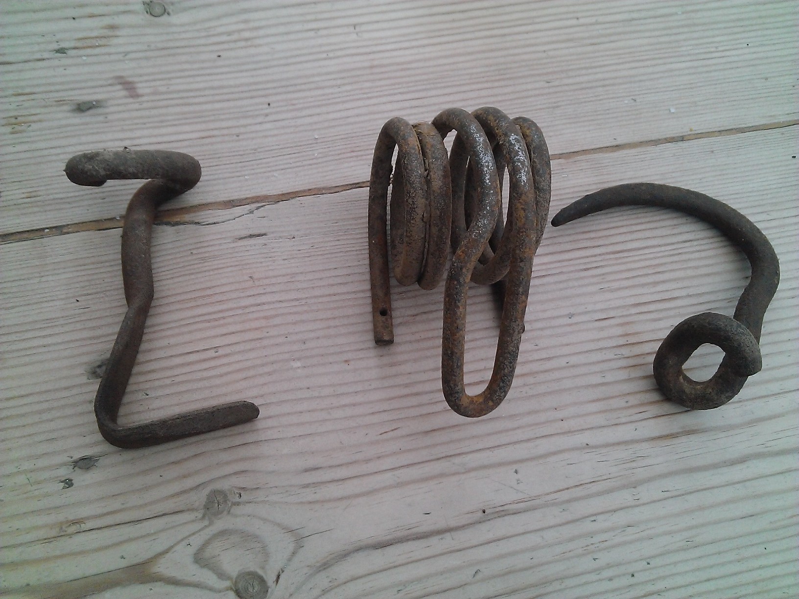

vhgmcbuddyMemberHello Just joined. Recently purchased the Clifford now running sweetly all it needed was a quick service and a repair to the fuel feed. It has spring tines and what I call turf cutters (“L” shaped spring tine) I would like to purchase some new tines and would appreciate help in sourcing these. Also, I have one spare tine and several springs but cannot work out how to put the two together.

March 24, 2014 at 4:55 pm #6852
charlieKeymasterDo the tines attach directly to the spring or are they attached to an insert in the loop of the spring? I suspect it is the former, which is the same as the Rototiller and can be a puzzle at first. The photo below is an extract from the Rototiller manual and may help with fitting.
As far as I know there are no suppliers of new tines or springs in the UK. A collector in Holland has details of some new tines on his website, it might be worth a look.
I have included a pdf copy of the same page which might be a bit clearer than the photo.March 25, 2014 at 8:12 am #6872
vhgmcbuddyMemberCharlie,
Thanks for that the spring and tine went together. It’s good when you know how. Do you have any idea’s on conversion to standard rotavator blades?
