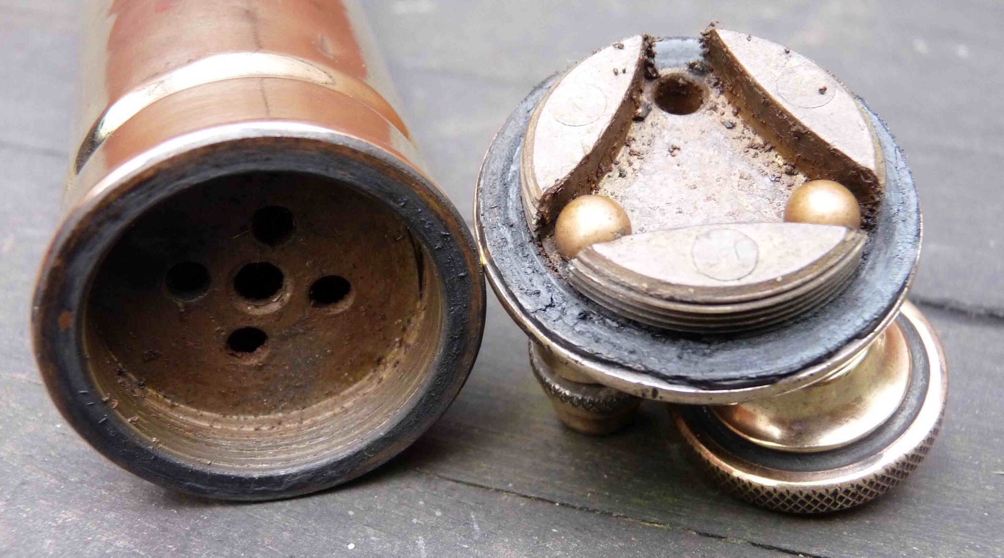

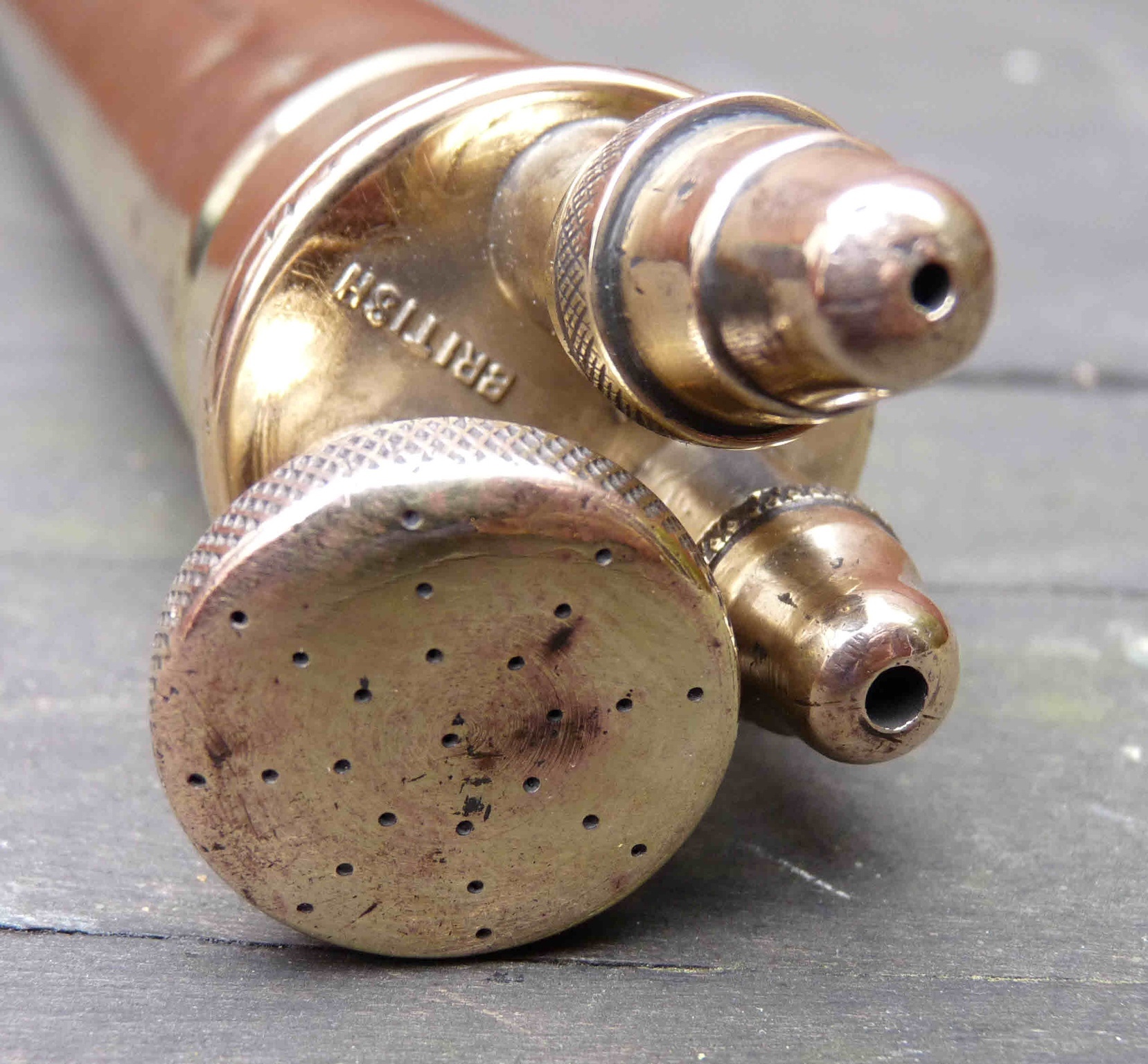

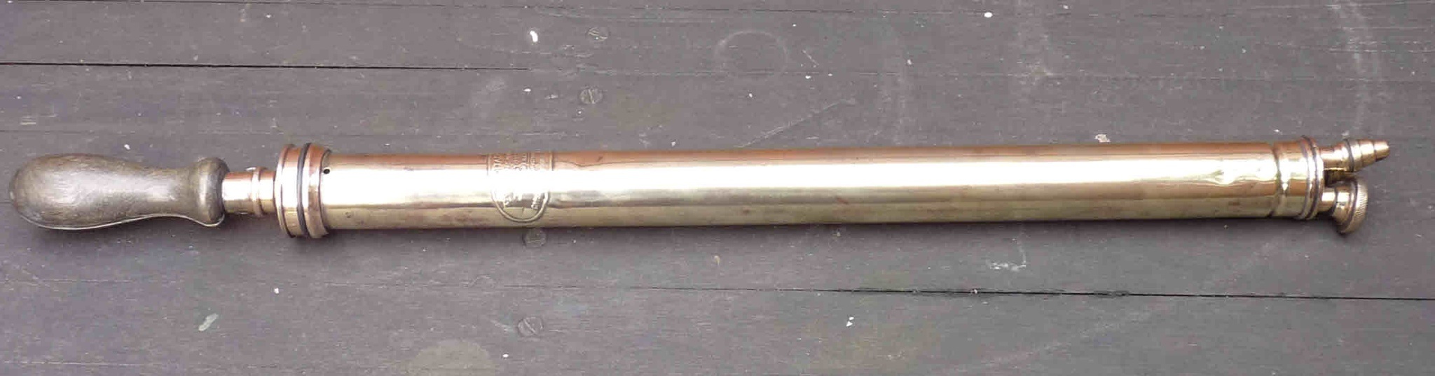

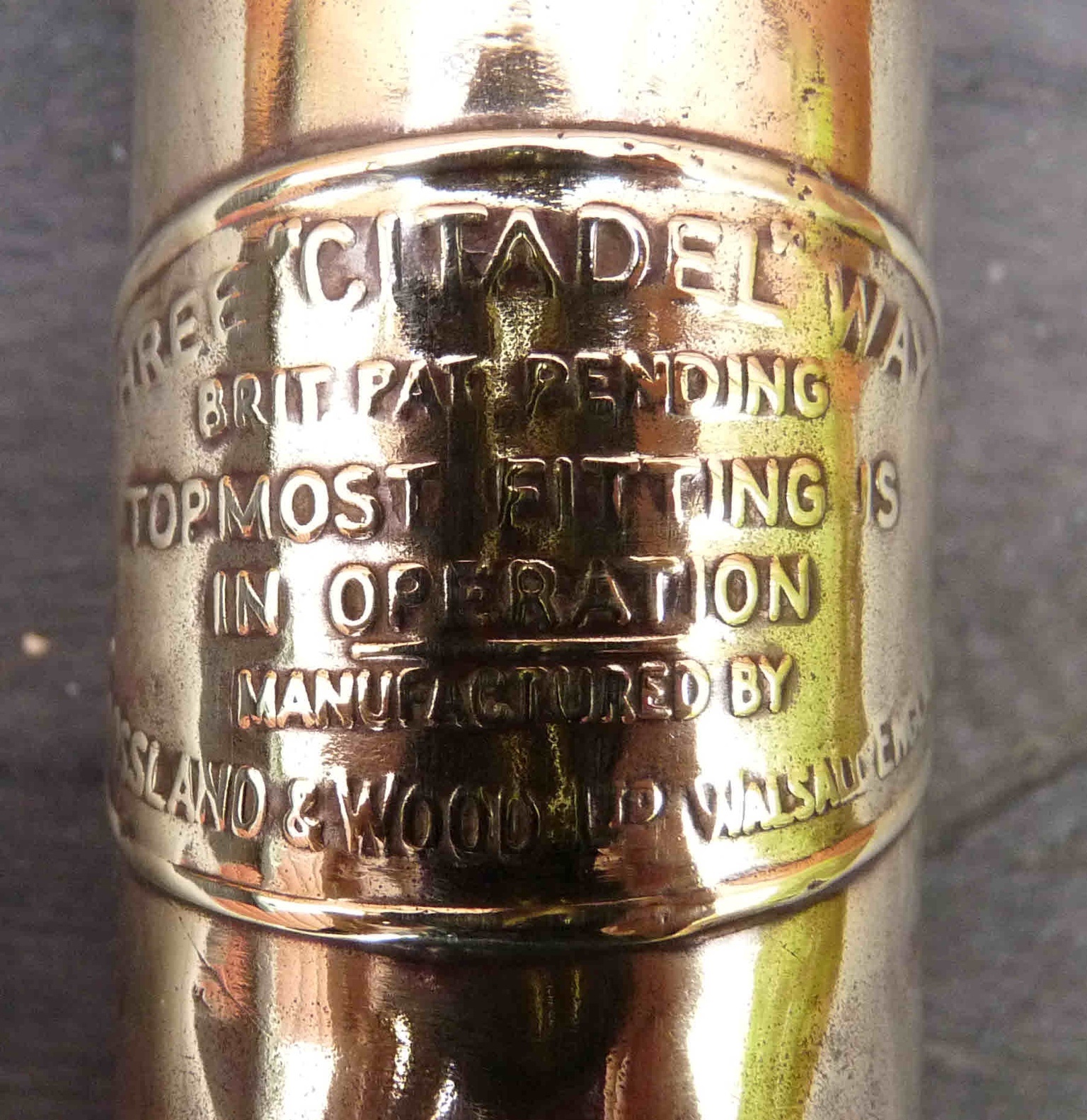

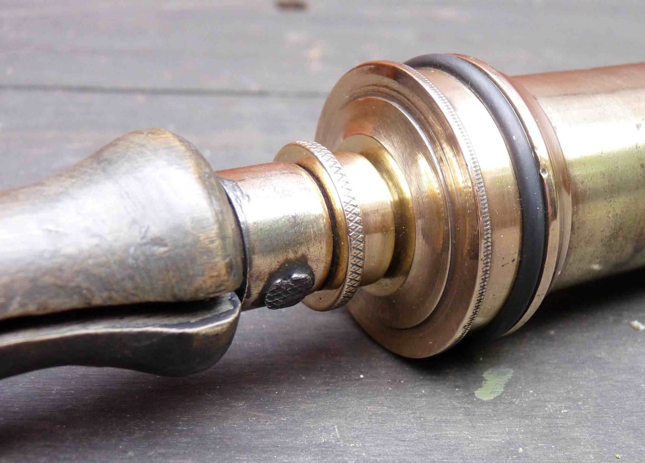

    Slightly unusual sprayer this one.
    Made by Crossland & Wood, it has three spray heads. The spray output is selected by turning the whole sprayer. The upper most spray head is the one that works as the other two are blocked by the metal balls which drop & block the openings – see photos for detail.
    Although stripped and cleaned, I have yet to try it out.
