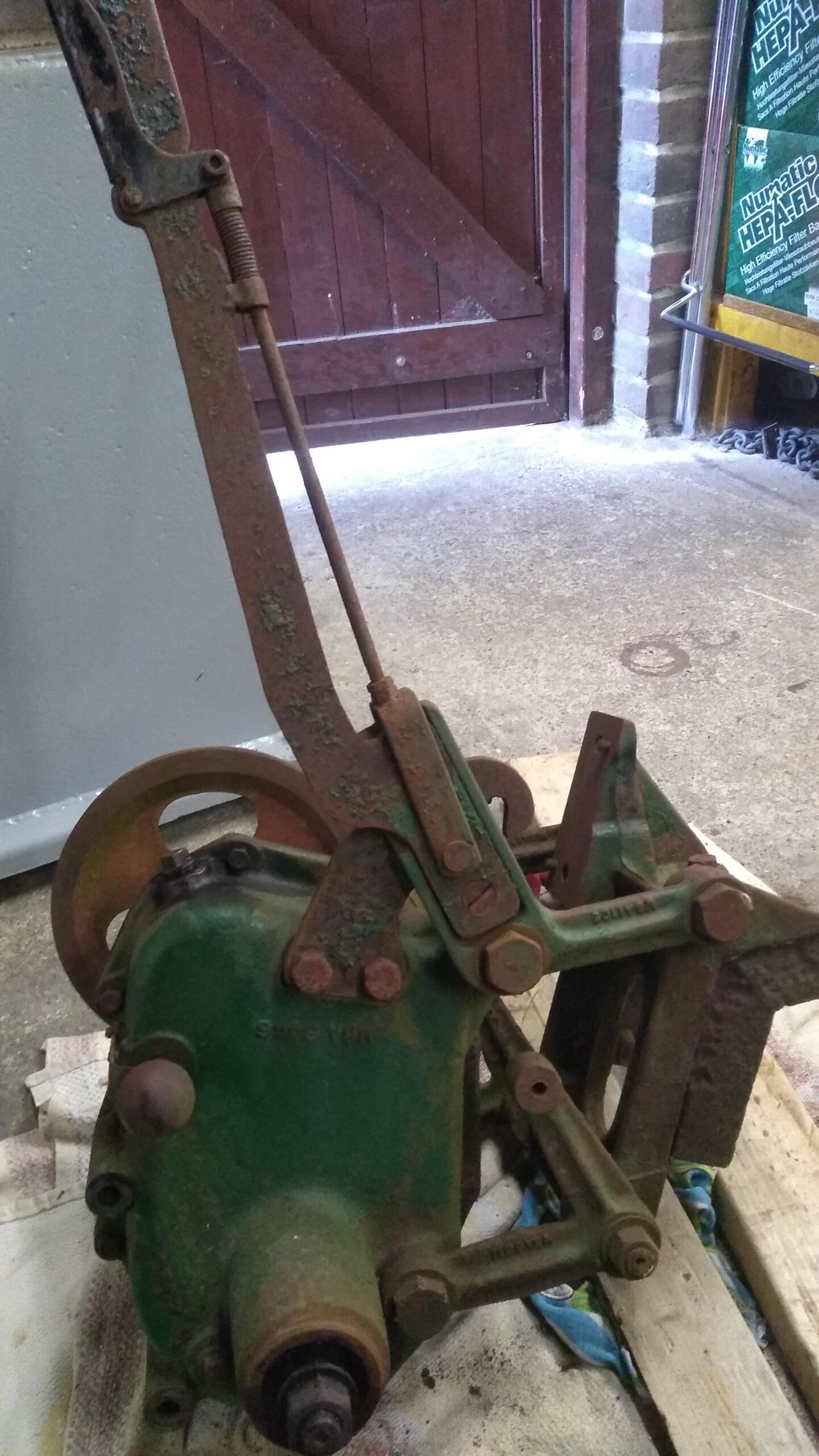

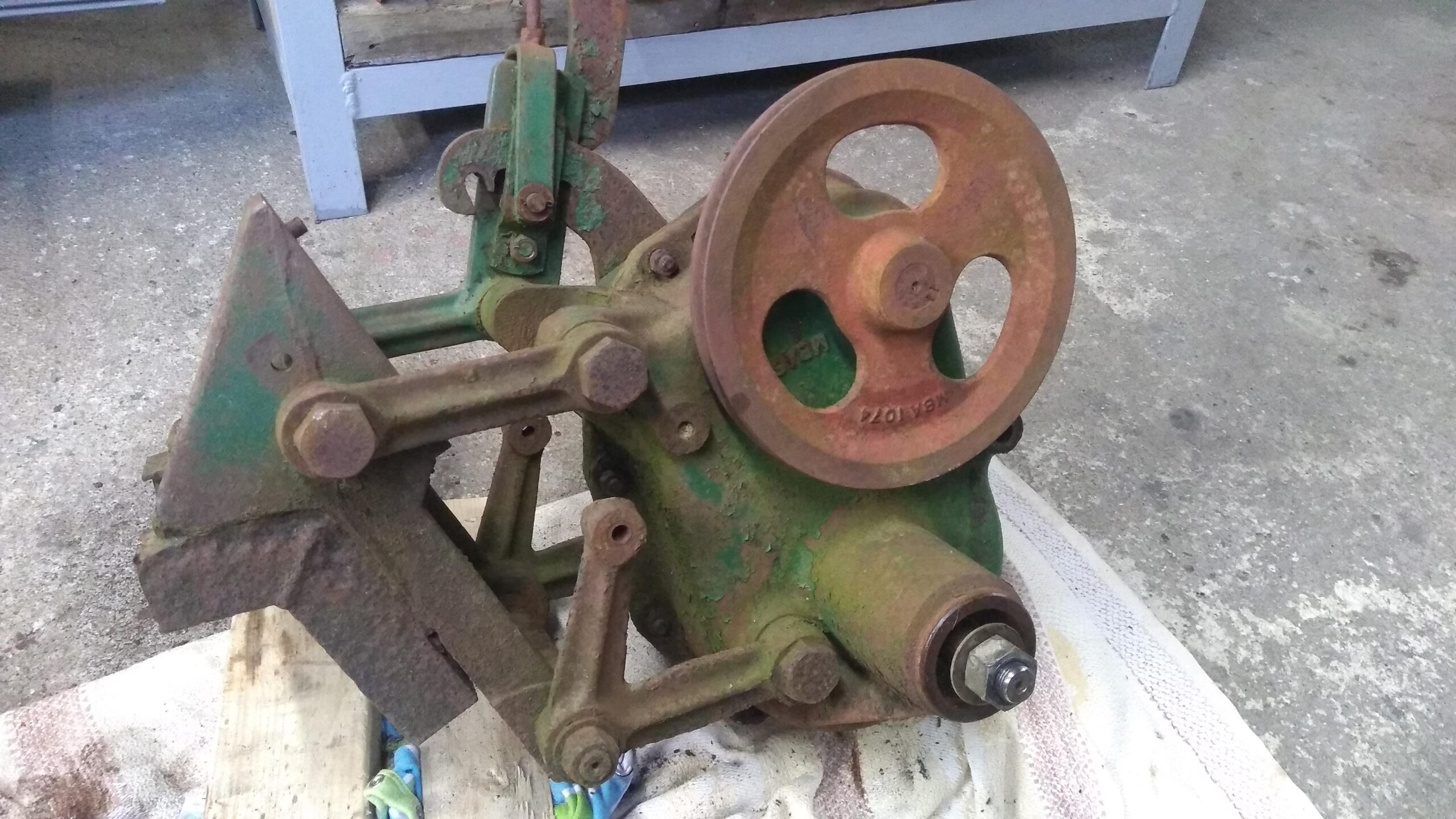

    So, it appears that I have bought myself an “MBA” something or other. It took me just 20 minutes of chatting, but I know that others study for two years. 🙂 Multiple parts including the main gearbox housing have MBA followed by a number code.
    It’s a 2-speed gearbox (approximately 1/4 or 1/8 gear ratio) of unknown provenance. The previous owner assumed it could be from a scythe, or less likely a rotovator. There are some linkages which to me look like those of a rotovator, but I could be wrong. Easily.
    I am interested to know whether anyone recognizes the MBA “brand” if that is what it is.

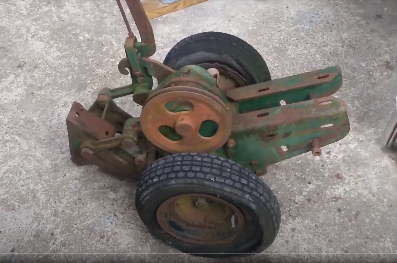

    The gearbox itself is in excellent condition and my plan is to reuse it in a home-brewed machine. The tyres were beyond bad but I think I could salvage the hubs if need be. To me, the wheels/tyres looked very wrong (much too small) and the tyres were marked 3.50-7 if I recall correctly. That appears to be an unusual size – maybe you could confirm? I would prefer something with much greater clearance. The hubs are split rims and it looks like I could fabricate something to attach the keyed part to new hubs if necessary.
    I’m new to this forum and have no idea whether to expect any replies. If you are reading this and would like more info / pictures then please let me know.

    To me it looks like the drive system from a Ransomes Multimower.
    #34693
    Andy,
    That’s so helpful! I have now Googled Ransomes Multimower gearbox and found an identical unit for sale. Further Googling suggests it can be no earlier than 1963. Another website suggests SAE140 for the gearbox — would this sound right?
    Brian
    #34694
    Correction — I have now found the service manual. Gearbox oil is SAE 40.
    https://www.dropbox.com/s/2wsg58gl3g7j4q7/Ransomes%20multimower0001.pdf
    #34695
    Many Ransomes part numbers have the prefix MBA. In your case it will identify the casting that makes up the gearbox rather than the whole unit. Certainly looks like a Multimower gearbox.
    #34699
    Gearbox oils. GL-4 is OK for gearboxes that have brass components, mixed opinion about GL-5, some say yes some say no. I have Monro Tiller rotavators which use SAE140 in gearbox. Morris Oils of Shrewsbury do a good range of classic oils.
    #34702
