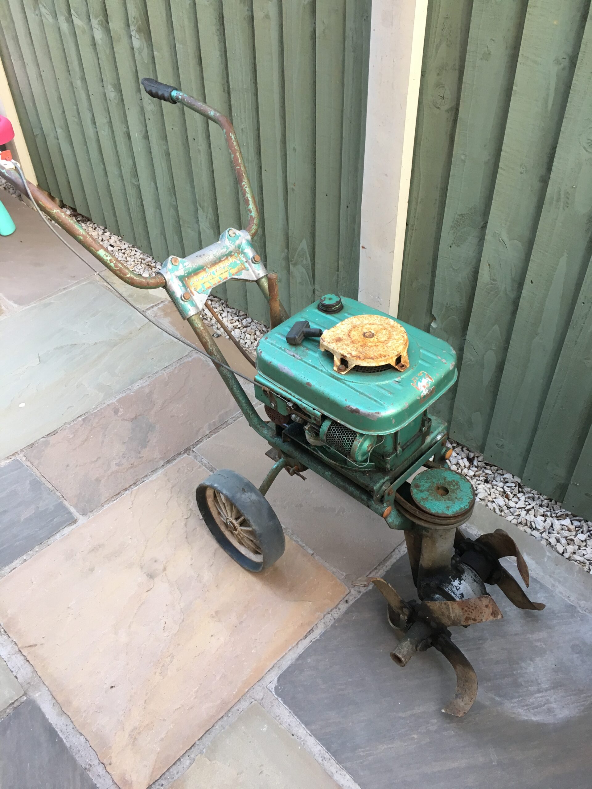

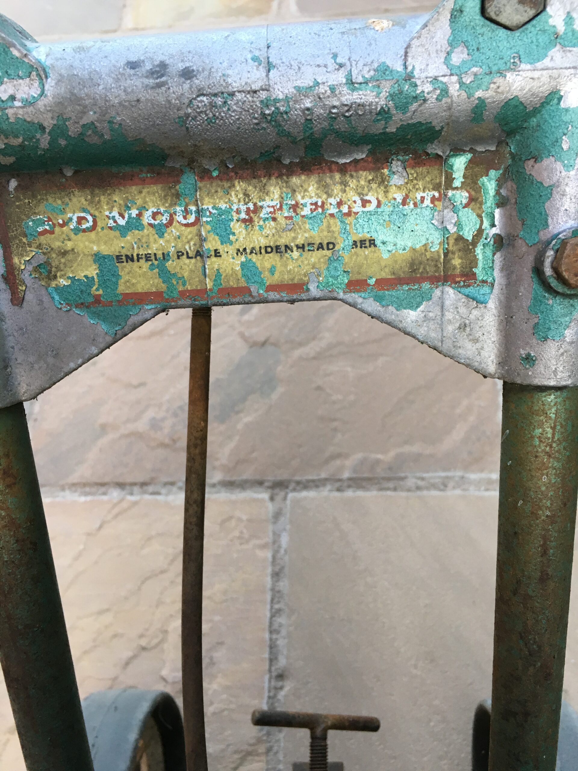

vhgmcbuddyMemberLooks like a Mounfield M1 with the covers missing to me, I have been wrong before though haha.

vhgmcbuddyMemberI thought it looked older than an m1 it doesn’t look like it has any covers missing

vhgmcbuddyMemberQuick google search found this 🙂

charlieKeymasterAny good garden machinery repair shop or motor factors should be able to supply the correct spark plug so long as you know what it should be, take old one as sample. What is the engine Briggs & Stratton?

vhgmcbuddyMemberI think it maybe a kirby lauson engine. The spark plug isn’t a problem to get hold of I just wondered if there was any where good to look for other spare parts.

wristpinParticipantLooks like a Kirby which was a Tecumseh made in Australia. Mountfield used them on rotary mowers and cultivators and Flymo used their 2-stroke on the 19 and 22” Contractors.
A spark plug will be easy but anything else like hen’s teeth.
I believe that the UK OEMs used them as with OZ being a Commonwealth country there was a more favourable rate of duty than when buying from the US.April 23, 2019 at 2:38 pm #30996
