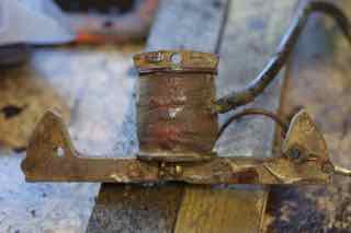

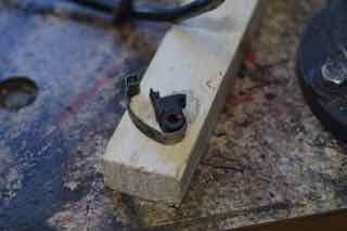

sidevalve44ParticipantI have now stripped the BSA 120cc that I removed from a Howard Bulldog.
It is in need of thorough overhaul. All the parts I need are available from Meetens except for the ignition coil and points.
Does anyone know of a potential source for these parts or a way round the problem. I am reluctant to spend £250 or so on engine parts if the thing is never likely to run !
Only option I can think of is use a motorcycle coil and battery and run a total loss system.
Over to you !

ParticipantHave you had the coil tested , 120cc components were Lucas , and generally very reliable , never be put off by the visual appearance of a coil , testing it would be my first course of action.
April 20, 2016 at 9:15 pm #20647
sidevalve44ParticipantI might be doing it wrong but, when I tried a resistance test it read nothing.
Bear in mind, it is at least 60 years old !

ParticipantYour coil needs to be tested using a proper ignition tester , multimeters and the like are no good for testing coils.

I’ll try and find someone who can test it for me (cheaply) If no good I’ll find a coil rewinder.
