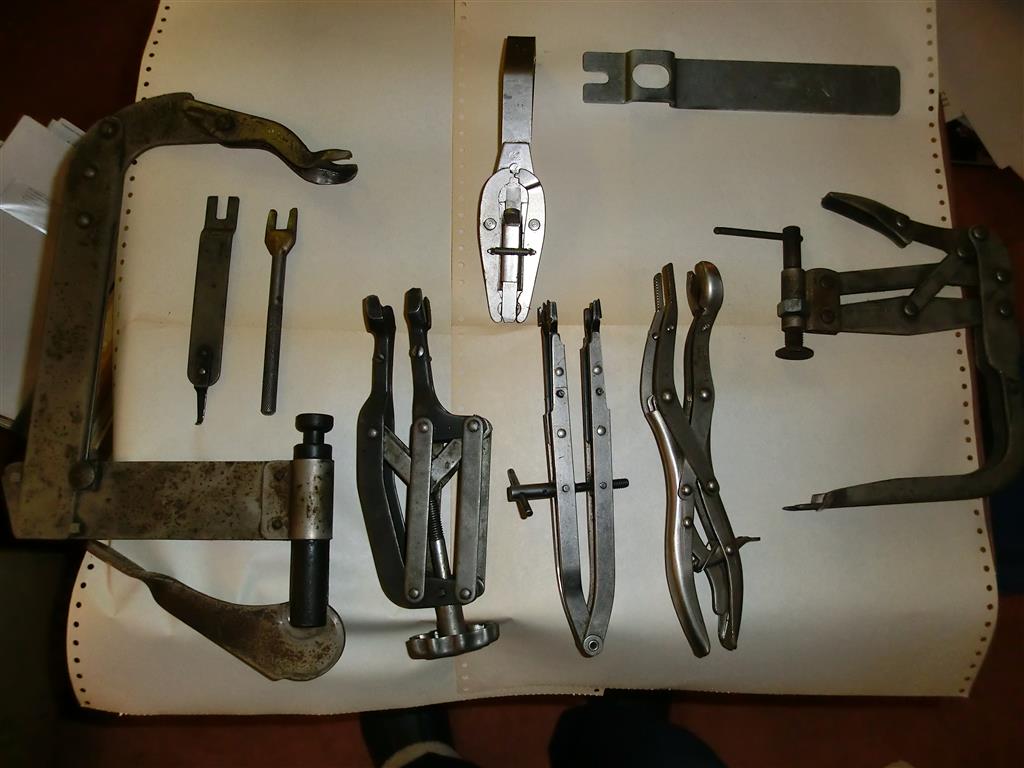

wristpinParticipantI seldom attempt to use the BS tool for dismantling, only for reassembling. As has been said in another reply,the trick for dismantling is to use a “hooky thing” to rotate the key hole retainer so that the wide part of the key hole is towards you so that an upward and forward thrust disengages it from the valve stem.
In the attached pic of my collection of small engine valve tools the “hooky thing” is to the left within the big spring compressor.November 25, 2016 at 8:03 am #23216

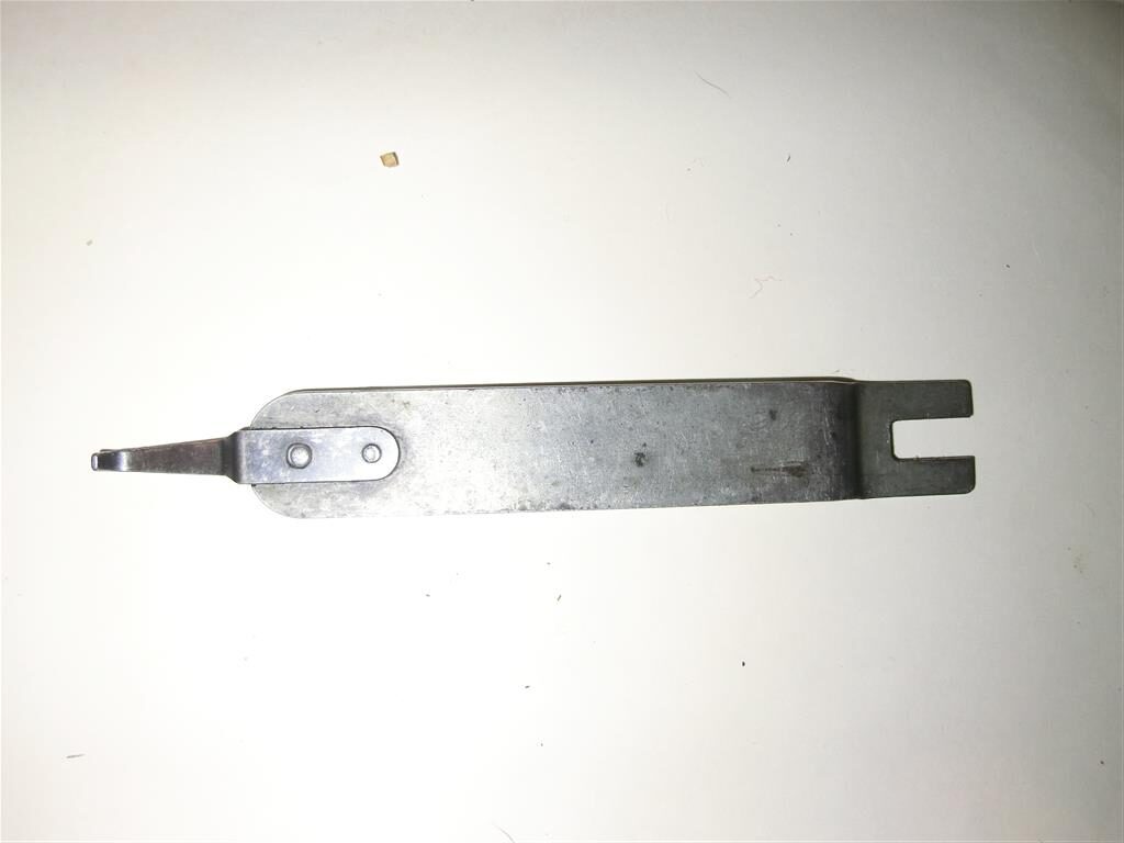

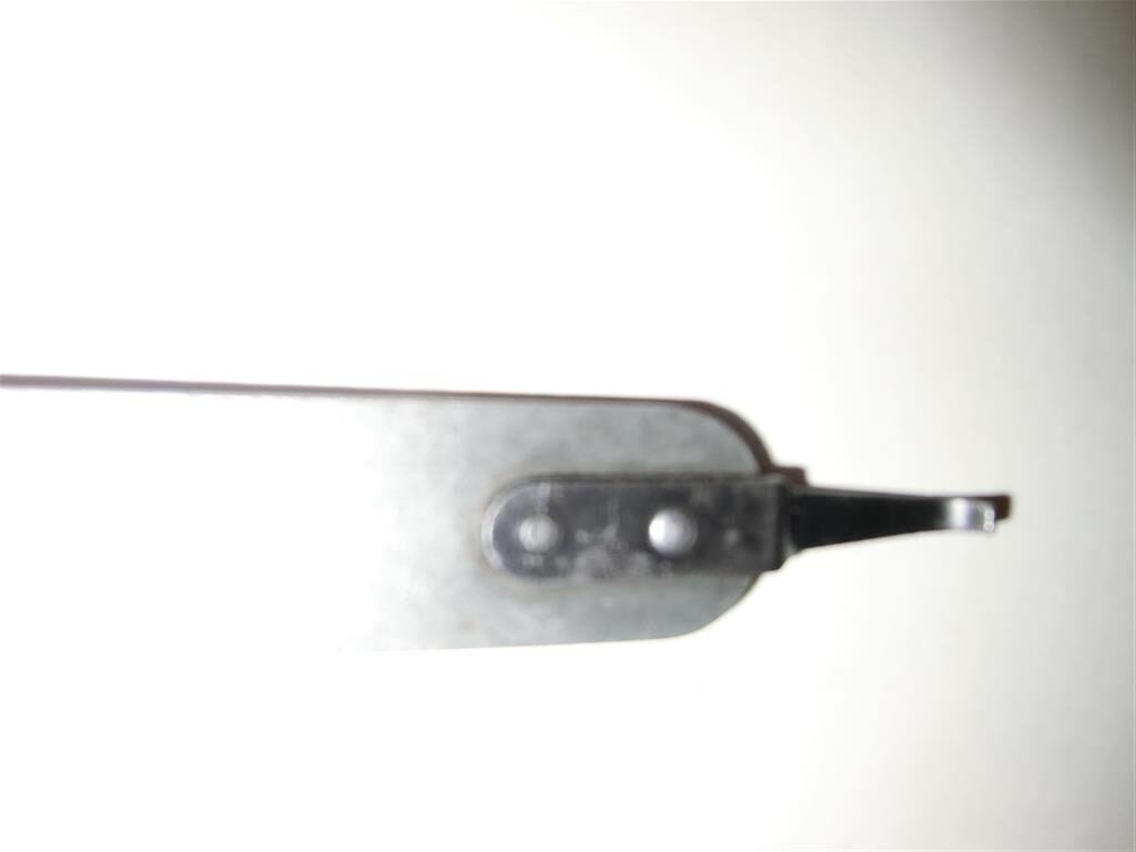

wristpinParticipantMy tool was made by KD Tools and came from the US but I have seen them in various UK catalogues but not lately. An old screwdriver could easily be modified with a bend on the end ground into a hook. The other end with the cut out to lift and lever the bottom retainer may not be so easy to reproduce but once you have the keyhole lined up a screwdriver will push it off.
The other tool beside it in my last post, is much used and is a Trcnamotor/Aspera/Tecumseh tool – no longer available but fairly easy to make.KD Tool
