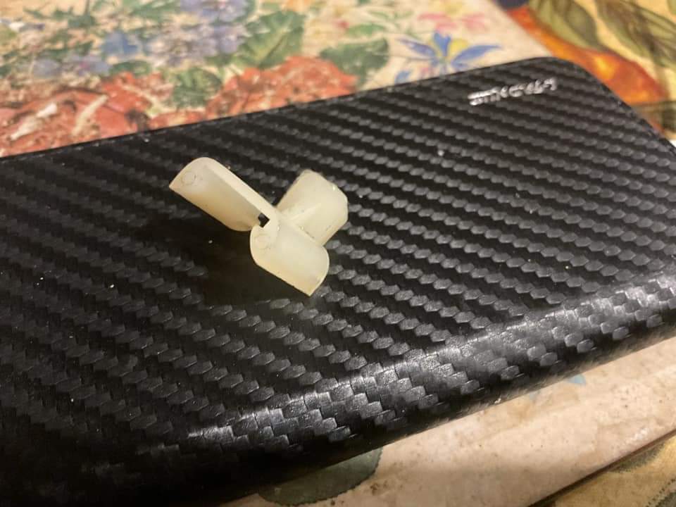

ParticipantI’ve been replacing the plastic pulley and recoil spring on a horizontal crank Briggs engine. It’s the old type with metal tabs that bend over to retain the plastic pulley. Unfortunately, the tabs have broken off and I’m not able to keep the pulley held in the housing.
I understand that aftermarket parts suppliers made plastic clips that held the pulley in place (see photos). Does anyone know where I could buy a pair of these?
August 23, 2023 at 7:35 am #41152
charlieKeymasterHave you tried Briggs Bits they have a link to send enquiries on their website
August 25, 2023 at 8:23 am #41159urbanalfa
ParticipantThanks Charlie – I hadn’t tried them, but have now been in touch and they can’t find a supplier of these parts. I assume there isn’t a great deal of demand for these parts nowadays and it’s no longer worth making them.
I’ll have to get creative and make something
