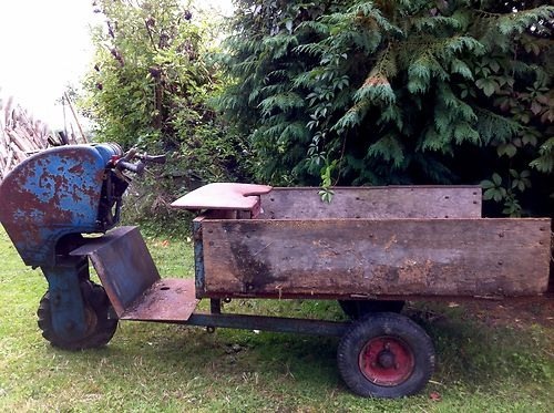

    bought this the other week few hours and it was running again it is a 1964 with a villiers
    my daughter and I are restoring it I rub down she paints!
    really enjoying it will try to exhibit it next year

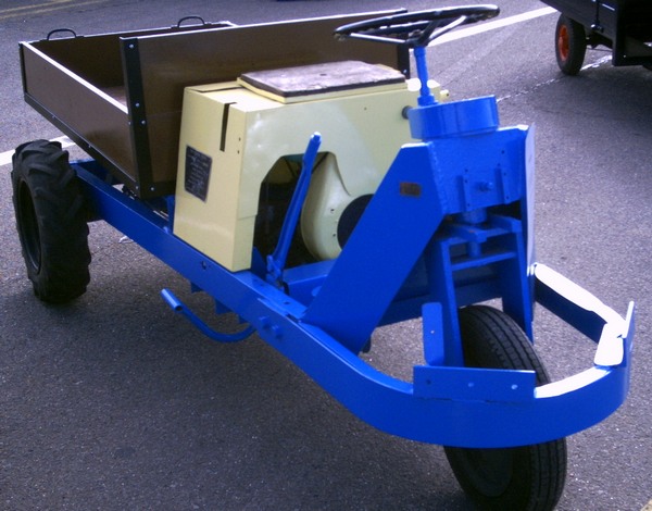

    Is it a Bonser? I’m not saying it isn’t but Bonsers and Martin Markham trucks have the engine under the seat… This is one I photographed at Kemble, Glos. in 2007…
    #1212
    it has a plate on it saying bonser
    anyone else know?

    Its a Bonser half ton truck, the bigger ones with the engine under the seat are one ton trucks, we have owned both types and still have the larger one.
    #1713
    You learn something new every day, Here’s som pictures of the truck gathering at the Gloucestershire Steam Extravaganza at South Cerney Airfield…
    #1718
    There are Geests, Wrigleys, Martin Markham, Bonser, Listers but not one like yours!

    thanks for the info
    painting has stalled in the rain here
    I have also looked on the net cannot find another like this one
