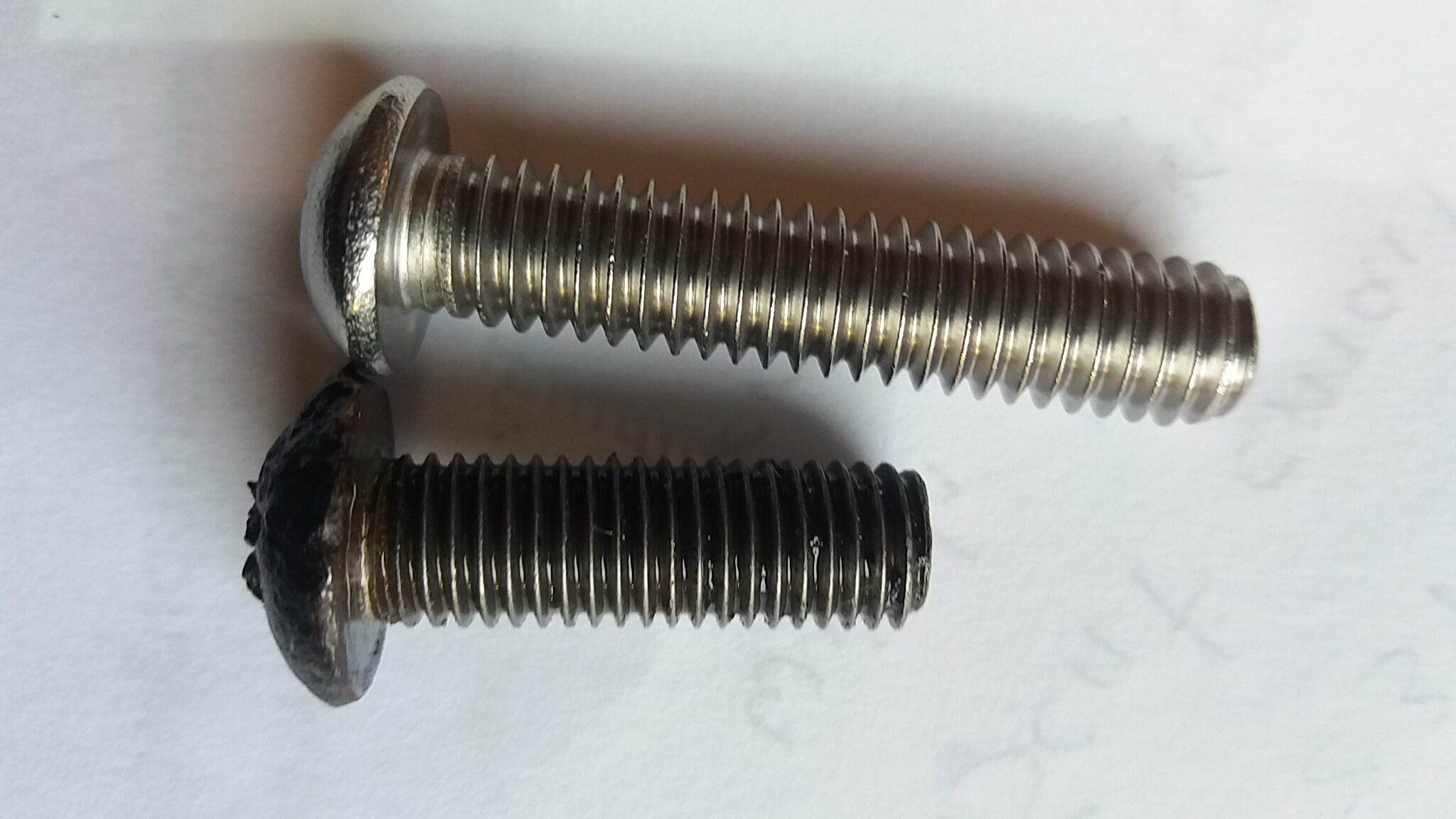

    Im trying to match some bolts. The bolt in question is from a 1950’s clifford rotavator and as you can see it has a very fine thread unlike the attempted replacement. The replacement is imperial, but has a much corser thread (plus they sent me the wrong length ones as you can see). Does anyone know what type I should be asking for (The dimensions are 5/16ths x 1 inch.) Thanks in advance.

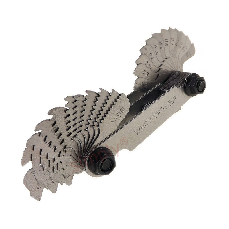

    Purchase a set of thread gauges (see pic below). I have this set which covers Whitworth and Metric threads. I also have another set for UNC/UNF. They normally cost about £5. I never enter the shed without mine!!

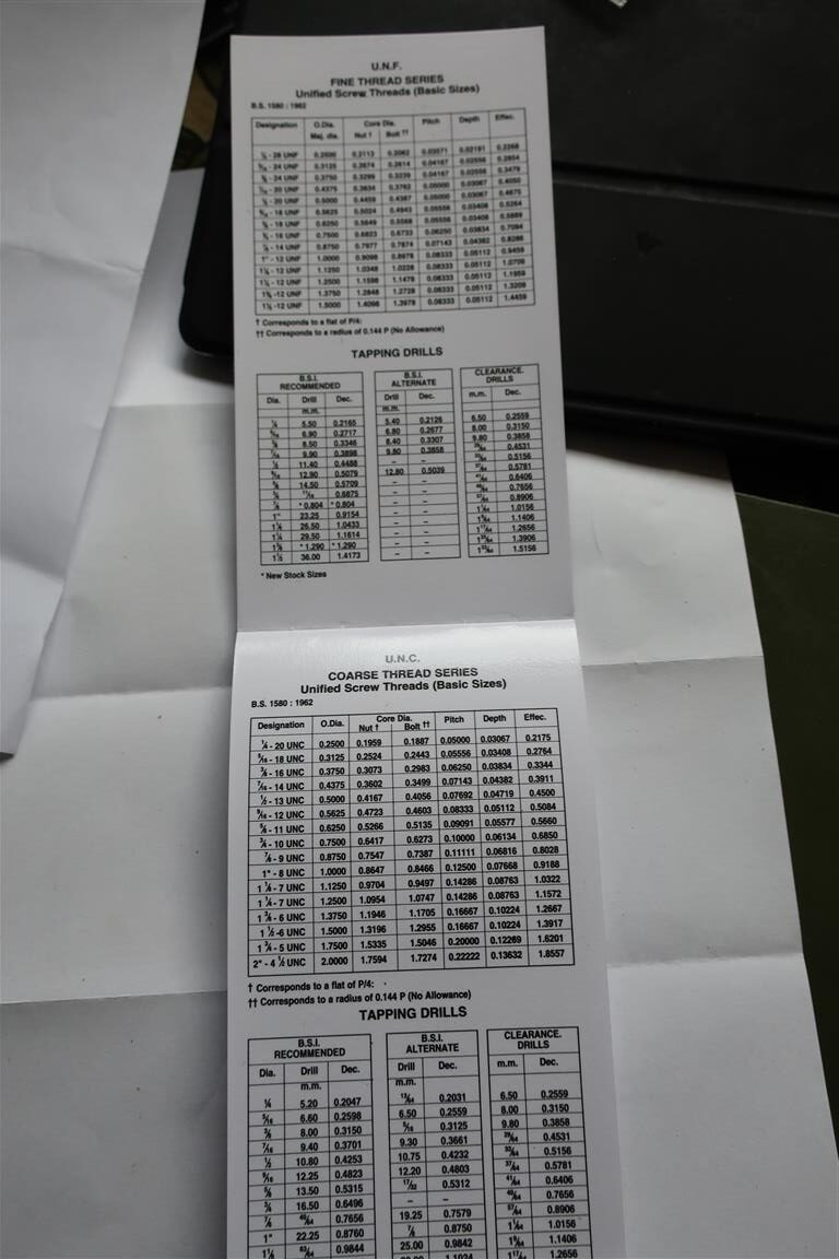

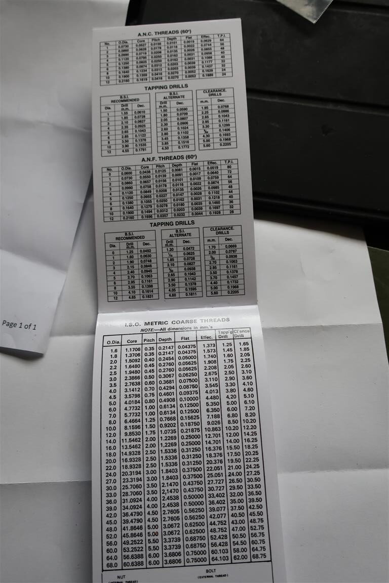

    #27764
    I have posted a link to the very useful Zeus tables for identifying thread types, drilling and tapping sizes etc here is an image or two of my copy.
    Sorry about the orientation but they were OK when they left here!

    Yes, I am of the conclusion a thread gauge is a must. I did sent the bolt off to the above mentioned company who very quickly identified it as BSF and sent me 6 new shiny ones which fit perfectly. I now have the bolts, new felt washers and new oil seals which once put back together should solve my tiller oil leak on my mk1 Clifford Rotavator!
