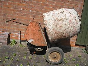

I believe this one dates from the end of the 1960’s with a slightly later engine fitted.May 14, 2017 at 6:08 pm #25219

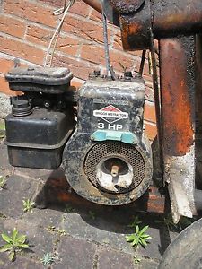

dorignyParticipantYes, the engine looks more recent, reminiscent of those I recall on the early 1980s models, with remains of the turquoise plastic starter pulley guard.

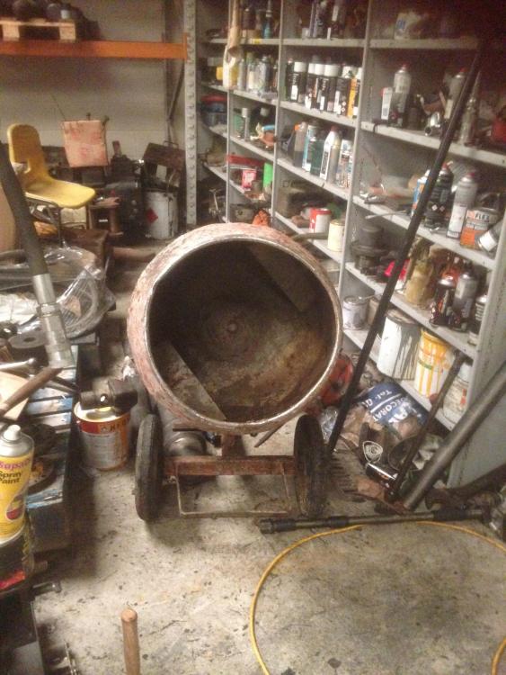

vhgmcbuddyMemberYes the engine is dated April 1978, so still 39 years old. Ive dug a late 1960’s briggs out of my shed, so will be using most of that for the rebuild.

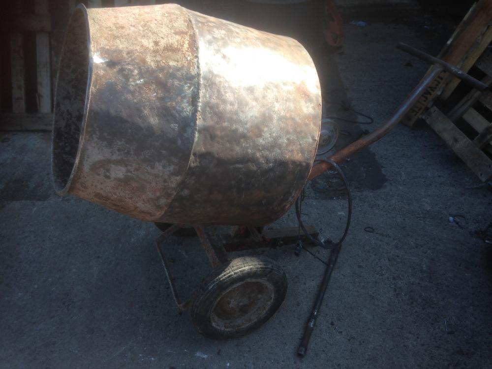

vhgmcbuddyMemberMay 26, 2017 at 11:00 pm #25375
wristpinParticipantJust got the tedious job of removing all the old concrete.
Can you not use the “brick acid” from the builders’ merchant – or is that a no,no?
May 27, 2017 at 2:35 pm #25376
vhgmcbuddyMemberI’ve tried brick acid in the past but it doesn’t seem to work very well. I’ve heard it suggested by some that it may be down to the lime in the concrete neutralising the acid?
I’ve got a video of cleaning out the inside using metal and bricks. The engine is hunting a bit so I was thinking about ordering up a new needle and seat plus a governor Spring as I can’t quite get it to smooth out, unless anyone has any other ideas?
May 27, 2017 at 10:32 pm #25377
wristpinParticipantMost (but not all) Briggs hunting issues are to fuel starvation resulting from gumming in the carburettor and / or weak fuel delivery due to a hardened pump diaphragm. Things to look at are partial blockage of the filter screen on the bottom of the long pick-up pipe, ditto the short pipe, hardened diaphragm and general varnish / gum in any accessible carb passages.
Use the BS Model, Type and Code numbers to get the correct diaphragm – guessing 270026. Unlikely to be the gov spring unless it shows signs of having been mauled about!May 28, 2017 at 7:44 am #25378
vhgmcbuddyMemberThanks for that. It’s had a new diaphragm, the pickups are spotless and the carb has been ultra sound cleaned. The valves were also reground, decoked, new plug,electronic ignition coil plus new rubbers on the carb pulse pipe fitted.
Was only considering a governor after the difference it can make to Hondas, but I’ll listen to your advise, perhaps just try a needle and seat first.May 28, 2017 at 9:46 am #25380
wristpinParticipantDoes seem that you’ve dealt with most of the likely candidates! One test is to hold the carburettor throttle spindle steady of even screw the idle stop screw fully in to stop the spindle moving. If the hunting persists it is a fuelling issue. If not, maybe try a new spring.
Have you tried fully loading the drum to make the engine “work”? The reason for asking this is that way back when the 5HP version of your engine with a similar tank, throttle and governor set-up was fitted to the Atco 24 lawnmower some machines had a”hunt at idle” problem but the machine was fine when under load. The cure then was to fit an additional very light governor spring to steady the carb spindle. Fairly sure that I still have the Briggs Service Bulletin somewhere if needed!May 28, 2017 at 11:12 am #25381andyfrost
ParticipantAlso , thoroughly check your inlet manifold gasket.
May 28, 2017 at 10:23 pm #25382
wristpinParticipantAlso , thoroughly check your inlet manifold gasket.
Good point.but don’t stop with the gasket, put a straight edge across the flange – they are quite prone to bowing from over tightening.
