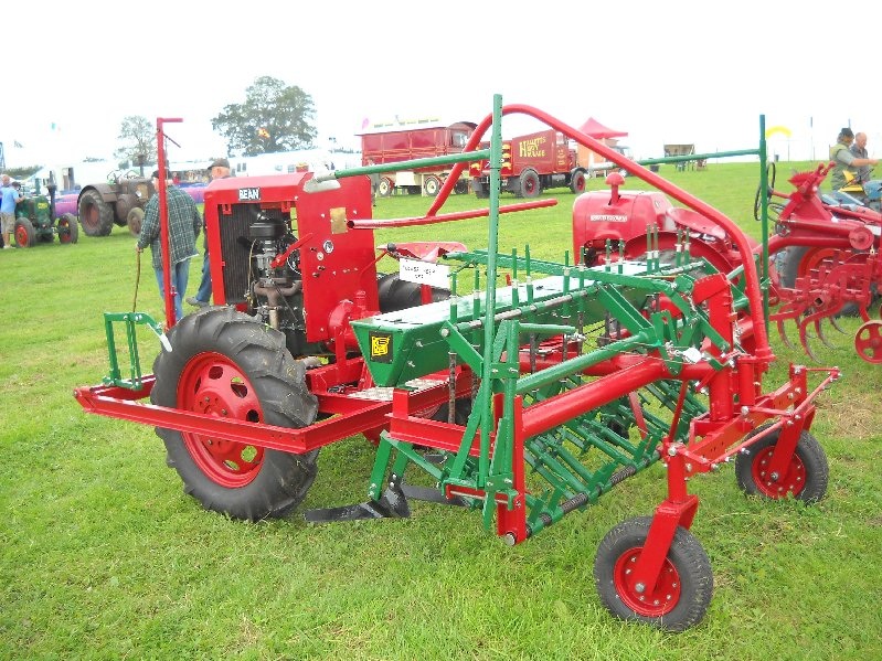

Megandlottie@gmail.comThe photo is not mine but a superbly-restored example of a Bean!

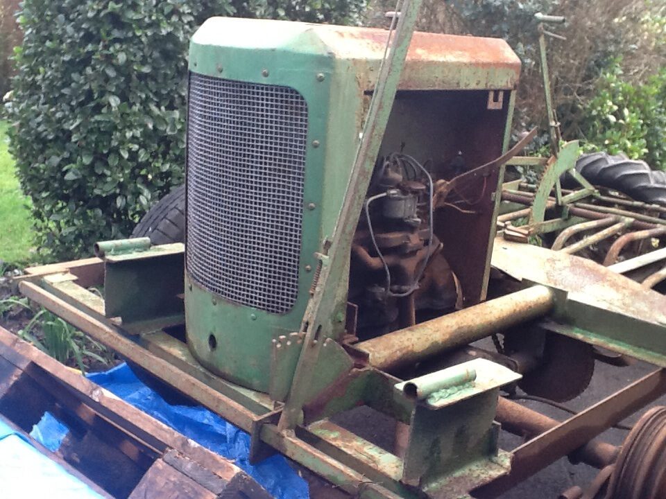

This old girl is not seized but needs rebuild. V appreciative of any clues re. spares, manual etc.
No idea why it is green.
Another modification is the drive wheels; the frame has been cut and widened, wheel spacers fixed to drums and wheel dishes reversed.
Previous owner says it was to enable wider rows to be cultivated.
There is no spec plate to be seen anywhere. Can anyone guess its age?

Your machine looks to be a three wheeler which was the original design dating from 1940’s, I have a early price list dated May 1946 and the introduction by Humberside Agricultural Products Co Ltd of a new horticultural tractor was announced in Farm Implement and Machinery Review in April 1945.
All Bean’s I have seen have been painted red with implements painted green
Hope this assists, will try and add some illustrations

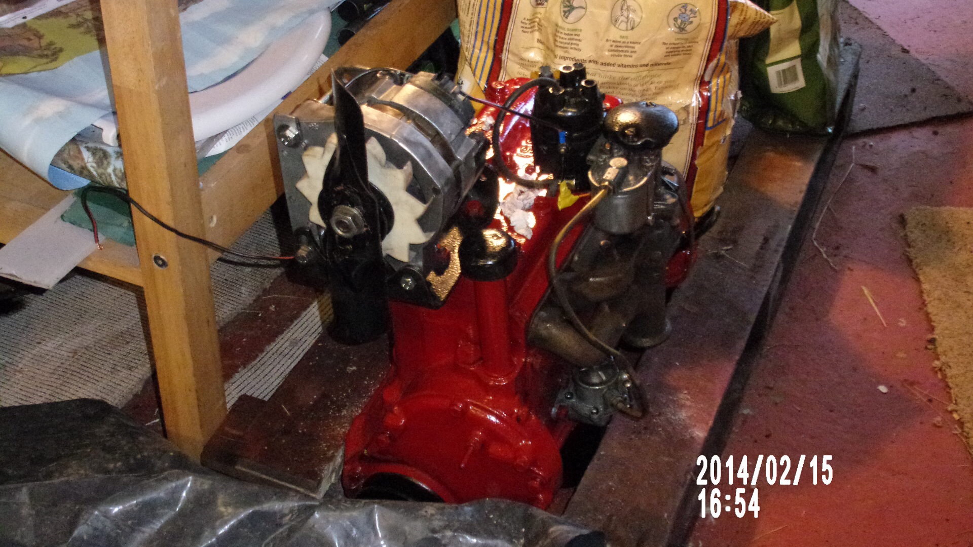

Good evening, Joe,I’ve just come in from the garage, where I’m fettling up a replacement engine which is stated to be low mileage; the original is in need of a rebuild.
The colour was originally red and it has been modified somewhat but that is all part of its charm. The aim is not to over-retsore it but to get into weather-proof running order …. another way of saying I’m a garden-shed mechanic, definitely not an engineer!

February 20, 2014 at 10:09 pm #5947
vhgmcbuddyMemberDear Alan,
many thanks for the photos … Excellent clues for the rebuild!
