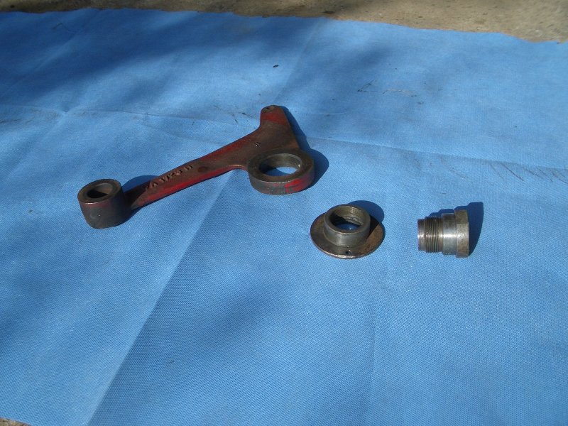

    #2538
    I have an idea it may be screwed on. Is this the pulley that moves to take up slack in drive belt acting as the clutch? If so the photo below will reveal what I mean. This shows the jockey wheel operating arm and what the large pulley fixes to. You will need to split gearbox to get to the flats on the inner face of the screwed part. Cant remember but looking at photo it could be left hand thread.

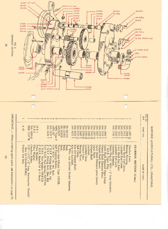

    #2542
    Here is an extract from the parts book, photo and pdf to download.

    #2595
    You should be able to see how it is held together by looking at the photo and diagram I posted. (Villiers manual sent via e mail to you today)

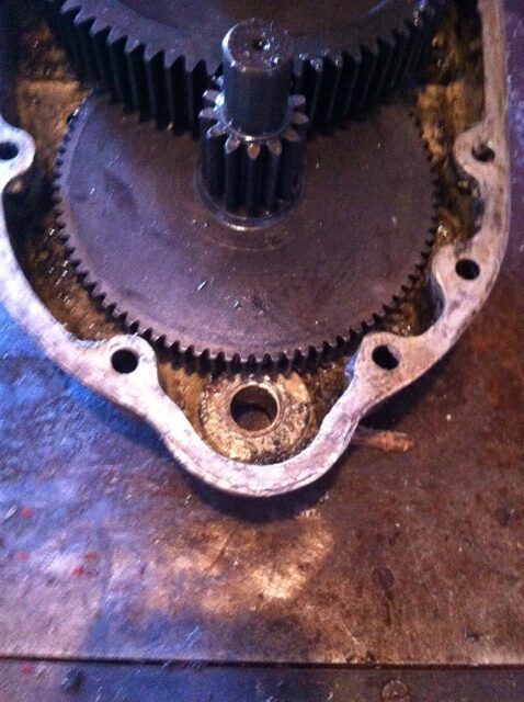

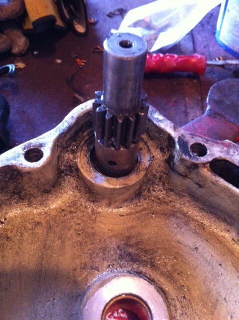

    #3533

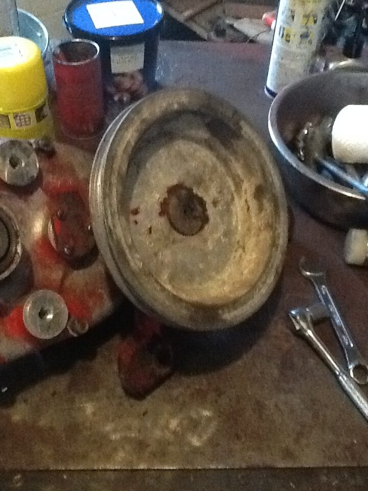

    Good news…ish.
    I managed to split the case (2 hours!) but the mystery thickens. The retaining nut Da1604T is missing (see photo) and there doesn’t seem to be any place for it.
    I can’t release the pulley and there is no immediately apparent way to release the shaft.
    Open to suggestions.

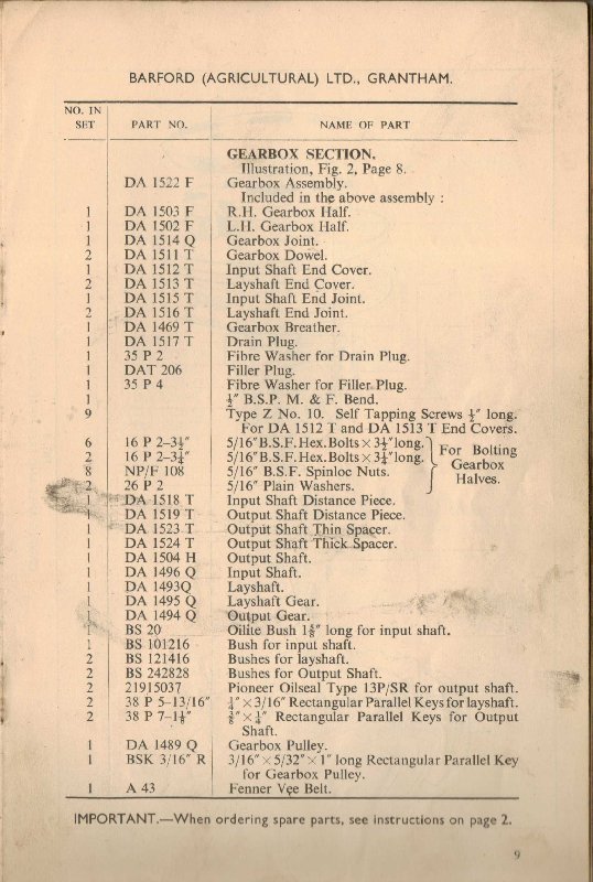

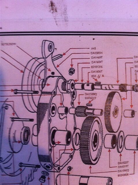

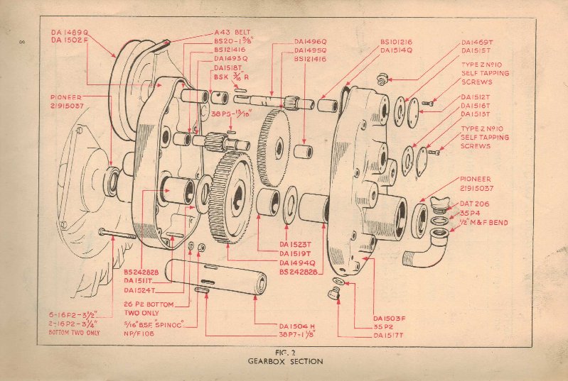

    #3542
    I have had another look at parts books and have found there is a difference between the gearboxes shown in the combined 15/30 book and the earlier 15 book. It appears you have the earlier 15 gearbox, extract from book below will show what you have. Only leaves question of how does it come apart?
    #3545
    Part number BSK 3/16″R is a key for the pulley. Do you know the serial number of your machine? It is probably before A2493.
    #3546
    It has DA1562F cast into the case beneath which is W?4885 – does that help?
    #3552
    I can see that BSK 3/16″R would be the thing – question is how to get the little blighter out!
