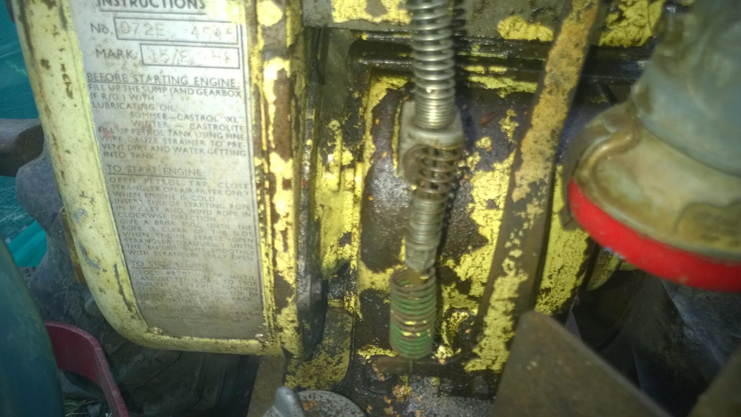

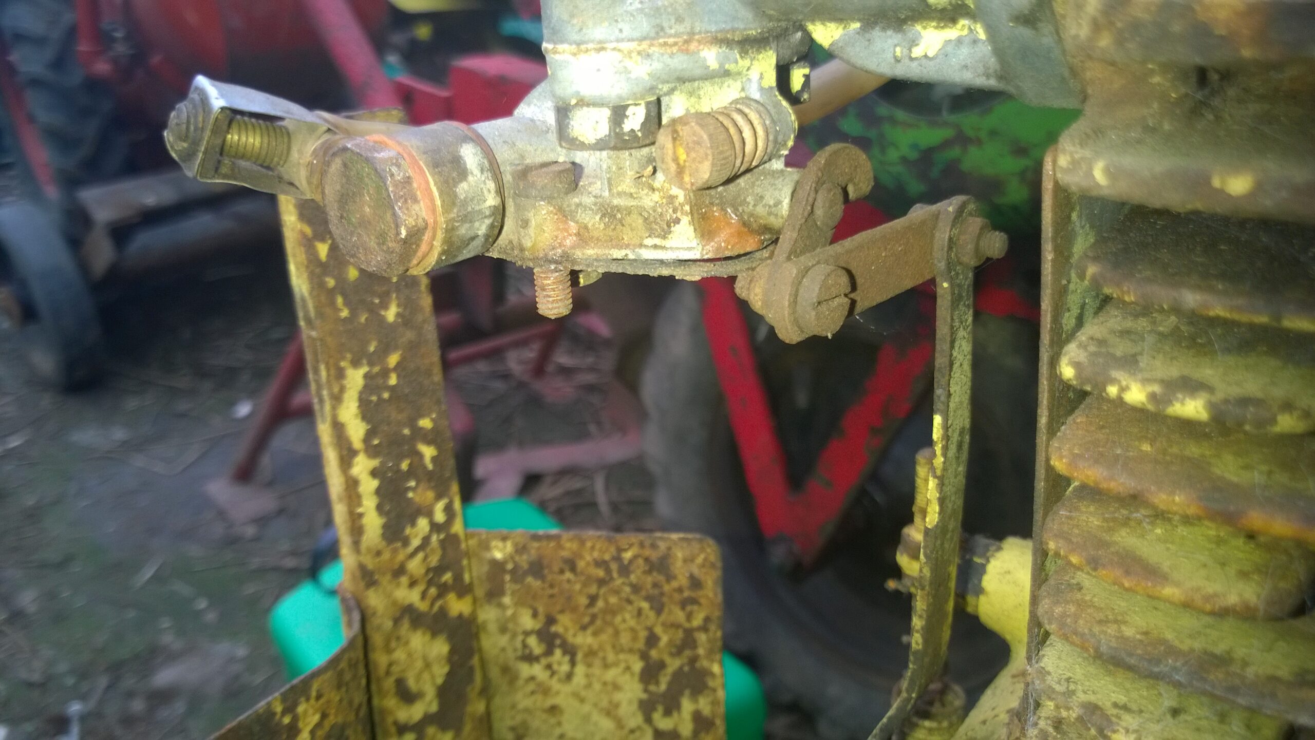

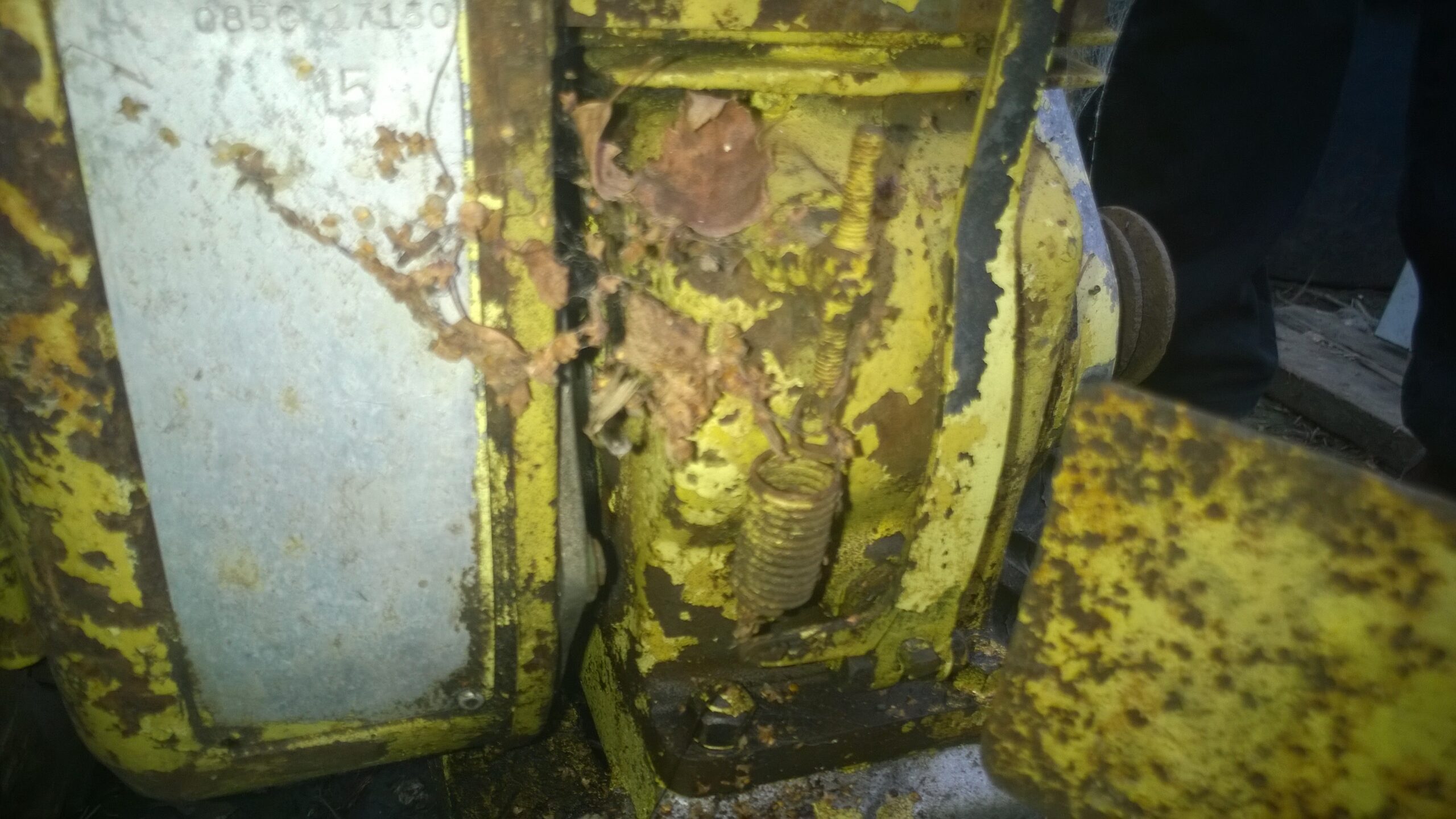

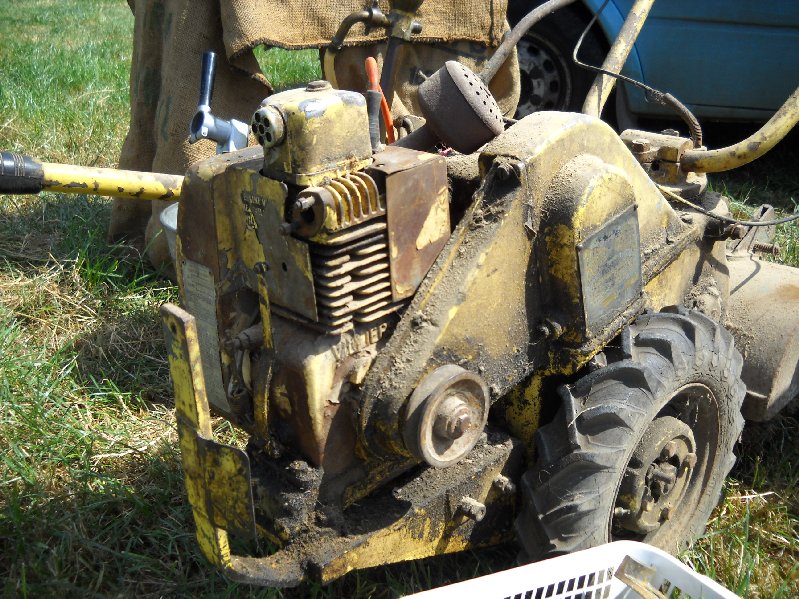

    My Autogardener has a throttle, but my Autoculto Junior hasn’t. I’v posted some pictures. 1st one is Russ Berry using his Autogardener, no throttle fitted, 2nd one is my Autogardener showing that the throttle pulls the governor rod, 3rd one is my Junior, with the carb removed, this shows the governor rod….

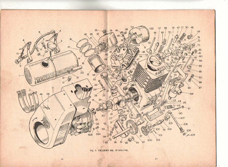

    Illustration below is taken from operators manual / parts list for the MK 15 and shows the throttle to governor linkage, items 112 to 120.

    hi ricky, welcome to the club. not sure if these will help but picture 3 is with the throttle cable connected to the governer lever, the 2nd is the governer and spring with no throttle cable and the first is the governer lever connected to the carb body (bottom part of the carb removed. the thrid picture is on a gardener, and the second is on the junior.hope this helps
