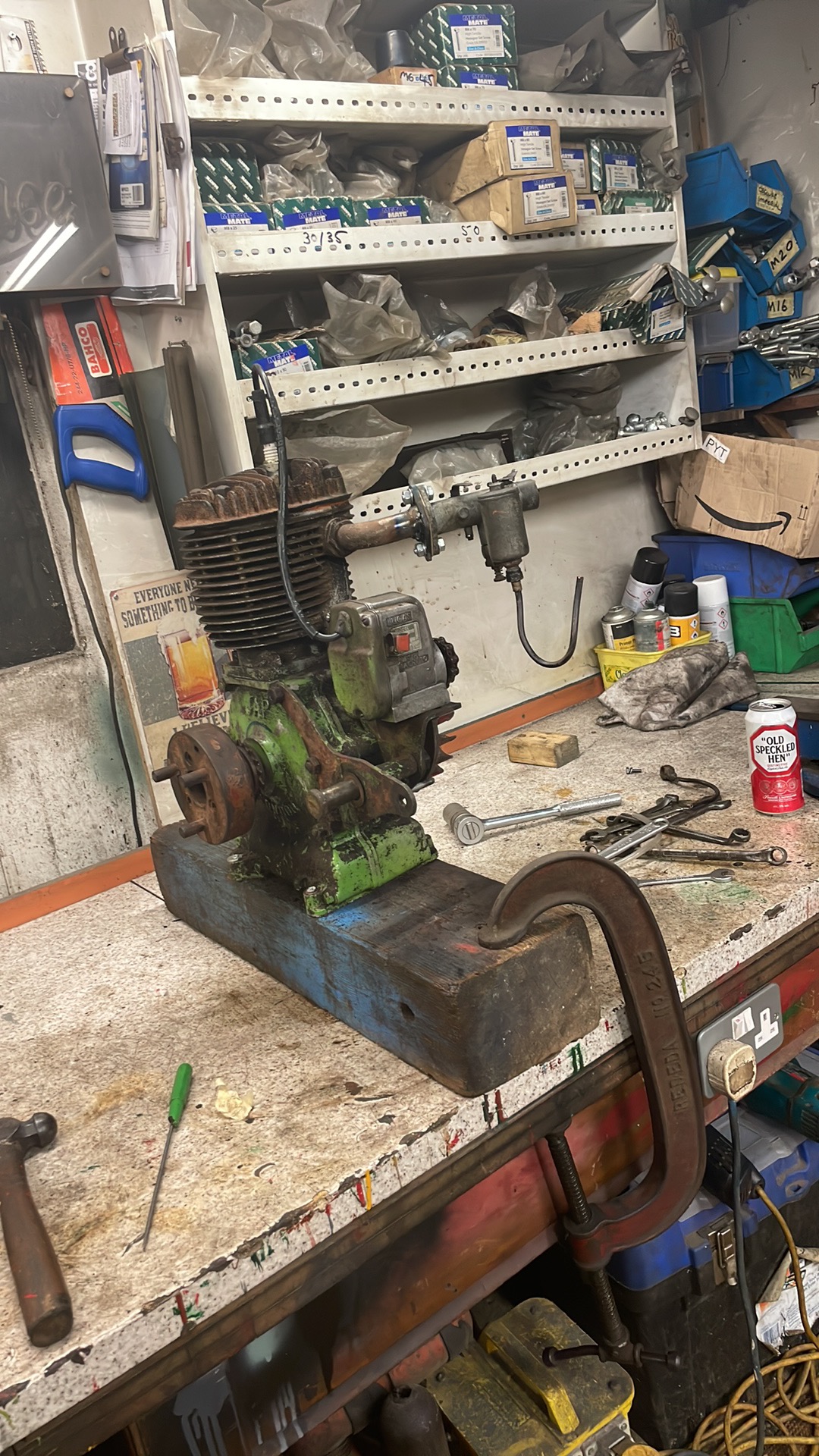

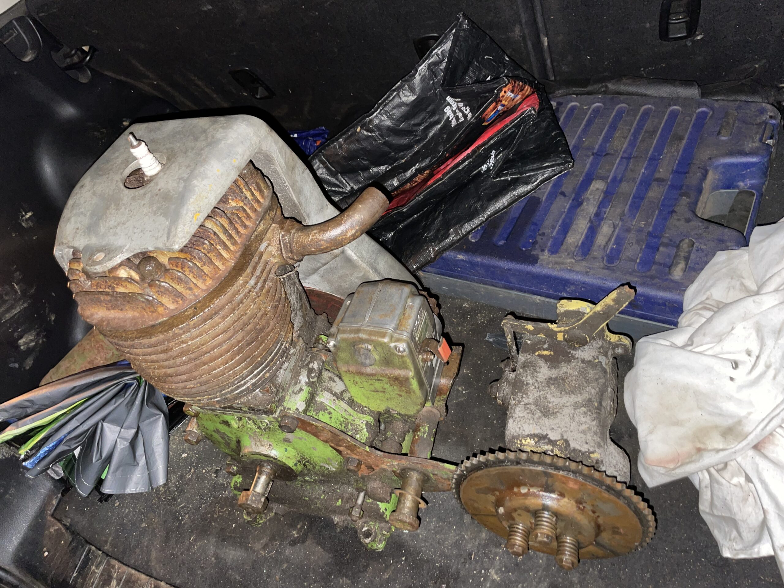

    Can anyone help me to identify what model of jap this is. I understand that it’s a 350cc side valve single but that’s all I know. I am looking for a carb for this engine so I need a little bit more info on the engine so I know what I’m looking for. If anyone has any parts aswell this would be a massive help.

    That’s answered the OP’s original question but as one of his images appears to show an Albion gearbox and clutch ; so what’s it from, not an Atco cylinder mower !

    Well just come back from looking in all my Atco files to include non lawn mower. Although that Albion gearbox is present as its not attached in anyway, does it actually belong?
    The Atco tractor’s engine was a 350 cc but that was different to this engine, as it was a two stroke.
    I have checked all the Marine engine impellors they made and its not one of them either. Where the magneto is it is the correct position for a lawn mower engine, so all I can say is back to you.
    Regards
    Andrew
    #38486
    Let’s hope the poster tells us what plan he has , he appears to have removed the clutch spur in one of the pics. The remaining paint on the gearbox would maybe suggest AutoCulto or Trusty Earthquake , the Jap engine would certainly make an interesting and unusual conversion.

    No the Albion gearbox had nothing to do with the engine. I’m building a bike out of it and was going to use that Albion but used a triumph slick shift in the end. Thankyou very much for the response and sorry for me being so late in replying. I still would like to know the model jap this is if possible.
