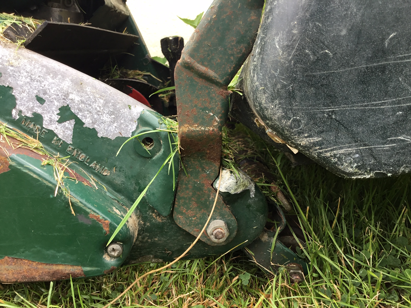

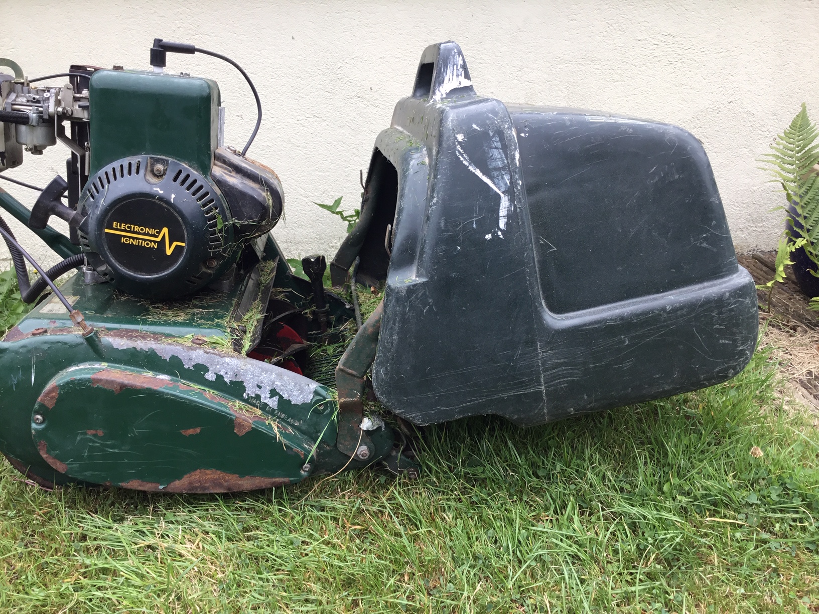

My question is actually about the angle of the grass collector box.
Its tips up at a ridiculous angle, such that the box is only 1/4 full before the clippings start to drop back into the cutting cylinder.
I have attached a couple of photos to show the angle and also the bolt that I would expect to be able to undo to adjust the angle of the bar that supports the grass box.
However, you cannot adjust this as (see pic) there is a stop (corroded white blob) preventing the bar being adjusted in this way.
Am I missing something? Do I have the wrong collector box?
I know it needs to tip slightly upwards to avoid flattening the grass but not at this angle.
The box needs emptying every 1 minute.

wristpinParticipantFrom the look of your images The problem could be that you are trying to cut off too much at a time. I think that you should see an improvement if you get the grass down to the stage where you are only cutting off half inch at a time. Also I think that you will find that the deflector or throw plate behind the cutting cylinder has slots where itβs secured to the engine platform. Try moving it so that where the part is in line with the cylinder centre shaft the gap is reduced.
