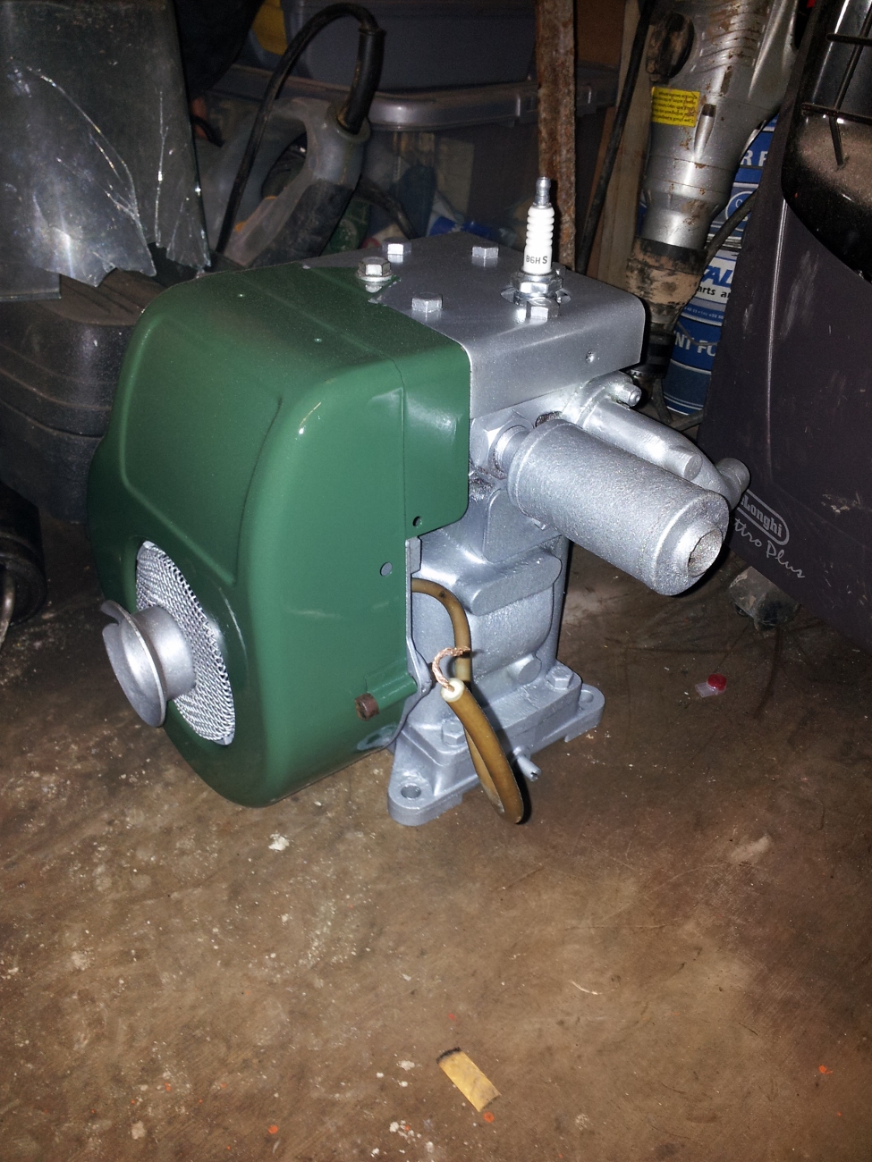

    Paint has arrived and its been matched from a sample donated by Angus (Wristpin ) many thanks angus for that. paint code will follow shortly for all those going to restore a atco or two for next years shows. Also have got some more engine paint and having steam cleaned well the Mk 7 engine it now supports a fresh coat of the paint which I use where I can just to give the engine that NEW LOOK.

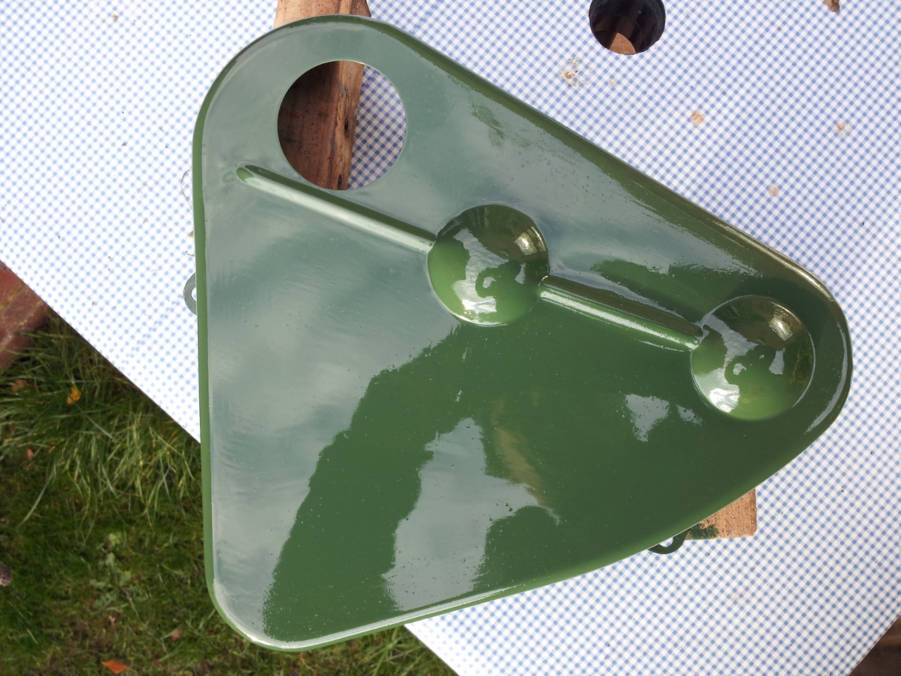

    Quick update on the paint. Have now painted the engine cowl,petrol tank and engine base plate. and the match is spot on. Must admit under flouresent light and trying to take flash photos,a strange phenonomen happens, the green looks pink on the photos. well I cannot post those so when the first opportunity arises i.e. sunshine, will take it ouside and take some in natural light.

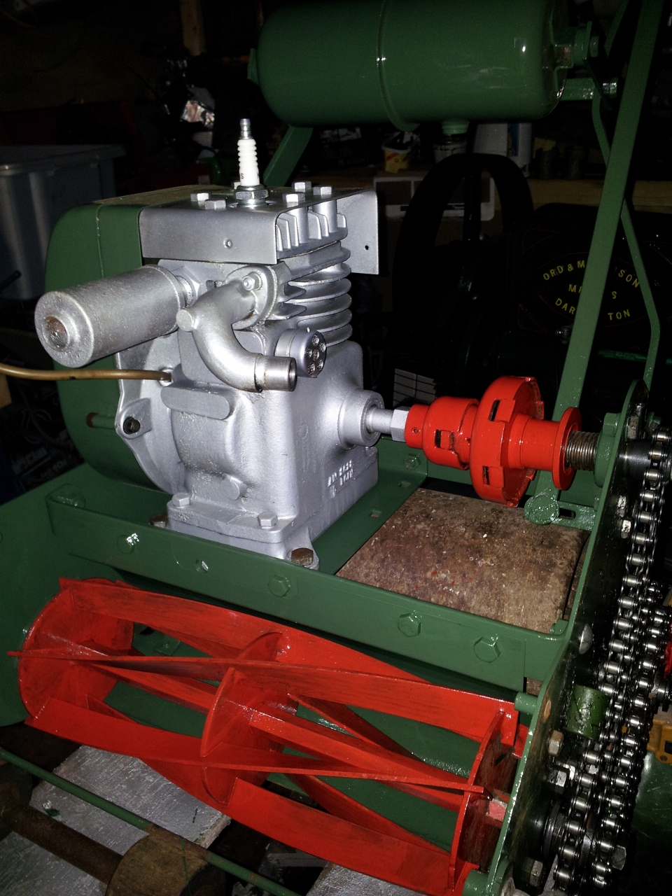

    engine now well on its way to being finished. have discovered that if I keep a good distance from the item to be photographed the item is green rather than pink. now if you have not been following this thread you will think I am cracking up or have been drinking heavily with this last statement,but to put the record straight have had issues with camera in flouresent light.

    Yes owen,green is the way to go on these little mowers. this paint which I use is very versatile because no matter what the weather,one way or another you can get it on whether you spray or brush. brushing is my preferred method as you can get more on in a shorter time span. managed to get this chaincase covered today. the shine is so intense you can see me in it taking the photo.

    busy day ,started at 3.30 am. lots of tasks completed and have managed to make some more progress on this project. cyclinder needs another coat of paint,just in case you are thinking I have missed it.
