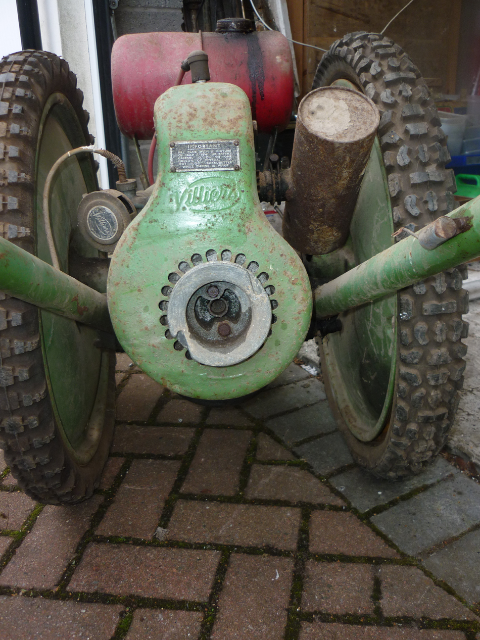

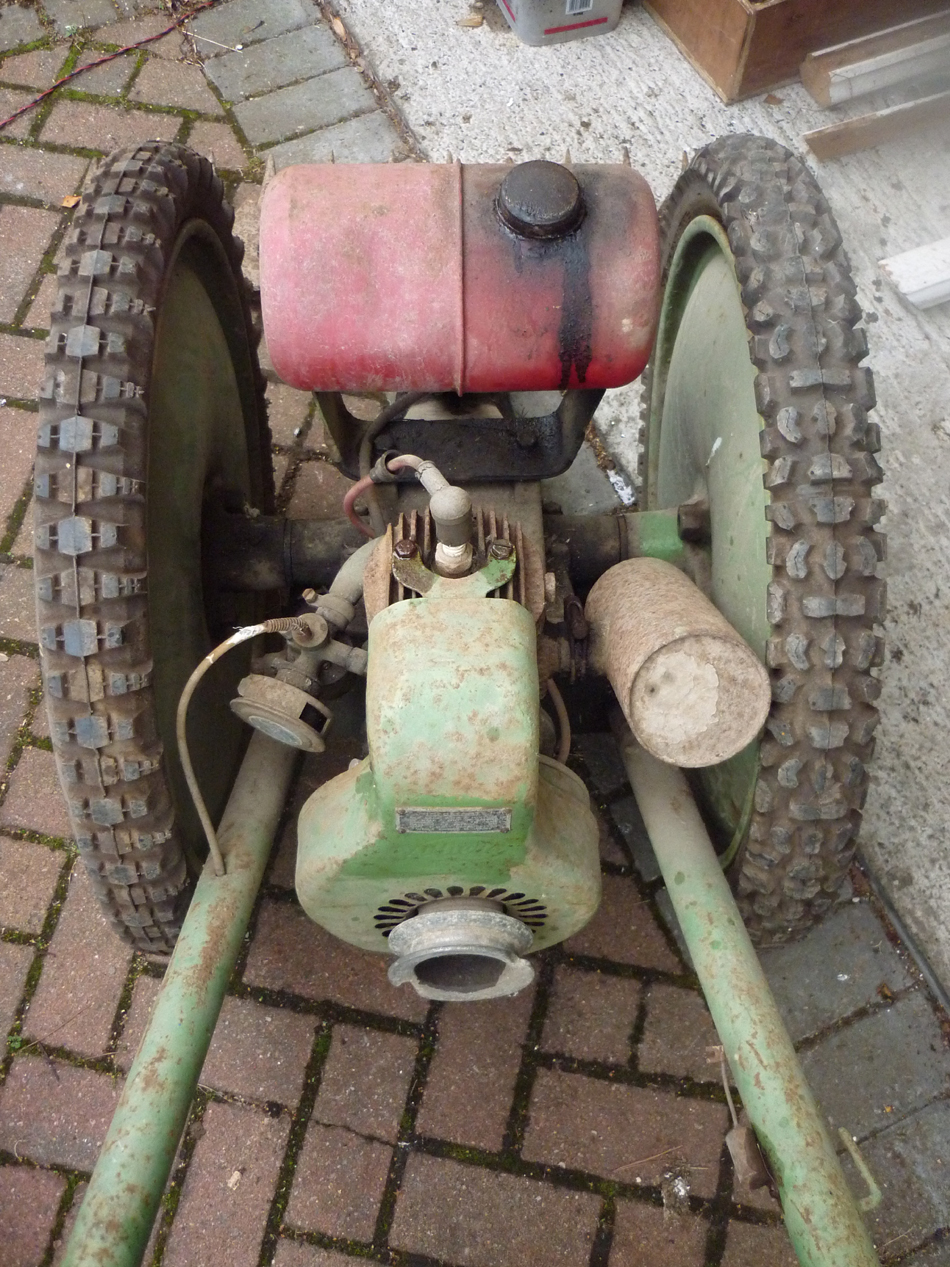

    Following on from my Howard post, I am pleased to have acquired this Allen Scythe “T” or “TS”. On initial inspection it is complete and original and all moving parts are not sized, which is a relief. This “Allen” would be very useful at the allotment especially if I can get some of the tools that could be fitted to the scythe?
    During inspection I was informed that it did not generate a spark and that it may require a service, which I planned to do anyway.

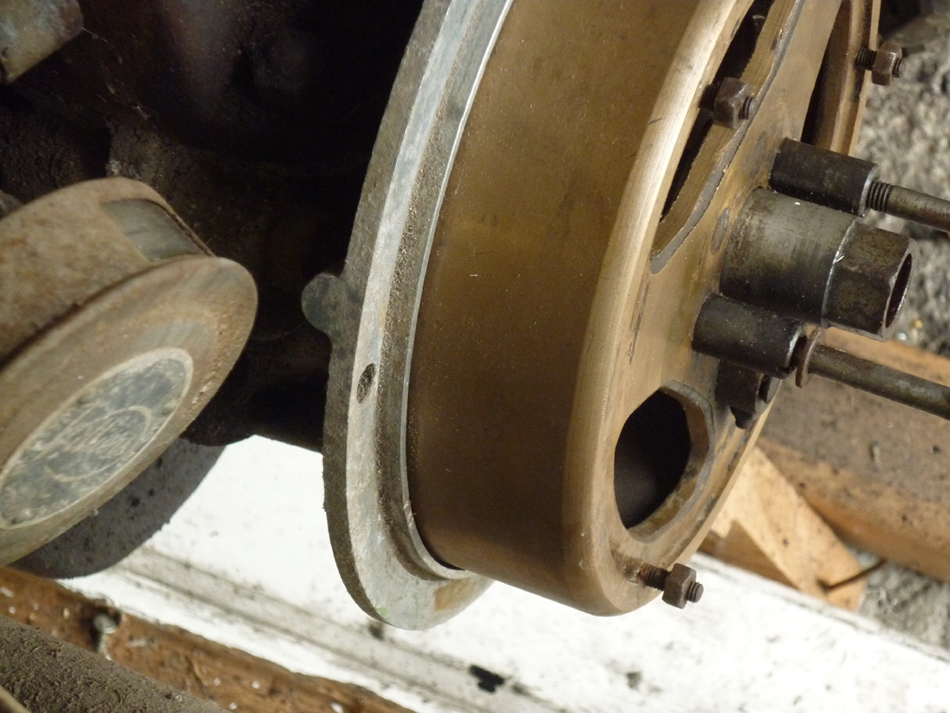

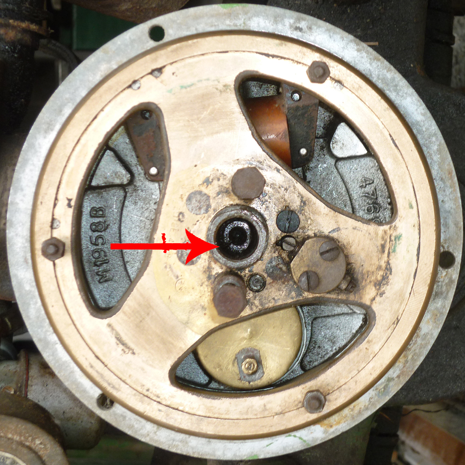

    Much has been said about the timing marks on Villiers engines and whilst I believe this to be a MK25C 2 stroke fitted on my “Allen” I cannot see any timing marks at all (the red marks are mine) apart from the mark on the end of the crank shaft.
    I noted that the beginning of the magnet in relation to the coil and made a mark on the flywheel next to the “tab” located on the base plate, before removing, which fortunately came off with relatively little trouble.

    Until I get a new plug I am still trying to get the correct timing alignment and considering that the only mark I can see is on the crank shaft, I set the timing as to what it was before I removed the fly wheel but noted that the spark was generated in the middle of the magnet and the points opened at that same time driven by the cam on the flywheel.
    This corresponds to TDC so the question now is, if I keep the fly wheel in position and rotate the crank shaft back until the crank shaft line, point to the tab on the back plate, would this then be 3/16 BTDC or in other words, the correct timing position?
    As of yet I haven’t taken the head off to measure 3/16 as I want to get the plug first and make sure that it is sparking within the cylinder before I move on to anything else, one step at a time!

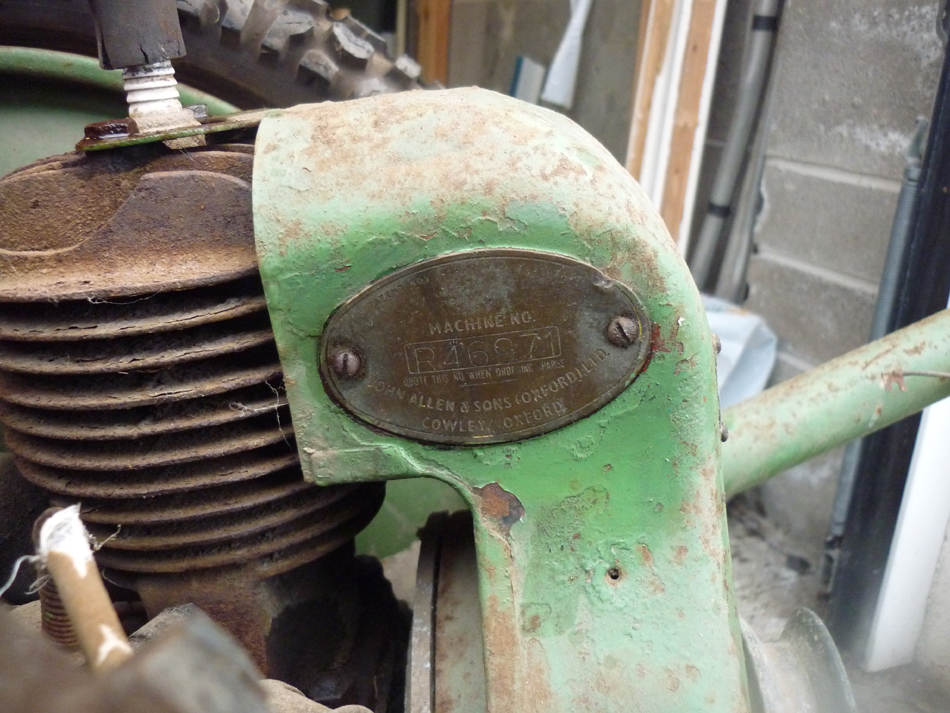

    So, hopefully some of the members will be able to confirm the engine type, Villiers MK25C or something else, a T or TS and when was the likely manufactured date?

    The mark (line) on the end of the crankshaft on the above photo tells you when the engine is at TDC (Top Dead Centre).If you turn the crank so that the mark is at the 12 o clock position the engine will be at TDC.
    Set the points to open at 5/32″ BTDC.Hope this helps.
    #22282
    Thank you Stuart, your information was helpful indeed. It seems that 5/32″ BTDC corresponds to the tab on the back plate that isn’t marked so at least I will now be able to make the marks.
    Rigging up a temporary petrol tank, as the one that was installed on the machine had some sort of turpentine/tar substance within and is currently unusable, I was able to confirm that the timing was correct as the engine ran for a few seconds until the fuel was exhausted.
    I am hoping that I will be able to dissolve whatever is in the tank and reuse it but time will tell, I may be in need of a new fuel tank at some point if anyone has a spare?

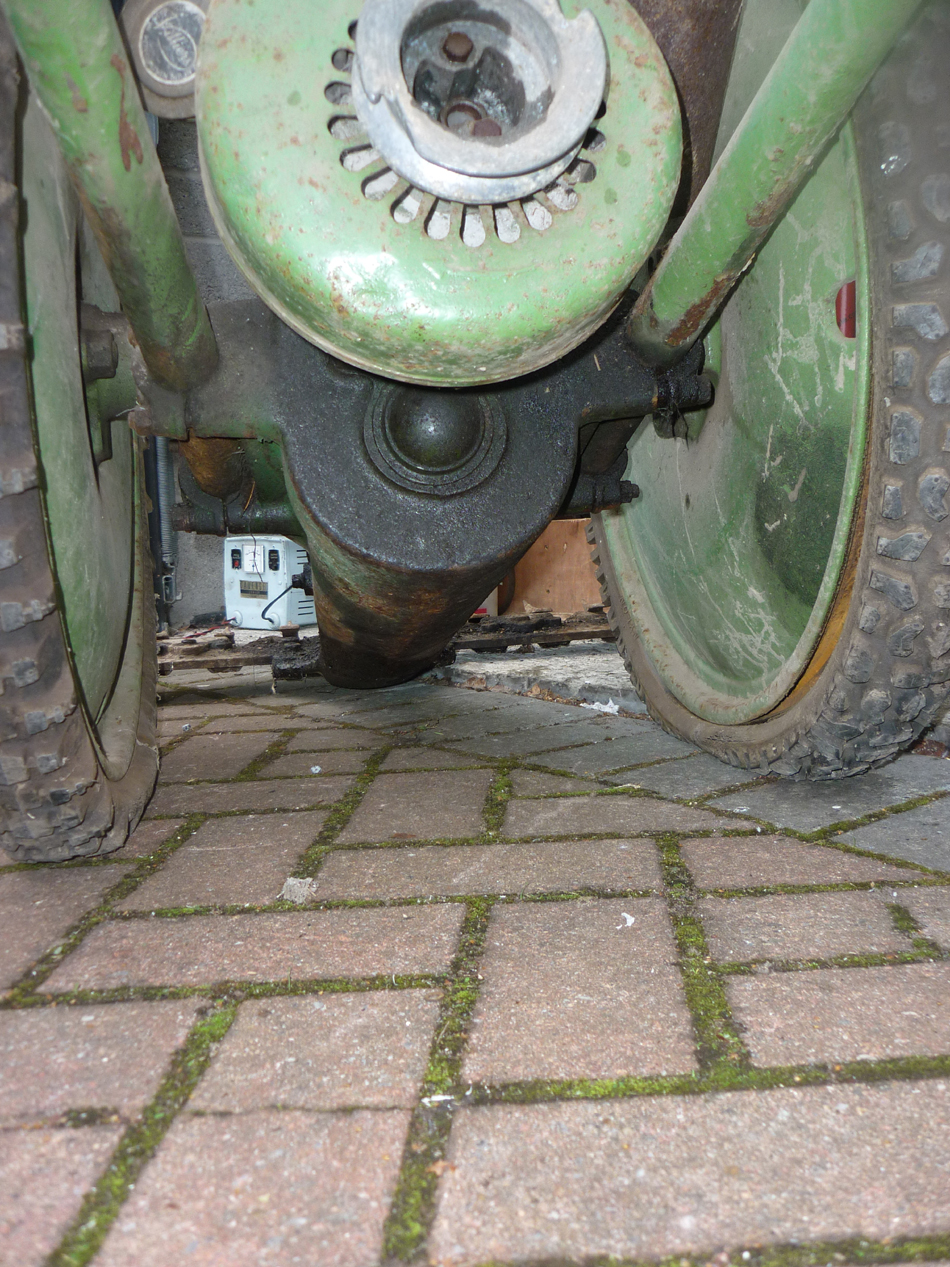

    The next question for the members is, is there meant to be a fair amount of play in the wheels? The play that I have is similar to the wheel nuts not having been tightened up enough on the axial allowing the wheels to wobble about.
    This doesn’t seem correct to me but I am sure someone will advise further?
    Still, the dating question remains, if someone is able to help me with that I would be grateful.
    John
    #22289
    Regarding dating, have you tried contacting MERL at Reading University, I believe they have the Allen Scythe records
