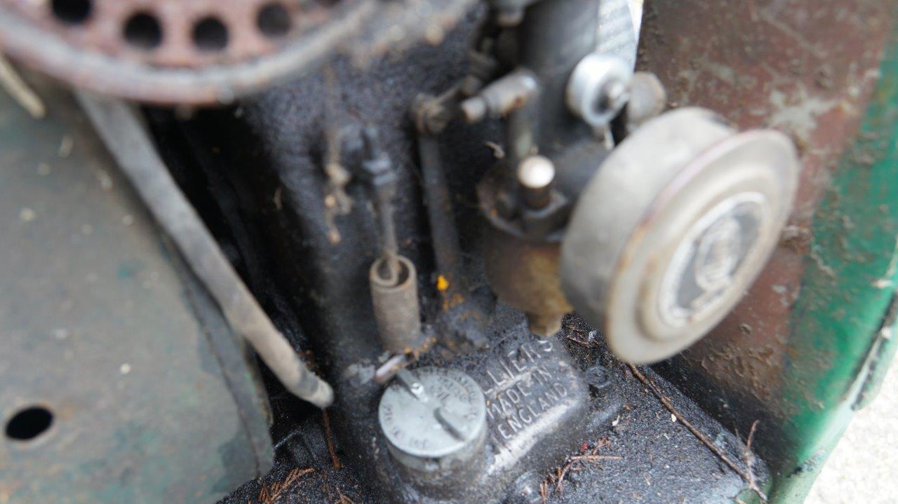

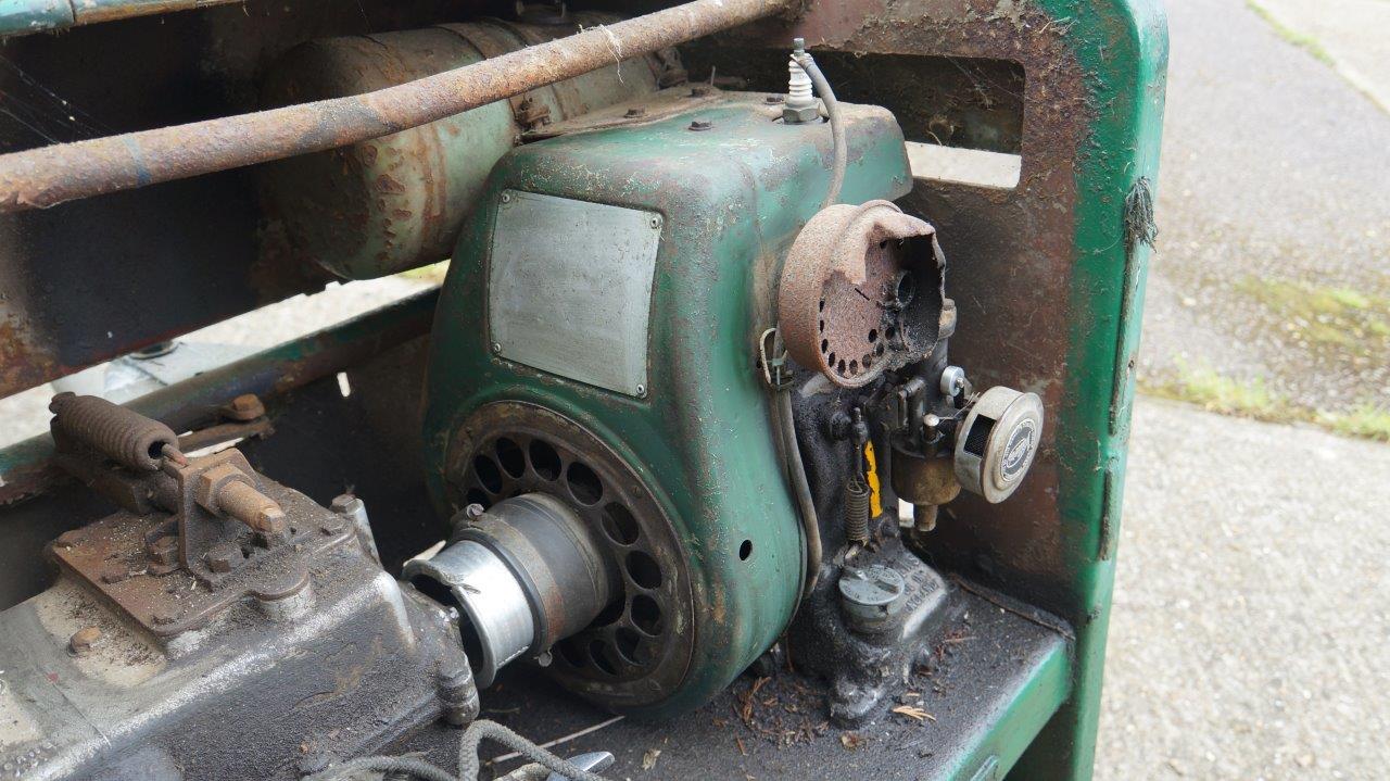

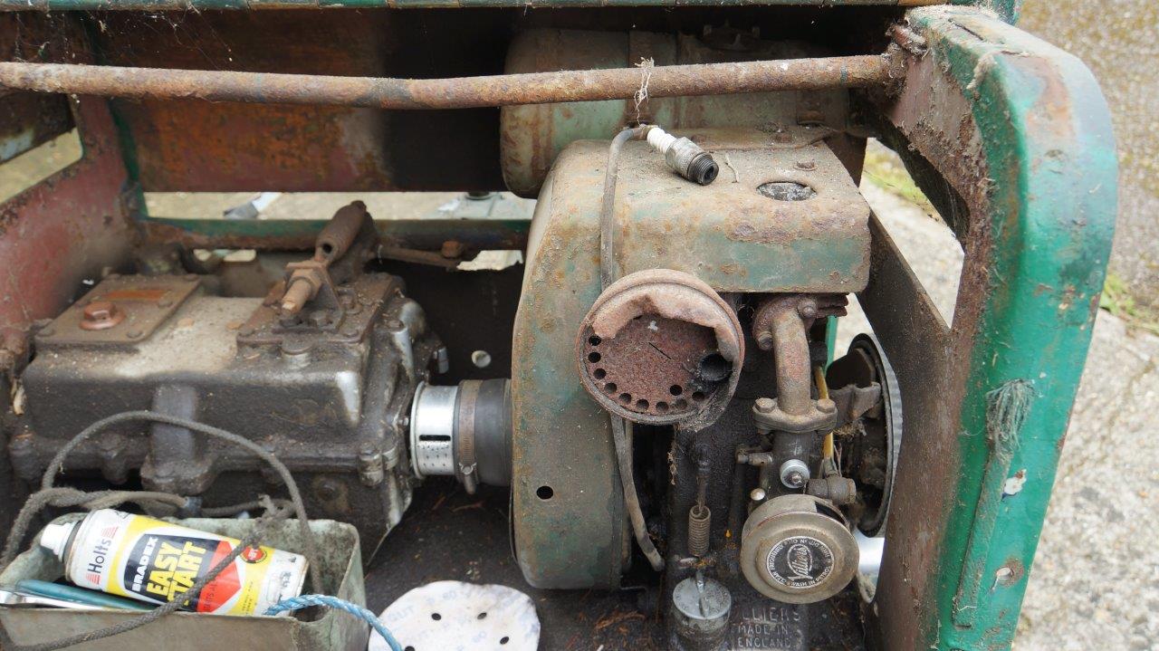

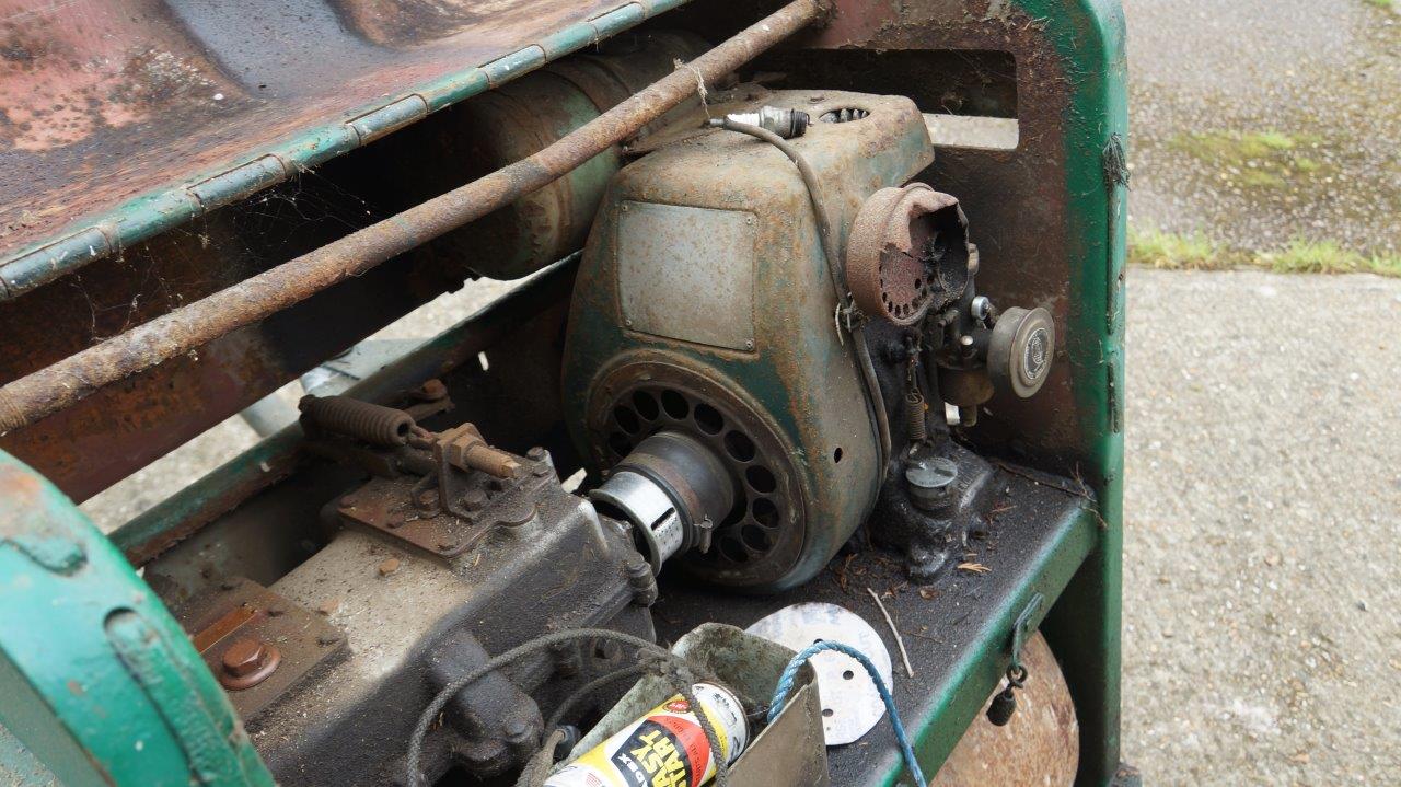

Can anyone recognise this roller and/or the engine attached please? This was left by the previous owner I and have been trying to start it to no avail. I was advised that it did work.
It has petrol, a cut off to the air filter to allow you to stop it, a single spark plug and a hand crank that requires you to wind rope around 4 turns and pull hard. It splutters and cough but without signs yet that it is firing.
It’d be good to know what the models are so I can try and source some manual type documents.

charlieKeymasterEngine looks like a Villiers Mk25. If the air cut off you refer to are the rectangular holes in the air filter that can be closed, that is the choke. Restricting the air flow increases fuel to air ratio. If you close or partly close the choke you may find it will run, then open the choke as engine warms up.

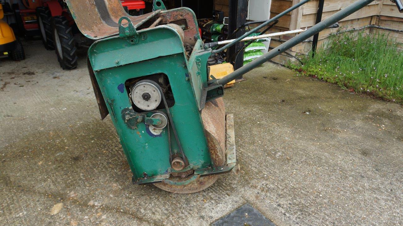

Roller could be a Stothert& Pitt vibroll.May 29, 2017 at 4:12 pm #25396
alanParticipantI think Charlie may be right that it’s a Stothert & Pitt roller, they did many rollers powered by Villiers Mk12, Mk25 and Mk40 engines. They did make a vibrating self propelled roller and also a 28 inch one too both with Mk25 engines certainly in the early 1960’s onwards. Also, Greens did a Unirol pedestrian roller with a Villiers Mk25 engine.

ParticipantJust found this about the roller i have the same, i see there is a can of easy – start on the roller. to help start a engine be it my tractor or car or small engine i use GT85, less chance of blowing the head off,
January 19, 2021 at 5:40 pm #36455
wristpinParticipantEasy-start – the ruin of many an engine !!
