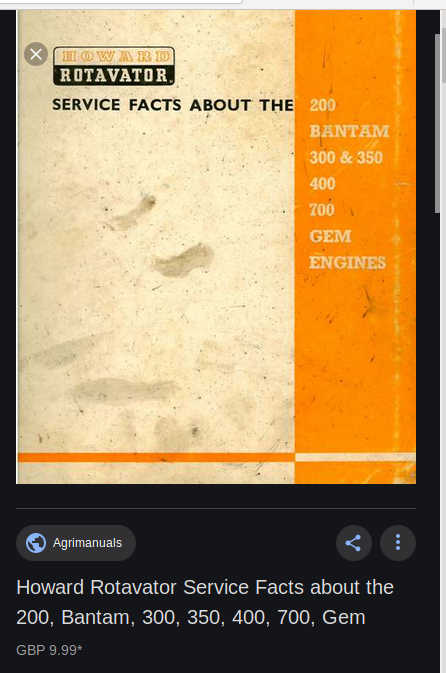

    the Service Facts book 1969 lists 3 different carbs on the inline twin engines, you have the ‘latest and greatest’ so i would not be in a hurry to find a different one… however if you happen to have one of the others close handy then it might be worth a try. cheers Rod.
