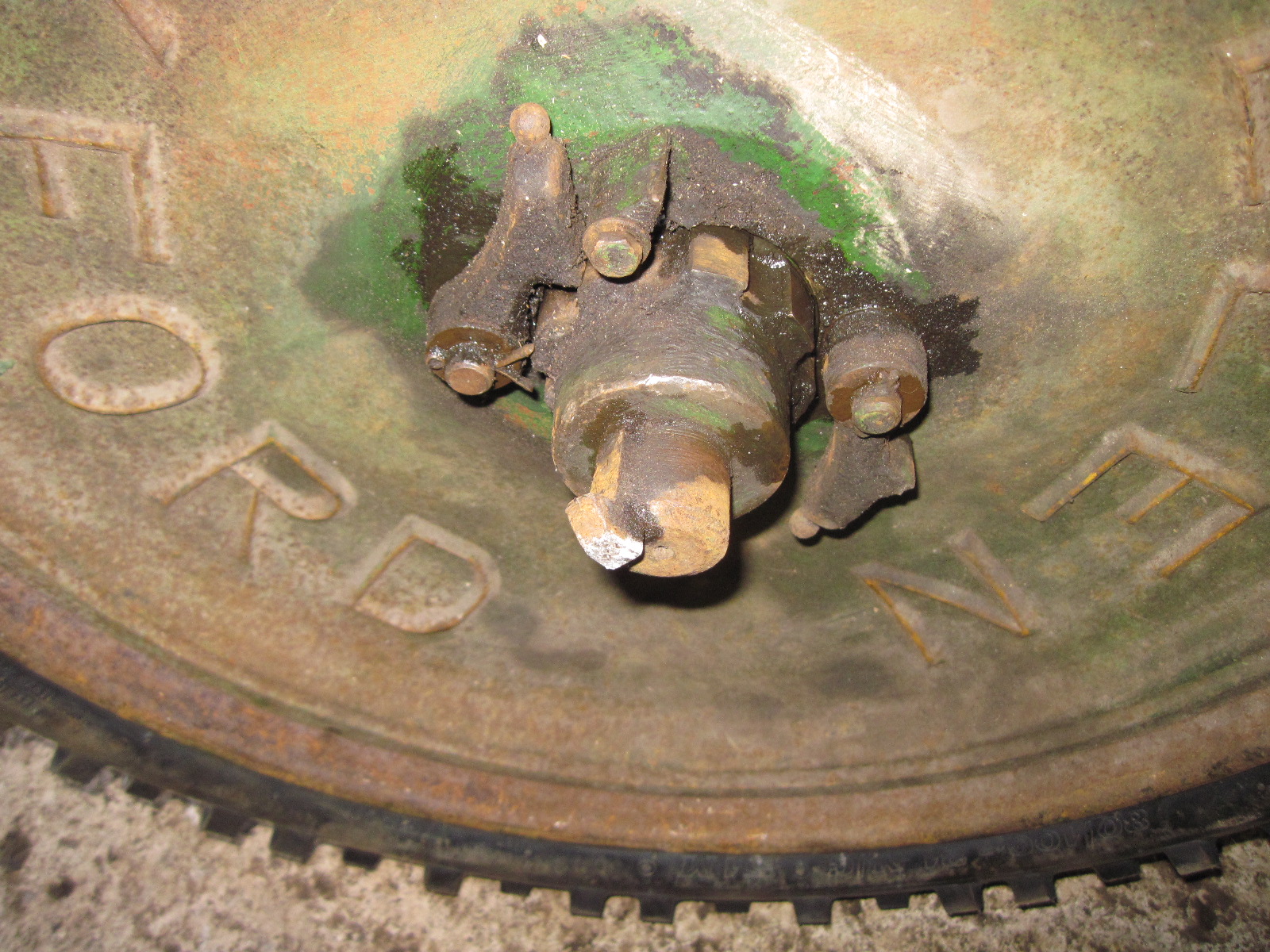

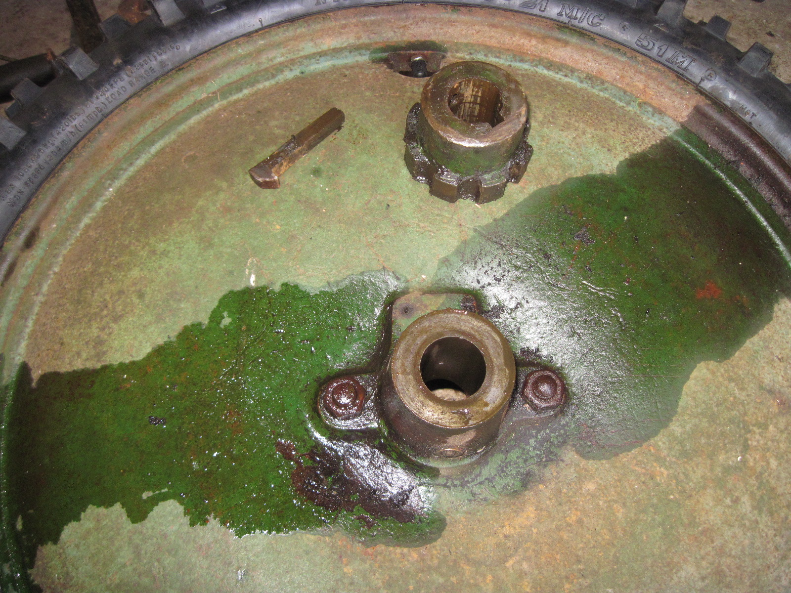

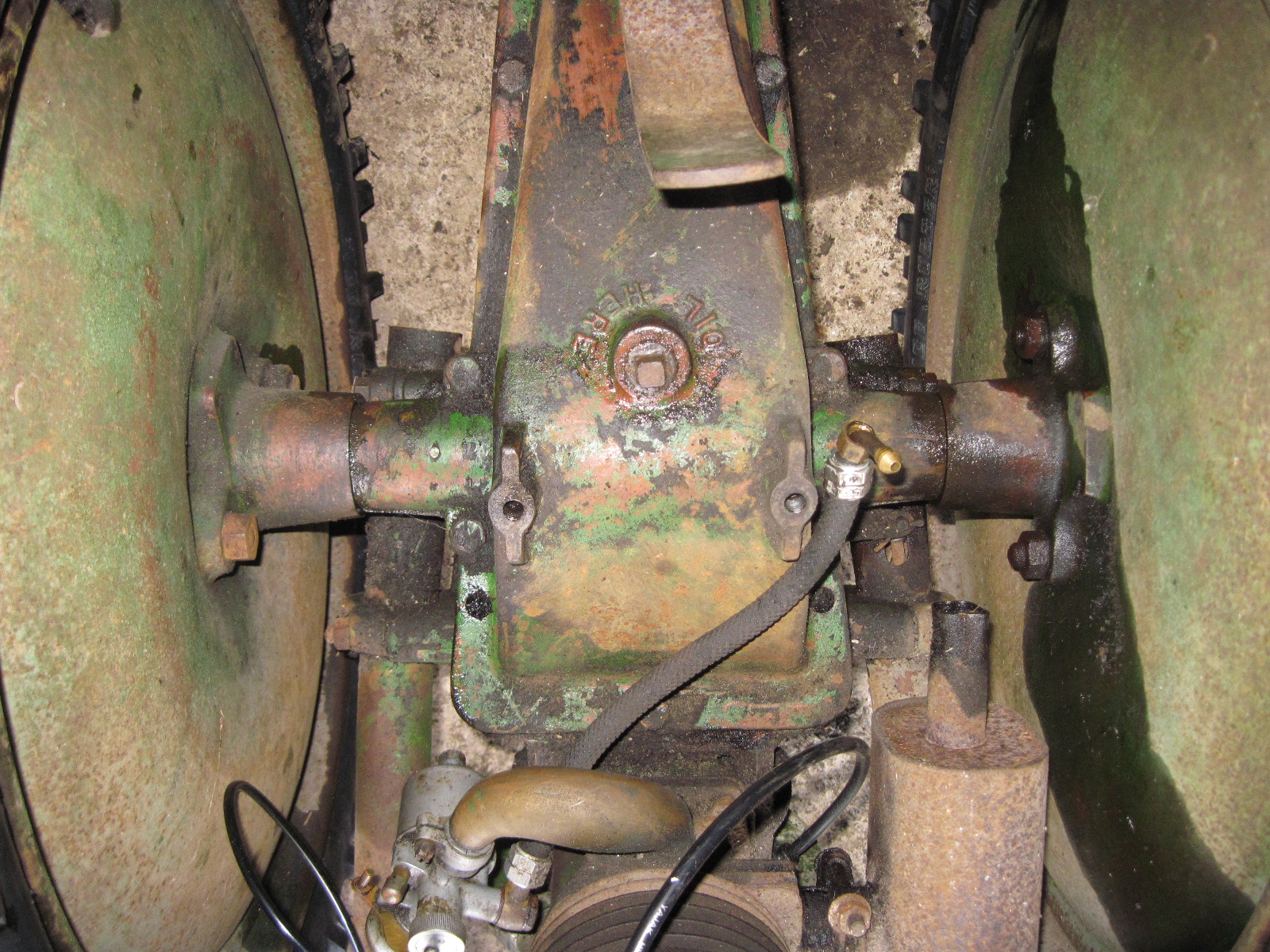

    Ok here are a couple of photos,- I might have got my lefts and rights mixed up….but the views from the handles, the rear, show the tyre on the wheel on the right hitting the handle, but not for the wheel on the left. And that wheel on the right – the ‘not OK’ one – is the one on the right in the photo ‘from above’ and you can see a lot of oil leaked out of the join between the wheel casing and the main casing when I laid the Allen Scythe on its side to put the left hand tyre on. That right hand wheel has a smallest bit of wobble, which I don’t know if it is significant. But it is definitely closer to the handles by about an inch. Handles are not bent…..!
    If anyone can make suggestions I’d be grateful. But I suppose the bottom line is I need to get that wheel off.
    Thanks
    R

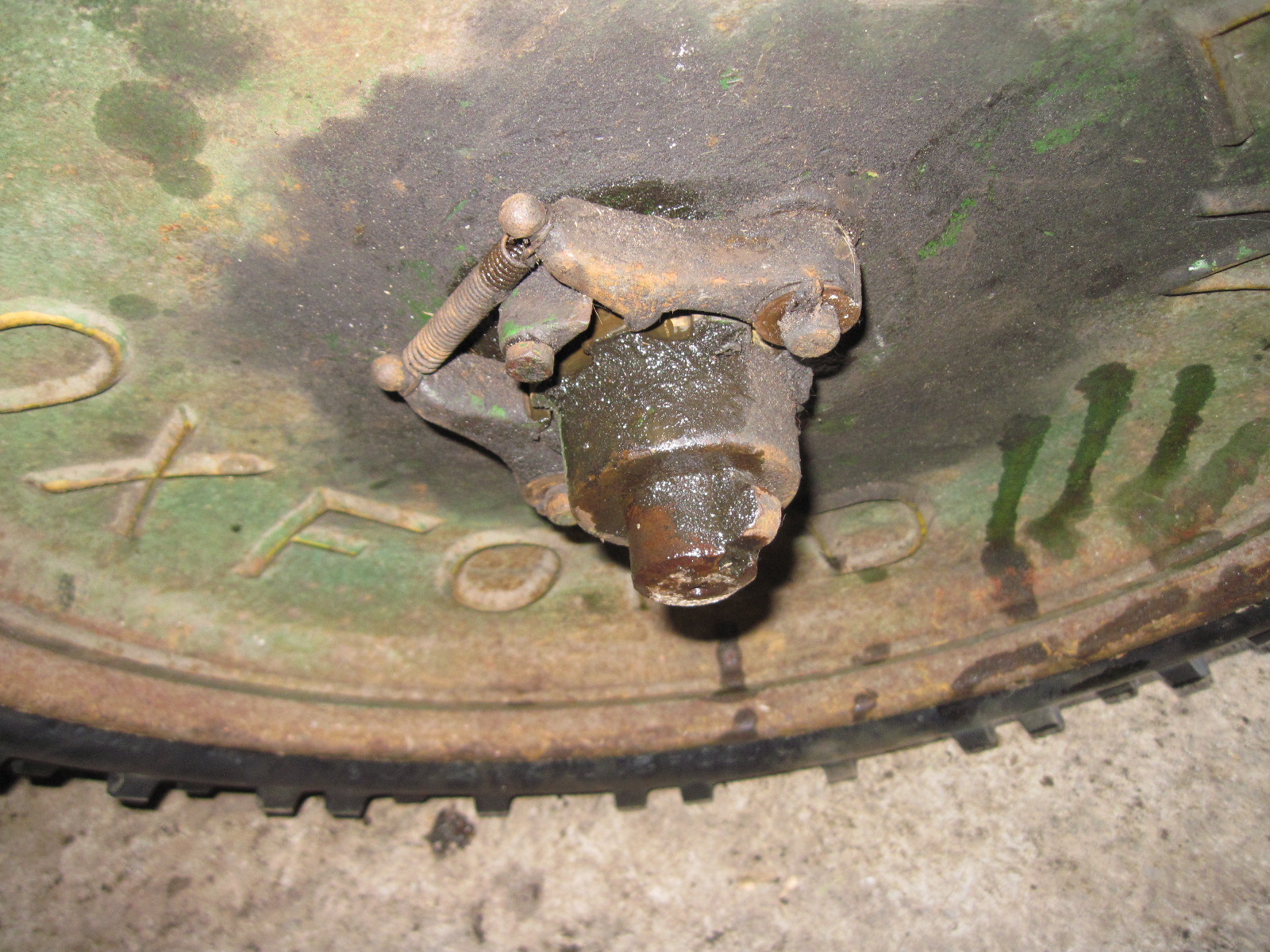

    A couple more photographs of the axle, wheel off. The key came out relatively easy – just a 1/2 hour of levering and persuading. Is it as simple as the lugs on the tyre are too big on the inside and hit the handle? No, can’t be, clearance even without them is minimal. I could put a spacer in behind the wheel….

    I have removed the other wheel and both stub axles look exactly the same – 15 cm of axle both sides projecting from the casing.
    I was just looking at the parts manual and I notice on plate 3 there is a part number and description for the long 3 foot axle (477) and collar (x4) (478) for the long 3 foot axle. But there is another thinner collar pictured (476) but there is no description for that number. Does a normal axle have collars? Is that what this is? Because if so, my axle doesn’t have none. Such spacers (or collars) would fix my problem. Any ideas anyone please?

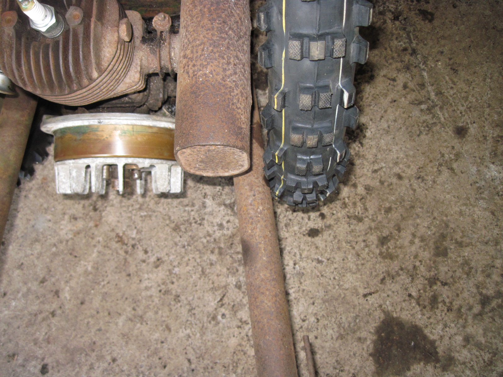

    I’ve had a look at my Allen scythe and there’s a large washer-like spacer on each axle. Even so the right wheel (from the operators position) is still really close to the handles. Photo attached.
    #31211
    Thanks Alan. That spacer looks brass, or is that a trick of the light? Strange that the right hand handle is closer to the wheel than the left – I would expect the whole thing to be symmetrical.
