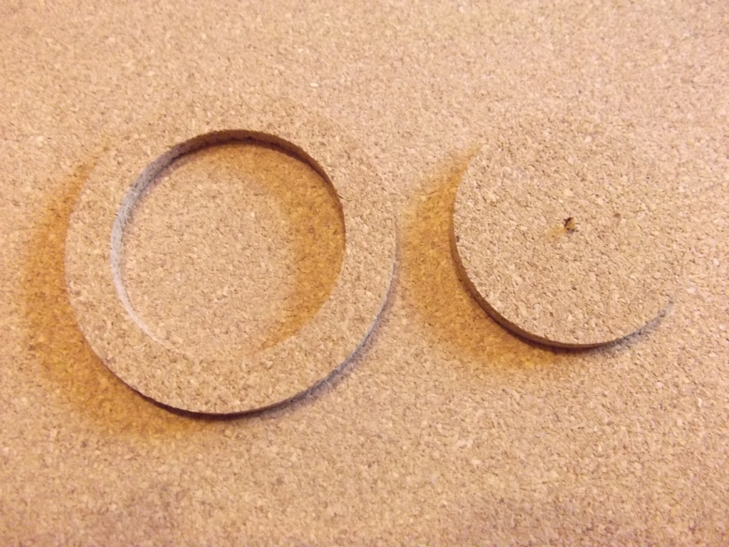

    #3113
    Hi.
    I have just removed the villiers engine from an allen scythe and the cork gearbox gasket/insert fell apart. Any idaes about a replacement for the cork piece
    Thanks Bob

    #3317
    are you confident enough to make a new cork one,as you can buy sheets of cork in different thicknesses. its not hard if you can make one from gaskit paper ,your in good stead to make one from cork. good luck.
    #3388
    They are not to hard to make, this is the one I have just made for mine.
