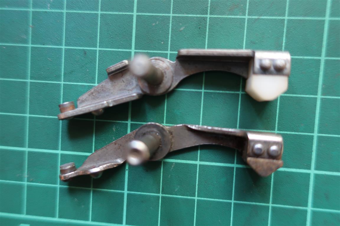

wristpinParticipantWhen it comes to Allen scythes I’m a bit out of my comfort zone but I do remember that back in the day there were two very similar sets of points that were fractionally different . The difference , if I remember correctly, was the profile / height of the nylon heal that ran on the cam. It may be totally irrelevant to your issue, but may be worth checking.

Edit
Just has a dig into a box of new old stock points and found these two with decidedly different heal profilesSeptember 13, 2020 at 4:29 pm #35384
