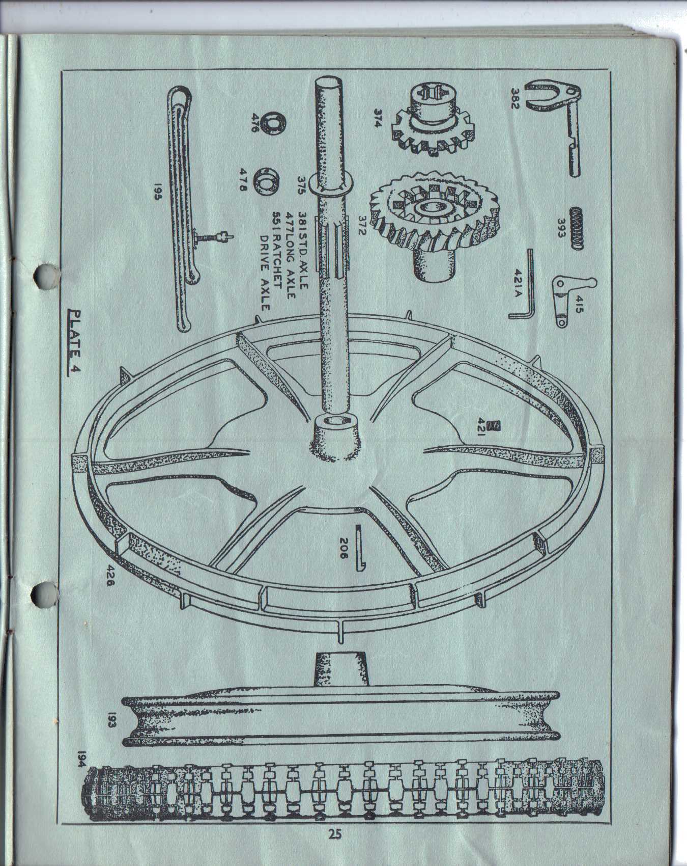

charlieKeymasterI am not familiar with the internal workings of Allen Scythe but I do have an instruction manual with parts list in my literature collection. Looking at the illustration on page 25 it would appear the clutch mechanism on the model T is inside the gearbox, see photo below.

ParticipantThanks for your reply. I have the manual too, but I find it difficult from the drawings provided to see exactly where the dog clutch is. I will attempt to take the top of the gearbox off, if this proves not too difficult. Does anyone know whether there should be a gasket between the top and bottom of the gearbox? What material should it be made from? Does anyone sell them? Or can I get one made for me? Does anyone have a CAD file for the gasket?

charlieKeymasterThe dog clutch consists of parts 372 and 374 operated by 382 which slides 374 in and out of mesh with 372.
October 8, 2021 at 4:48 pm #38037rowan-bradley
ParticipantYes, I get that, but can you please explain which bits are inside the gearbox and which outside? Presumably the operating rod must enter the gearbox via some kind of oil seal or gland? Part of my trouble is that my machine is fitted with the axle guards which means that I can’t see any of this.

charlieKeymasterYes you will need to remove the guards to see what you want.
